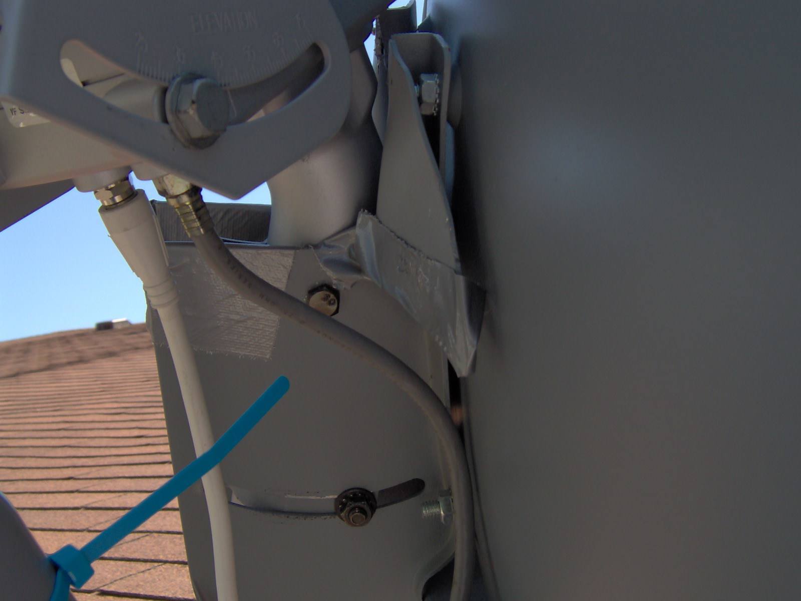

Now I have a motor that needs a use. Decided to motorize a DBS dish. Well, the first issue I rsan into is the dish itself. Since these are not normally use to have the mount run from the top, there is a piece across it. Also, with the 24" I used, the motor wouldn't fit correctly due to too much metal. Well, pull out the trusty hacksaw and cut it across to shorten it. Bent it back (see pictures) and put some ol duct tape to keep it from cutting myself, and was able to get the motor on it.

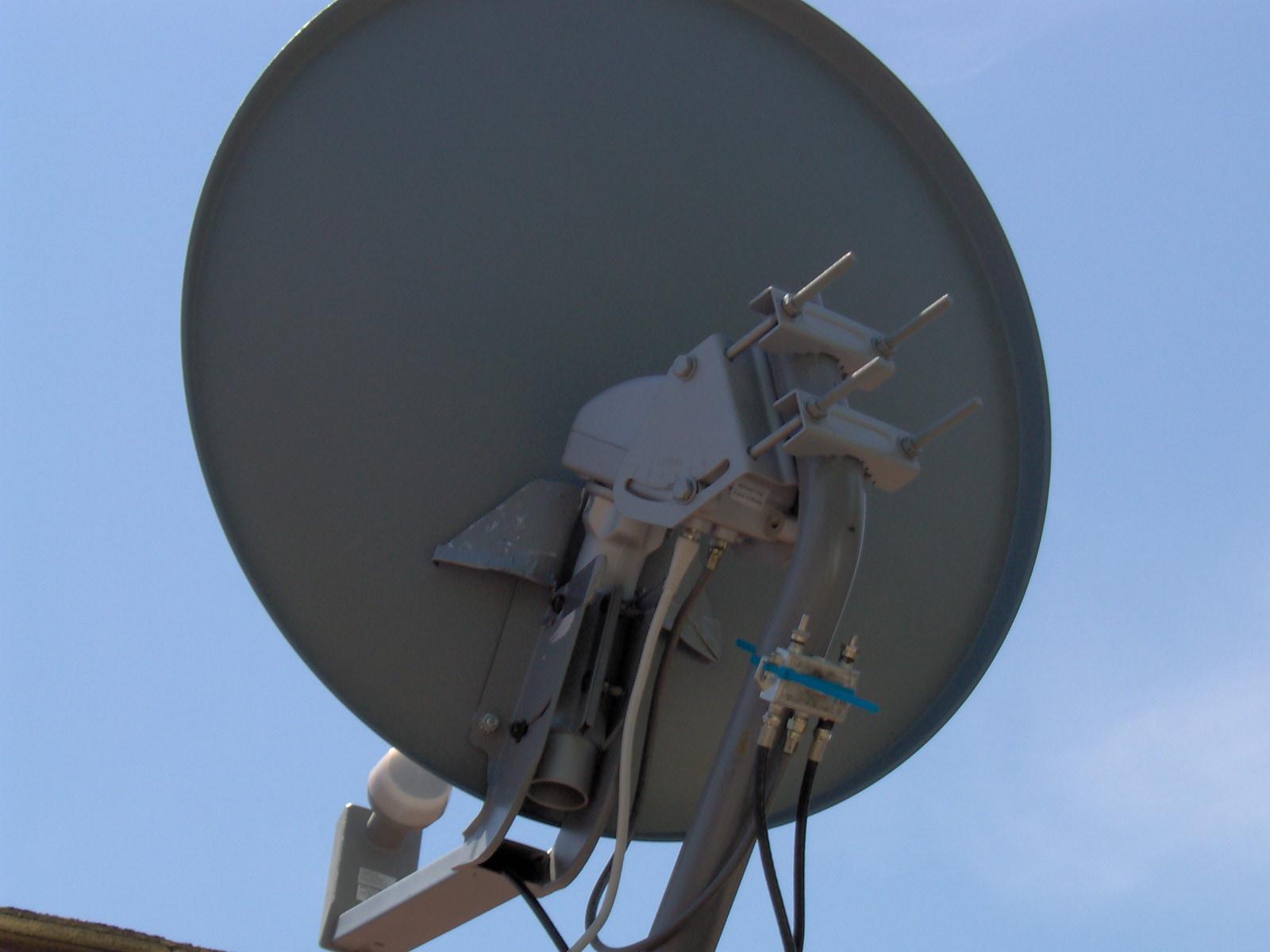

first pic is at 91

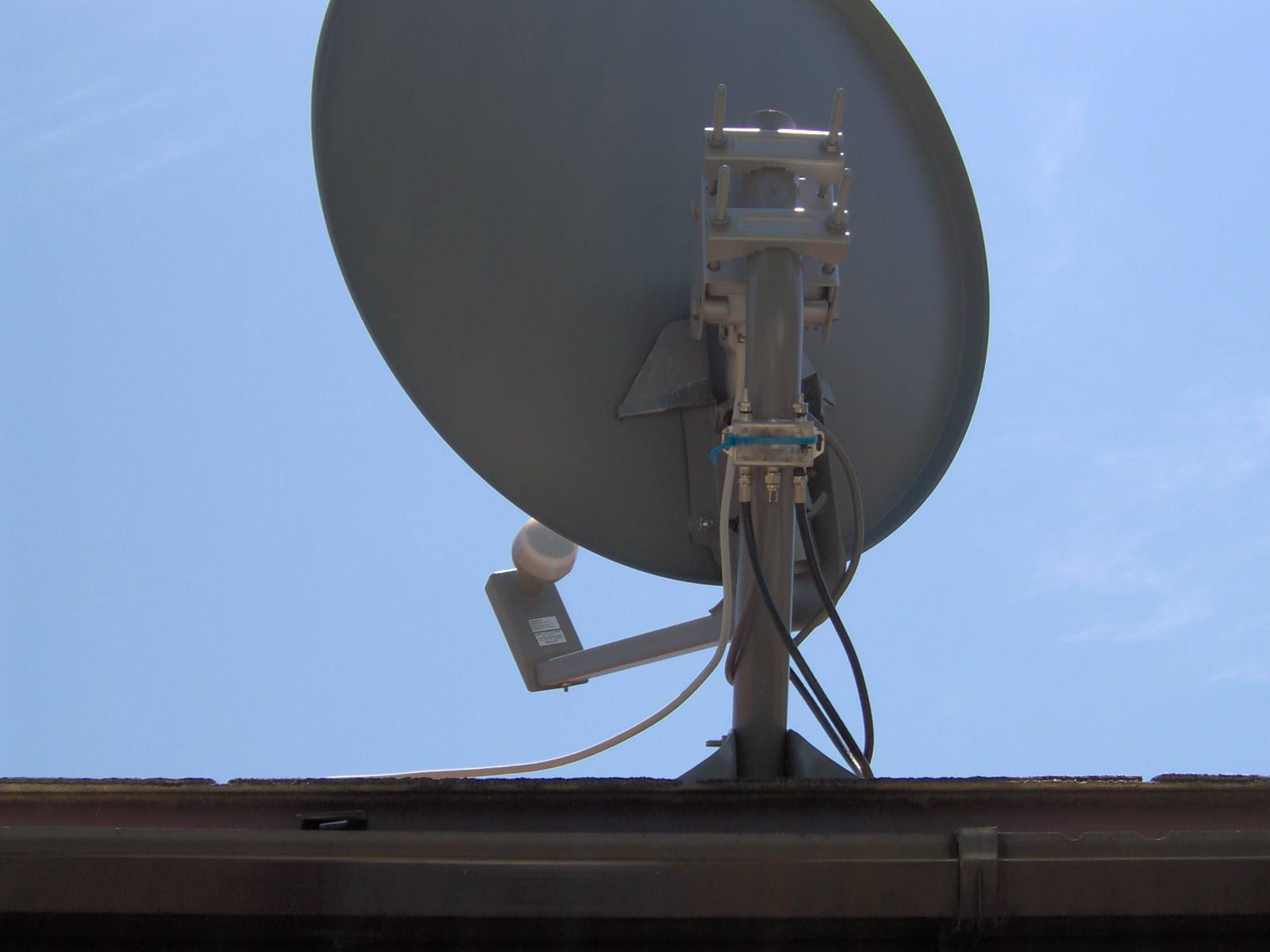

second is at 61.5

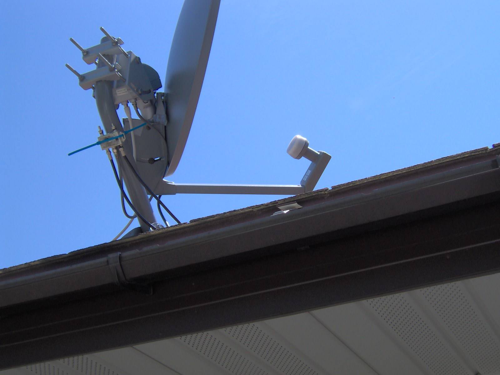

third is at 148
fourth is closeup of hacksaw job and duct tape :)
