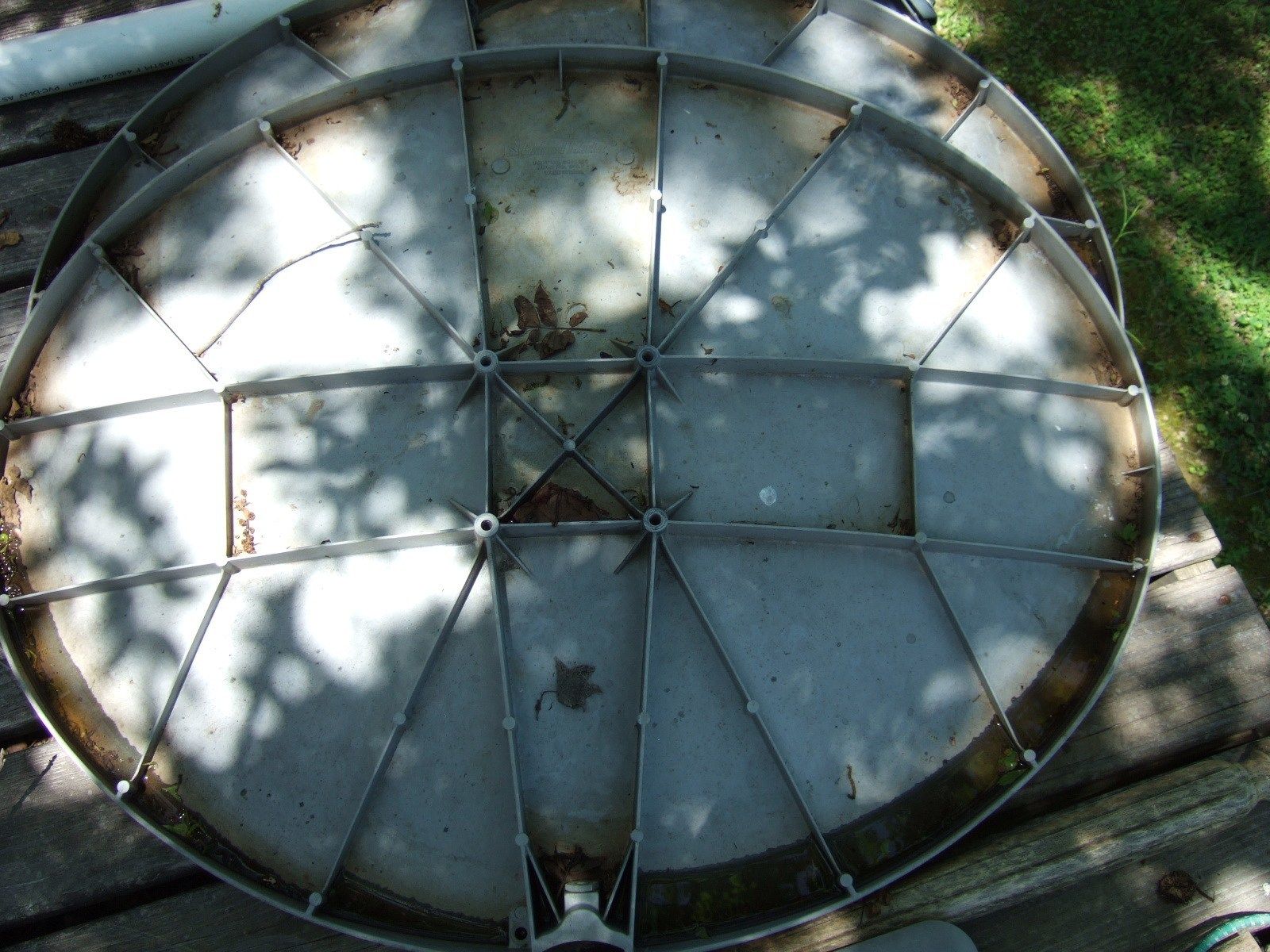

although i don't think its impossible to motorize (and i don't have one to try) . these dishes are newer design and have a lower mounting point than the older primestar/channelmaster dishes.
heres a photo of one of my primestars and you can use this link to look at the globecast/channelmaster dish. The globecast/channelmaster dish will show a lower mounting point for the skewable mount. lower mount & lower holes for the bolts (i don't even see bolt holes for the higher mount on this dish) so they might have been covered/filled.
the primestar/channelmaster dish mounting point is in the center of the dish.
with the globecast/channelmaster mount being lower i don't think it will track the arc correctly on a motor. but untill someone tries it, this is only a guess
