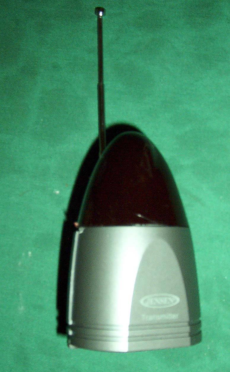

So I decided to take the Jensen units apart and see what was inside. On the receiver unit, I saw there were 3 "transmitting" LED's and a jumper wire was blocking one of them. But they looked promising! I moved the jumper wire so the 3rd LED was no longer blocked. On the transmitter, there was a Faraday cage on the circuit board and a wire screen over the light receiver. I removed the wire screen so it could see the remote better.

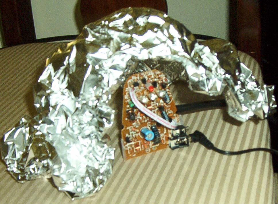

My Experiment.... I removed the antennas and left the wires to the antennas attached to the circuit boards. Then I ran a coax cable along the floor from my bedroom to the living room. I exposed the center conductor of the coax which I attached to the antenna wires. Then I placed aluminum foil over the receiver so it was covered all around except for where the IR light came out.
Then I powered up the units and everything worked! No more problems. No more jamming. The LED on the receiver was off when I was not sending remote commands. I was able to use the remote in my bedroom far away from the transmitter which was across the room! And I could place the receiver all the way across the room from my entertainment center.
I removed the aluminum foil and the flashing LED problem returned. Placed foil back over unit and light went out.

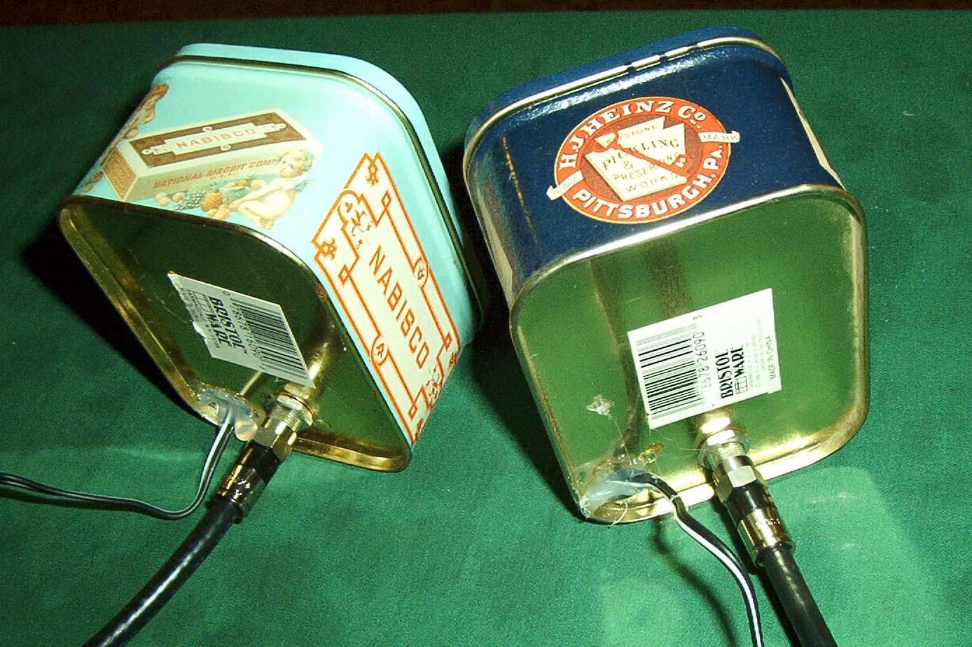

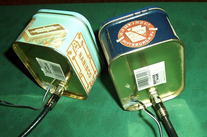

So I needed two metal boxes to put the transmitter and receiver in. Then needed two coax connectors to attach the coax cable to the boxes.
I went to my local 2nd hand store and found two small tin cookie/candy boxes. 50 cents each. And I found an old cable TV box which had 4 coax connectors on the back - $2.

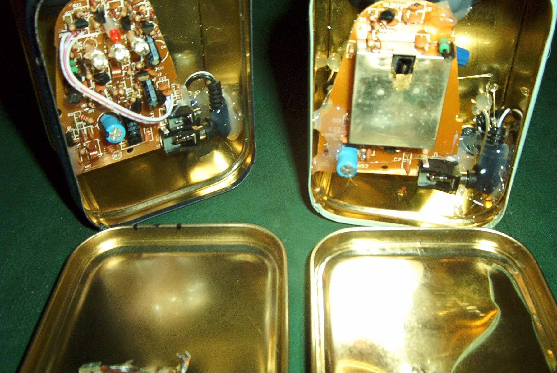

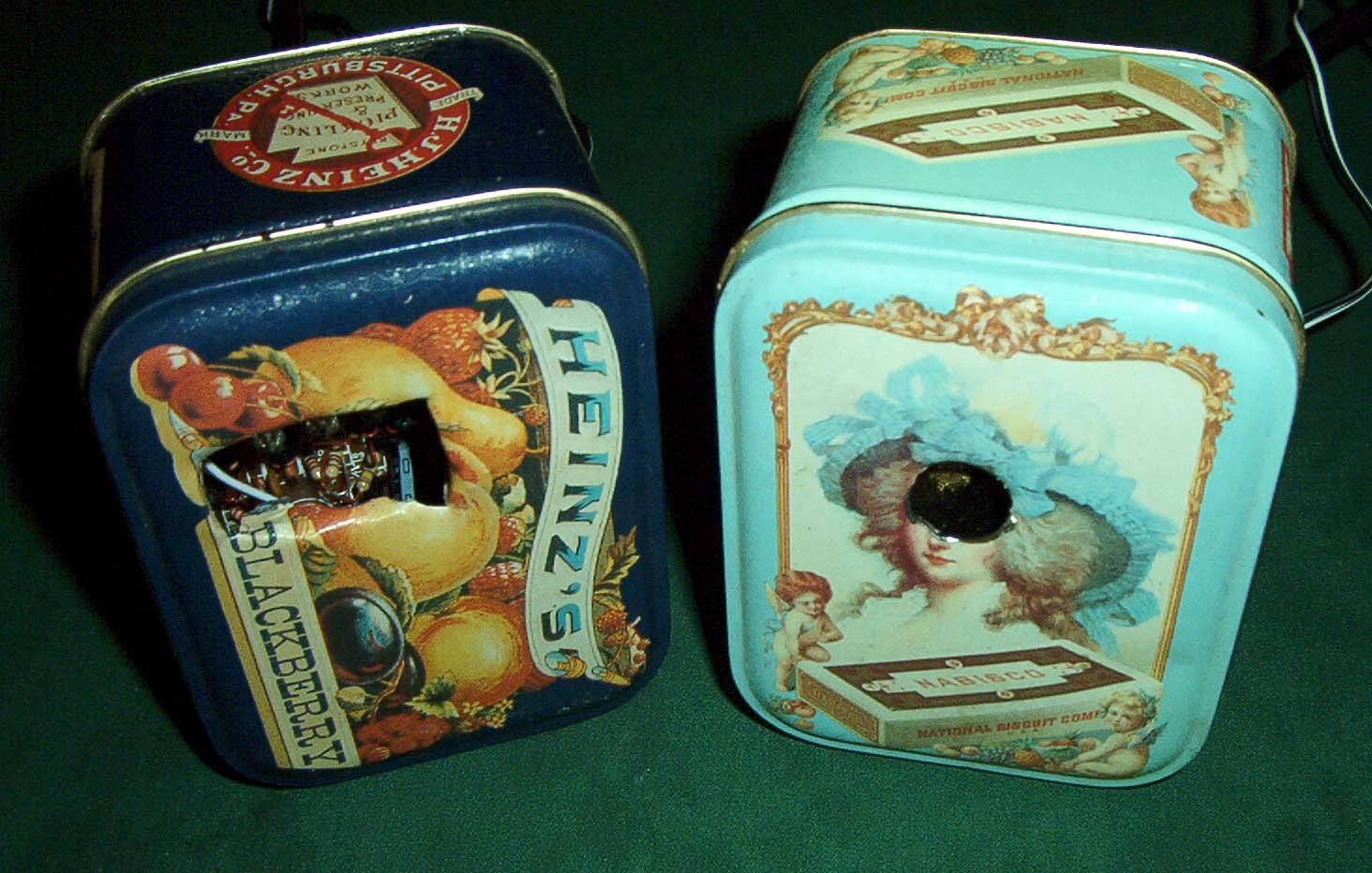

Then I went home and unsoldered the coax connectors from the cable box, drilled holes in the tin boxes, and installed the connectors and circuit boards. Then drilled holes in the covers for the light receiver (transmitter) and IR LED's (receiver).
Then attached the coax, powered them up, and they work perfect. I basically have the entire works (including the communications between the two), shielded from any outside noise via the tin boxes and the shielding on the coax, which is connected to the tin boxes.

Jensen transmitter out of the box.
Aluminum foil test
Back of tin boxes
Inside of tin boxes
Finished boxes
