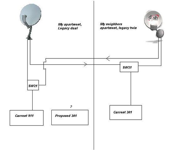

As usual, this isn't a movie and the story doesn't end here. This was just one dish, on my window, facing 61.5 so I could only get international channels. Then after discussions with a neighbor who lives on the diagonally opposite end of the building and facing 110/119, I convinced him to install the dish 500 on his ac unit. Now, I needed a feed from his dish, and he from mine. We somehow managed to tip the super to help us run 2 hidden cables in the building shafts, and the length was 500 feet each since we're on different floors and on opposite ends of the building. After days of hidden work, we managed to accomplish this. We have our own accounts, but we share the dishes.
The Present dilemma:
His window has a legacy twin 500, and I have a 300 dish with legacy dual lnb. One cable carries 110/119 from the twin to my place, and the other cable carries the 61.5 from mine to his place. We both have SW21 switches in each apartment combining the 2 feeds. I have a DishPro 811, and my neighbor has a DishPro 301 Now I have decided to add a second receiver to my account for my bedroom. Is there a way for me to add a second receiver in my apartment, without having to run a third cable from my place to his? I am willing to change any and every switch, and LNB's if necessary, but running additional cable will be next to impossible.
Ideas?? Comments?? Snide remarks??
All appreciated. Thanks.

The only option I can think of is to somehow swap out the Lnbs to Dish Pro's, you have 1 feed from your 61.5 dish going to his apt... make that cable go as close to his dish as possible. He will have to switch to a Dish Pro as well. take the 2 feeds from his dish and the 1 feed from the 61.5 and run them into a DPP44 (Pricey). now you have 1 line left to your apartment. Attach a Pish Pro Plus Seperator on it. This will only feed the 522, 322, and 921. So you would have to get one of those recievers and run your tv2 wire creatively. This should work unless I missed something. But it is quite pricey

You should probably look at the Dish Install Diagram thread over on dbstalk and take a gander at the pdf file in the first message. You want the last page, 16.
If you really want to try and run dual-tuner receivers with the dpp separator so you can use single cable runs (this only works with the 322, 522, and 921), you would need to replace the relativly inexpensive dp34 switches with the more expensive dpp44. The separator WILL NOT WORK with any other unit, don't even think about it.
