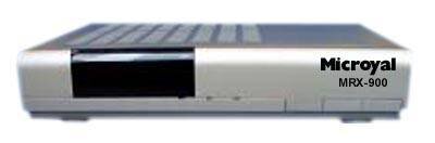

The receiver seems well build and very pleasant, silver colored with a black faced LED. It has a very easy to read green LED that displays the time when in stand-by mode, or the current channel when on.

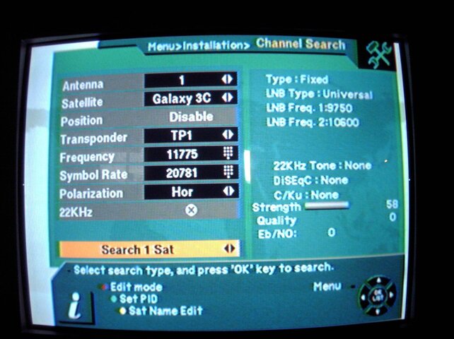

While it does have DiSEqC 1.2 and drives the motor without a problem it can only return to zero from the settings menu - you can not sent it to a specific X from the receiver. You have to do that manually outside at the motor.
It has a nice feature that will tell you if you can theoretically view any satellite by entering your Longitude and Latitude, and of course the location of the satellite.

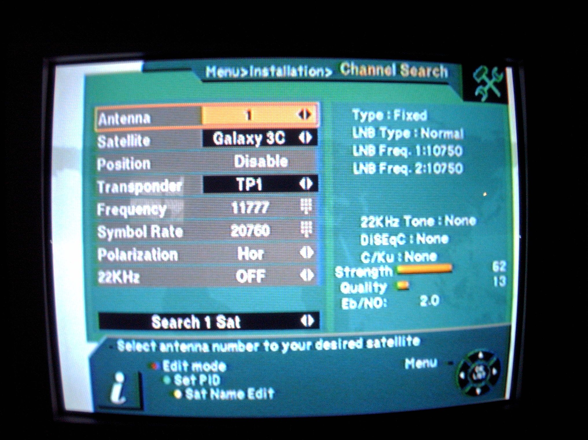

When it locks on a satellite not only the color of the strength and quality bars change but also there is amber light that illuminates on the receiver - this is great for channels that might have no video/audio but still part of the link, you do not have to enter setup to make sure you are locked on the bird.

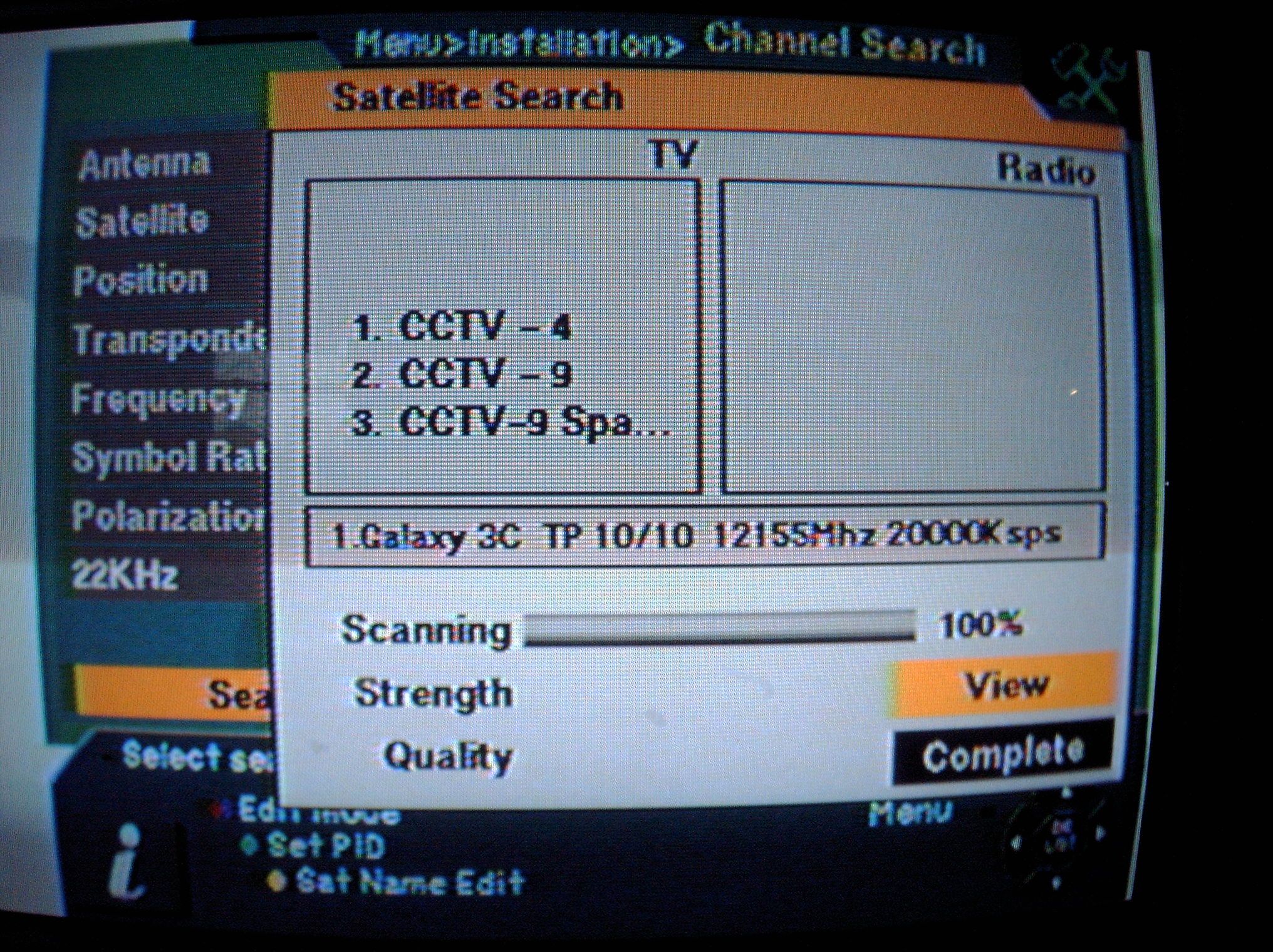

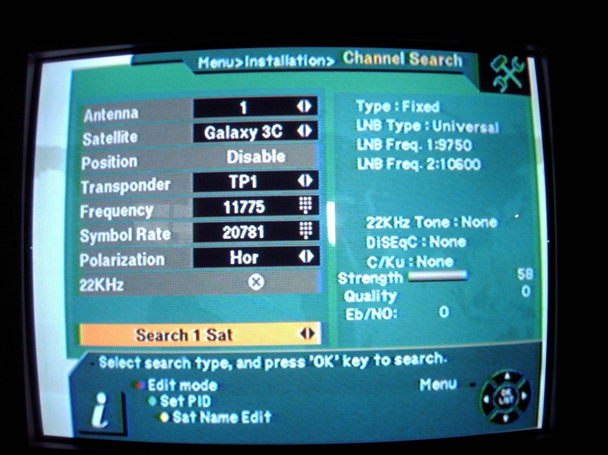

You must scan a satellite to ensure that you are on it - that is a negative since you need to have a live transporter programmed in order to see quality - however it is juts an annoyance and not a serious problem. Once you have any quality it seems to almost immediately register even the smallest change/movement.
