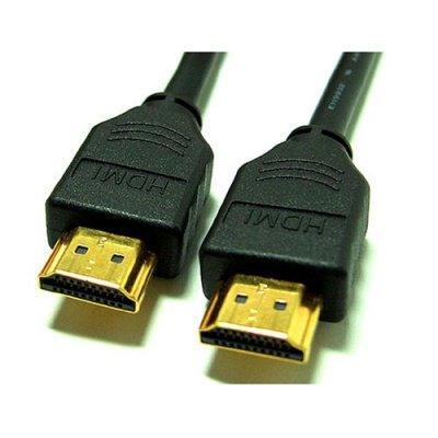

Primestar that thought had already crossed my mind. When I origionally purchased this I tossed the HDMI cable into a box of other cables. I retreived two of them from the box one is straight thru cable and the other has a little round barrel about 6 inches from each end. Not sure of which one to use.
Here is what an HDMI cable looks like:
Thank you, I know what the ends look like. I was not sure of the two cables which to use...anyways I went to my Daughter's house, she has a HDMI TV. I used the straight thru cable and it works on HDMI. I have screen output. I don't recall any settings to select on the MicroHd menu to select between the two, composit and HDMI. If none exist then it will have to go back for warranty. Or perhaps someone knows of a software issue that may be at fault.
