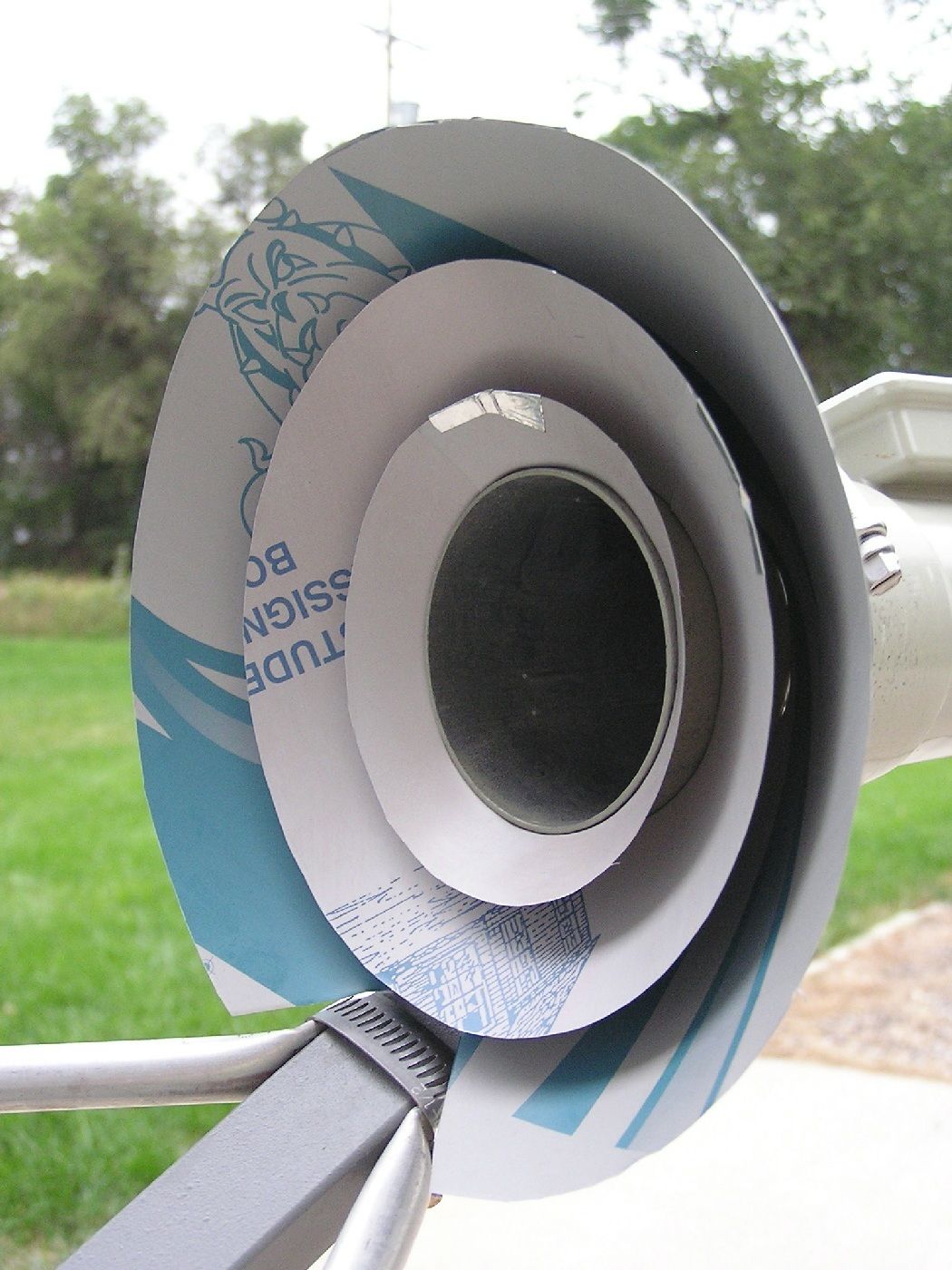

Before you buy a new dish I have a home made scaler ring design that another tester named walrus from another site made. This design will improve your signal strength big time. and will cost about $5 to play with. I will try to find the dimentions of the rings. I made the rings out of thin baking trays from the dollar store.
This is some of the dimentions you'll need to play with your mini bud. Trust me it really works for the small dishes. Hats off to the maker walrus.
Refereing to the photo showing the three cut outs of one small, one medium and one large ring. This wasn't the optimum performing scaler but was second best. To fabricate this scaler lay out a sheet of tin and draw two concentric circles, cut out the inner and outer circle with a scissor and slit the tin to open the inner circle. Wrap the ring tightly around the neck of the LNB and use a small piece of aluminum tape to hold the ring together. Space the rings 15 mm apart with the smallest ring positioned at the very edge of the waveguide. cle, 140 Here are the demensions for the three rings:
Small- 90mm inside circle diameter, 140mm outside
Medium- 90mm inside circle diameter, 200mm outside
Large- 90mm inside circle diameter, 260mm outside
megaphone!
scaler looks like megaphone! so do the dimensions need to be precise? also, how to attach to the cband lnb and have the ku lnb on board? looks like the six foot, but smaller would be nice!!! that way the motor would be faster. or more magic board ku lnbs on the c, but that might distort...comments?
