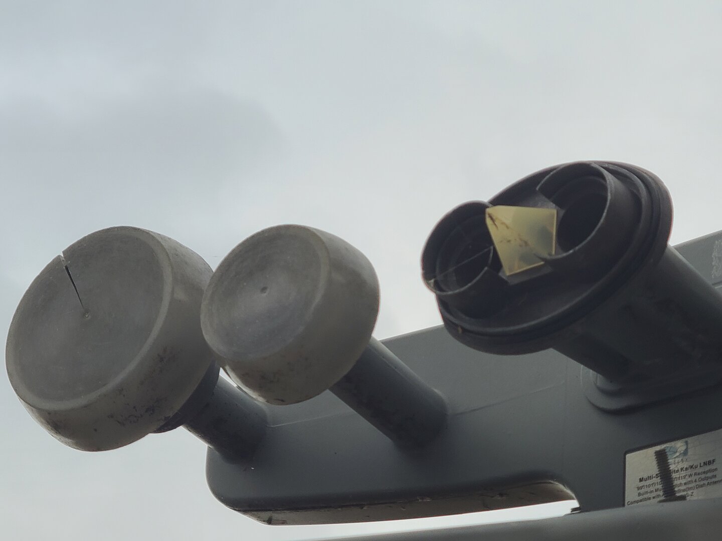

Seems odd. About a month ago, I lost the hd side of some of my channels. Sd still comes in just fine, and I only lost some hd channels. A few of the still good signal inHD are 229, 238, 239, 240, 246, 249, 256. Some of the hd channels lost are 231, 232, 236, 237, 241, 242, 244, 245, all locals. Any ideas or thoughts would be greatly appreciated!

What are your Sat Numbers --Dish align out or a Bad RG6 Down lead -check your cable ends exposed outside
Thank you! I forgot about LNB, I will check that and cables today after work. My dish is probably 8+ years old now. Any idea what I'm looking for in LNB?
Sorry I didn't get back sooner, I'm guessing this as something to do with my problem.
