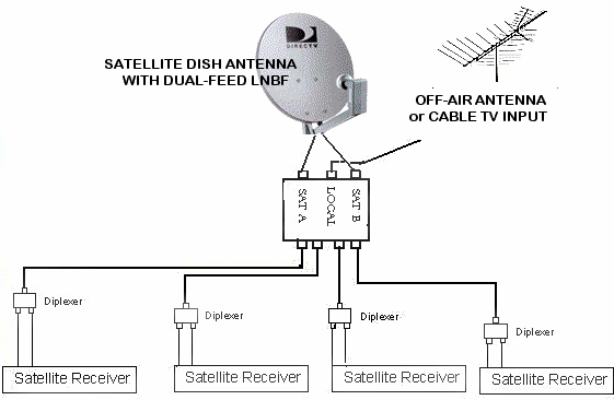

Both cables from the dish's LNB should go into the correct marked IN PORTS on the multi-switch and all your receivers should get cables from the multi-switch's OUT PORTS. What multi-switch are you using and if you don't have its wiring/instruction guides, maybe one of the other users does and will post it here for you.
i am using one i bought at radio shack. so what you are telling me is that my other receiver should be run through the multi switch as well. right now i only have one cable from the dish running into the receiver 1 connector and from there the two outputs from receiver one connector to my dvr.
Yes, you should run both (the 2) outs from the dish's LNB directly to the multi-switch. Then use the outs on the multi-switch to feed ALL of your receivers. Do you have the make & model of that RS switch? or do you know what format it is? ex: 2x4, 3x4, etc?
Maybe THIS ONE
If guessing yours is similar, see the attached diagram. If you do not have an added OTA antenna, just ignore that and the dixplers at each receiver.

that is the switch i have. i have one cable running into the one input and two cables coming from the receiver 1 and 2 to the dvr. i'm working right now so i will try hooking up both cables from the dish to the multi switch tomorrow morning and see if that works.
will it make a difference if i hook the cable i have going to the switch now to the other input and switch the outs to the dvr to that one???
