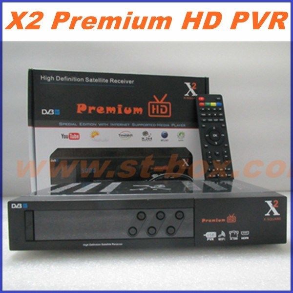

Looking to get RTV. Will an X2 HD receiver work?

First it was the 8' mess and nada. Then I tried the 10' mesh and nada. Going to try to move the 12' solid next. It's not near the transmitter BUT I just want to get it now. Such a PIA

i can get 4149 H
I can also get one or two other transponders. I write them down next time I get up there.
That is why I was wondering if i should try another receiver.
Thanks
Doubtful that one DVBS2 STB would receive RTV and another would not.
