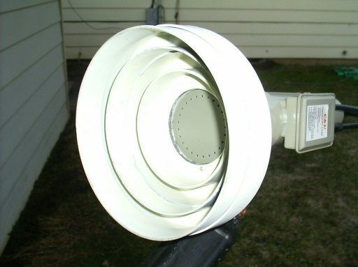

Here is mine, made by a member here...........

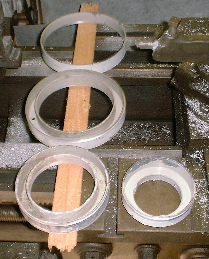

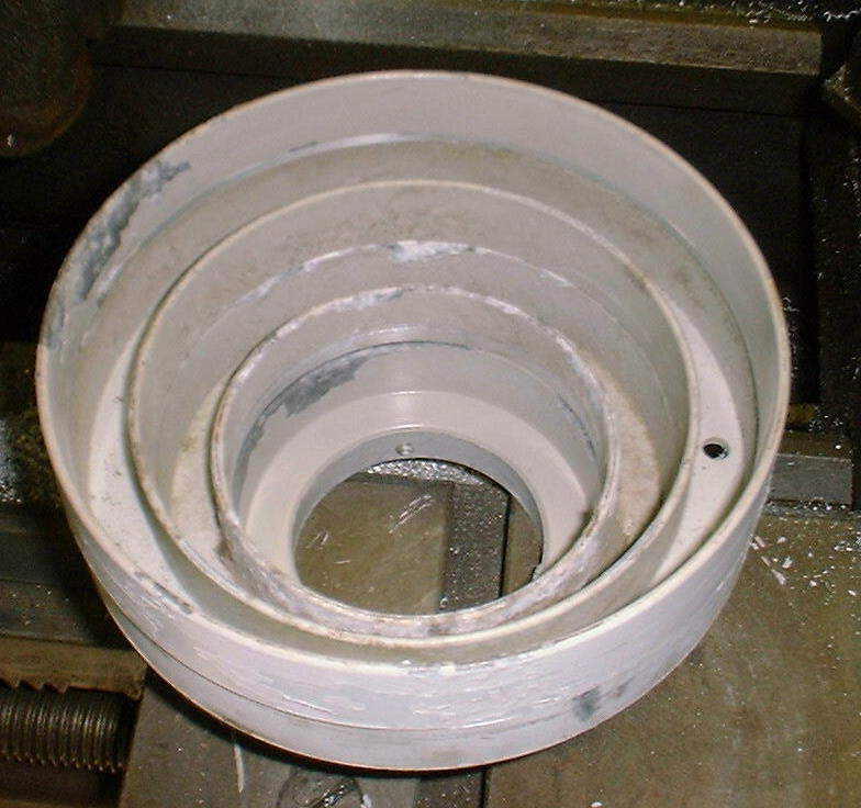

Home made cone
I was able to take some old flat scalers and machine them so the rings could be stacked. Id sent them to PSB and Cascade for testing purposses. Its not an easy matter but they do seem to help the signal. I hope spindoctor will get some more, Im not sure Id be to crasy about building a number of these. Alec
