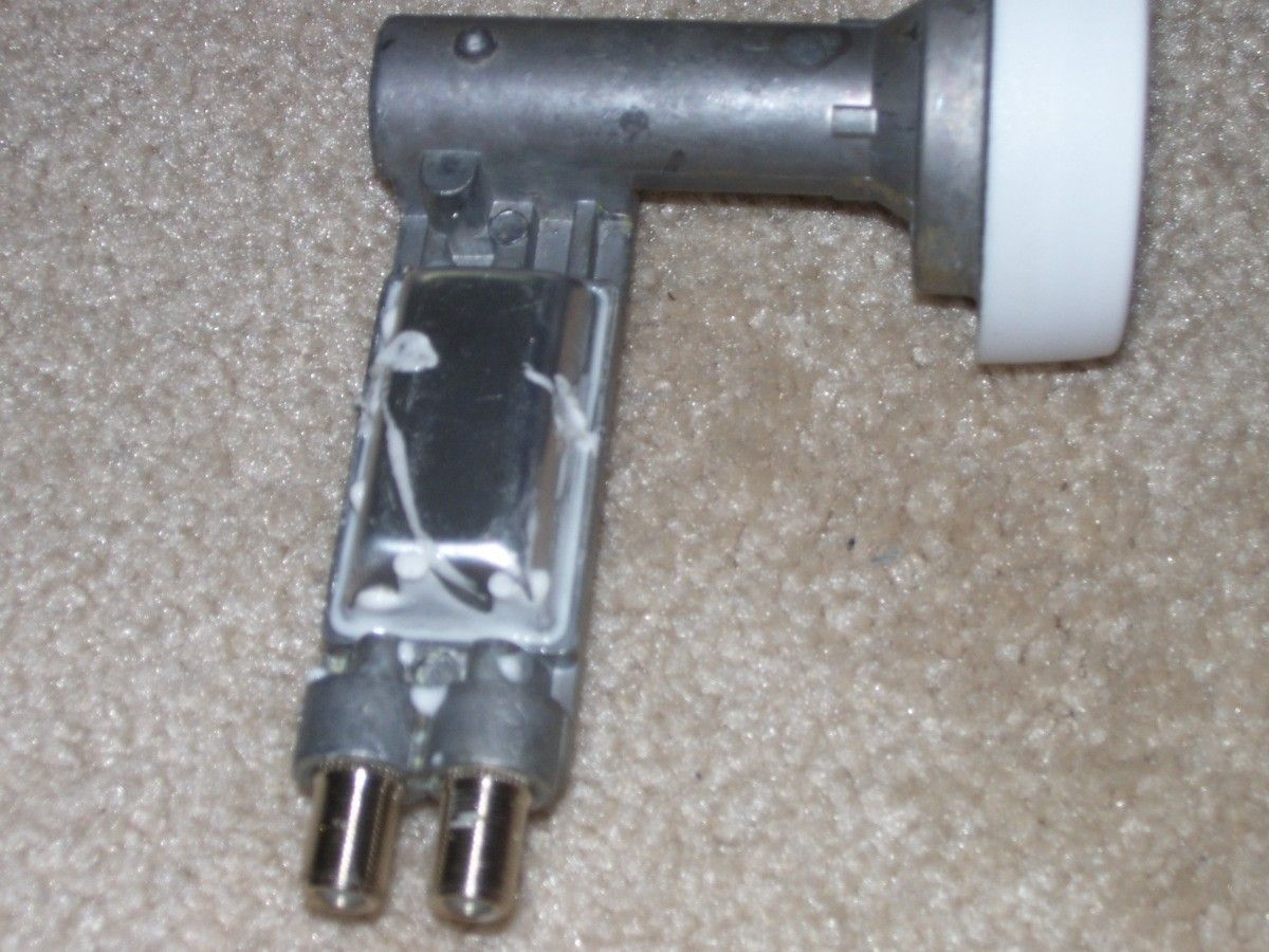

As to question - yes, those LNBFs without plastic cover run perfect for years; because it's created for aesthetic purpose not for weather protection.
oh smitty dont get your panties in a bunch :rolleyes: This aint the other areas of satguys. This is the FTA area where we have more lax rules (and more fun) :)
As for the OP question, the cover really doesnt do much as the LNB is still sealed.

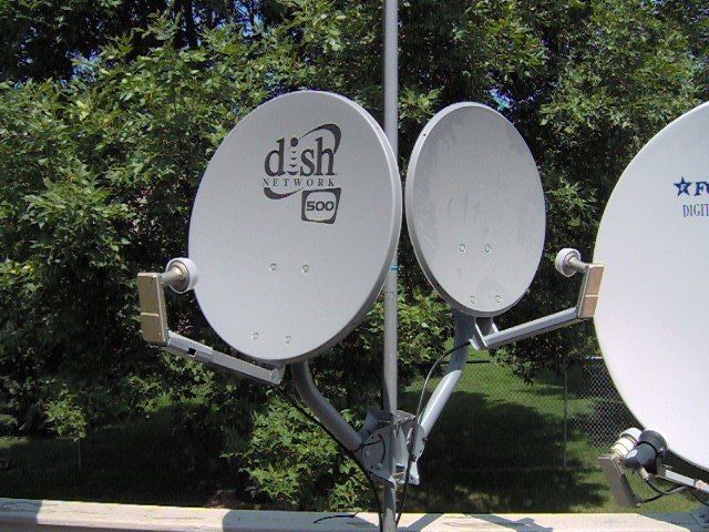

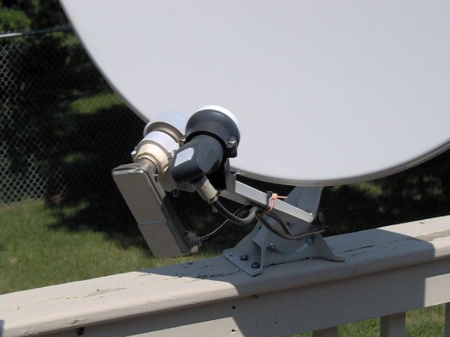

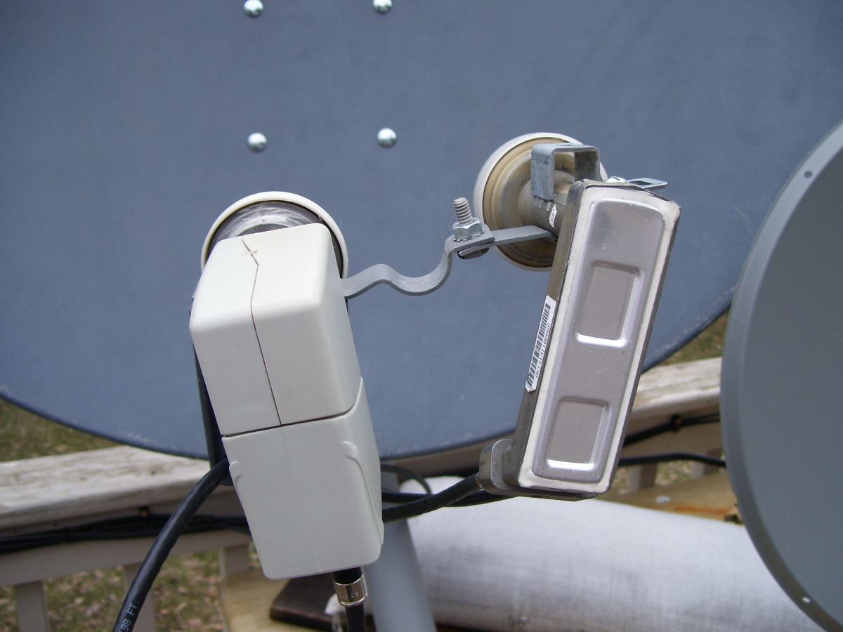

as for "which thread"....well I've done that a few different times to LNB's ;)

The Dish Pro LNBs have what appears to be silicon sealant around the edges and a silicon filler at a round hole what may be an adjustment hole.
