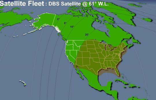

Montana is fringe to deep fringe for 61W. You will most likely need a larger dish to receive 61W.
Your best bet is to find someone close to your location pointing to 61W and get real-life advise on what will be needed to receive 61W reliably.
If I were to take a stab at it, I'd have to advise you get a 24" wing dish for 61W from Montana.
Edit: Looks like you were able to bring in 61W with your 18". Good deal... http://www.satelliteguys.us/dish-network-technical-discussions/121130-dish-61-5-a.html

That graphic previously posted as I know for a fact it works fine in California, Oregon, etc. The look angles are very low but if you can get line of sight you'll be good to go.
