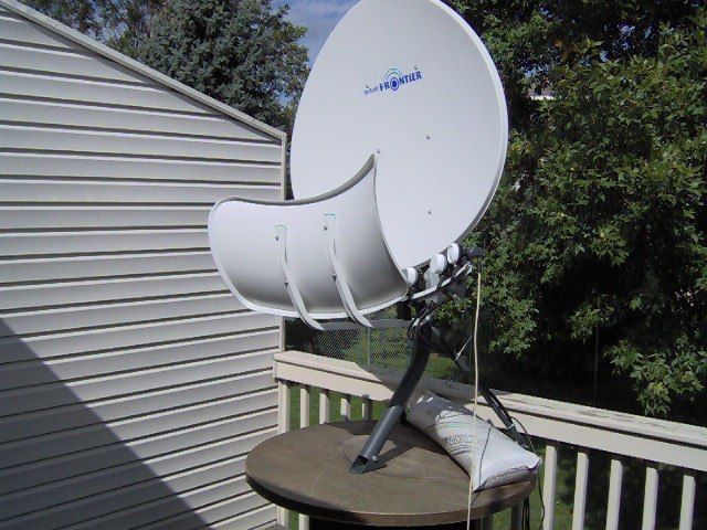

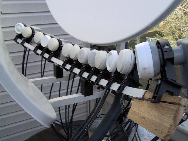

here is an example of my Toroidal T90 dish. Yes the LNB's face different but the principle still applies. the closest LNB is 119 and the farthest away is 72

Its kinda nice to have my Dish subscription(110/119), StarChoice subscription (107.3) and a few other free to air satellites all on one dish :)
