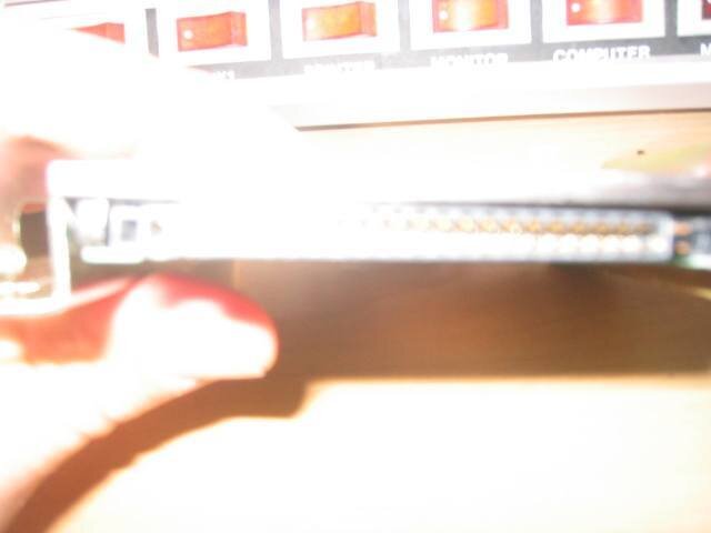

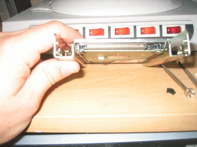

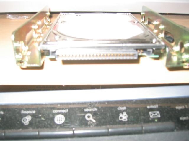

so i got it in the mail today go to hook it up, I have a seagate harddrive and instead of having the pins stick out like on most hard drives they are actually enclosed in plastic? see pic

ok there was and an adaptor on the laptop hard drive i was able to pull off, and put the adaptor plug the covertor I purchased into the laptop. however when I went to hook it up to my desktop the adaptor that has 1 too many pins, the middle pin that is normal out, is there. So I cant attach it to an ata cable.
You should be able to just break the pin and connect the cable. I'm looking at my adapter and it doesn't have that pin in the middle but I've seen some that do. Either you find an IDE cable that has an opening for that middle pin or just break the middle pin.
