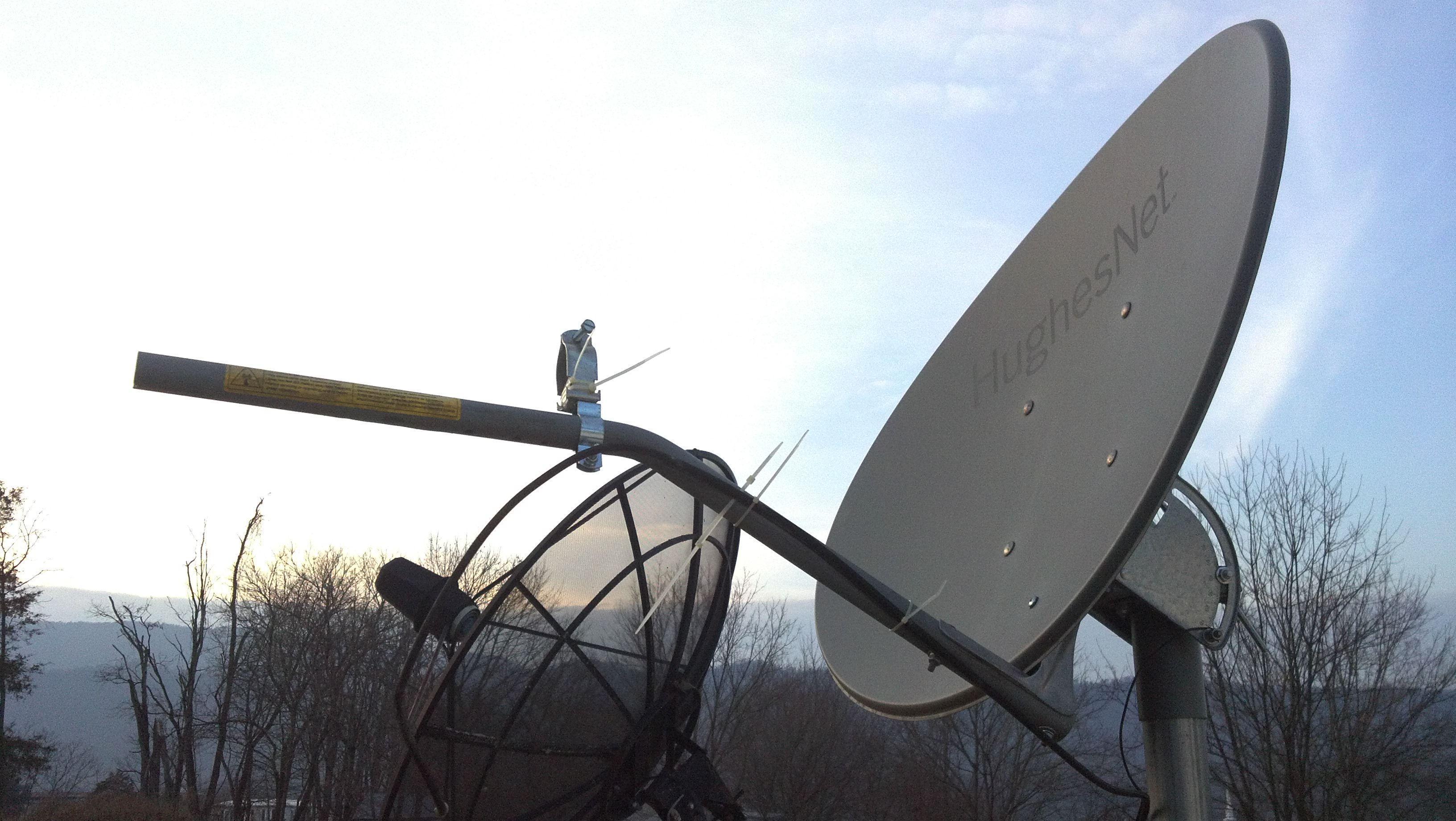

I am trying to set up a Hughes dish for 97w. From the research I have done, the model I have, AN8 074P, was intended for Ka. My question is, if I use the original lnb mounting mast, would the offset be the same for a Ku lnb? Using Avenger PLL321S-2 Ku lnb. I have set declination and skew according to my long&lat, and made necessary modifications to raise lnb so it would be centered with dish accordingly w/ the mast. No luck. But then again, this is my first attempt w/ a Ku setup. Thanks.
Yes. The focal point is at the same location no mater the frequency. If you had the original LNBF measuring the distance, to the front center of the LNBF, from the upper and lower lip will be the same for the Ku LNBF. Might have to be able to adjust closer/further away from the dish face to account for differing manufacture of the feed horn throat (How much plastic is in front ot them)

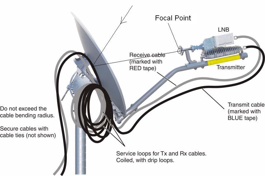

Don't know if this helps or not, found on google search:
http://www.montanasatellite.com/man...elin Ka-Band Antenna - Installation Guide.pdf
Another question: Ku LNBF type? If it's intended for a normal offset dish, it will under illuminate a elliptical. Better performance will be had by using the original feed horn. Mate a FTA LNBF to it. Some here have done it.

Thanks FatAir. Unfortunately I don't have the original lnbf. Hate to say it but original owner threw it away! :( I am using Ku lnbf Avenger PLL321S-2. I found center of dish, then held a 2foot level on that and got it parallel w/mast. Measured up from mast to bottom of level to find center from mast to dish. Thats the only way i could think of figuring what center of lnbf would be. Tried moving lnbf in&out and several blind scans. Actually didn't spend a whole lot of time messing w/it. Was running through my checklist of what I may be doing wrong. That's when I thought about it being originally made for ka. Thanks again.
And thanks for web link. That's actually where I found most of my info about the dish.
Well the only thing I see is you may be way too low. Look at fig 29 @ page 34 of the pdf. Since you know the height of the LNB support, think you can measure on the pic and transfer to your mount.

@FatAir: tried scaling picture(I am using a smart phone) the best I could come up w/ the lnbf needed to be raised about 7/8 of an inch. I am standing in front of dish and centering lnbf w/ center of dish if this is what you mean by '0'.

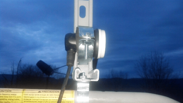

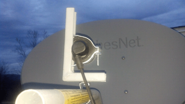

I made a bracket out of unistrut so I would be able to adjust lnb up and down to find center instead of guessing. I am about to the point where I am starting to believe the lnb isn't working. I have adjusted up&down, in&out, different declinations, skews. Nothing. Even I weren't aimed perfectly for 97w, I would think after the hours & hours of trying, I should have hit something by now. Of course I did order this lnb from the same company that sent me a c band lnb that wasn't working correctly, and a digital meter that doesn't work at all! Kind of adds to the belief this ku lnb isn't working! Idk. Thoughts anyone?

Hard to tell the geometry from these images, but your lnb may be pointing high on the dish. Only guessing here. It may be easier to freehand the lnb in space with the dish at the proper elevation and azimuth for your south satellite. I was able to simply hold my ku lnb in front of my BUD and find the spot there for an offset mount. This is where a decent signal meter is invaluable.

@gpflepsen: I set azimuth & elevation for 97w, I hadn't tried true south tho. That's the same pdf I was trying to scale off of for lnb setting. Didn't have any luck, that's when I came up with the unistrut bracket so I could adjust up & down to take the guess work out. But yes, I would have to agree about a good meter. Granted it was a cheapo meter, but I even hooked it up to my BUD which I know for a fact was working, never budged it.

The LNBF should not need to be tilted up or down. It should be mounted level and parallel on the support arm. This should aim the feedhorn into the correct area of the reflector.

Let me clarify. Im not tilting lnbf, I made the bracket to adjust up and down to find center. The only reference I have to where the old feedhorn was located is the pdf I downloaded that shows how to install original hughes equipment. Every time I adjust I make sure lnbf is parallel w/ support arm, and stand in front to check it is centered.
