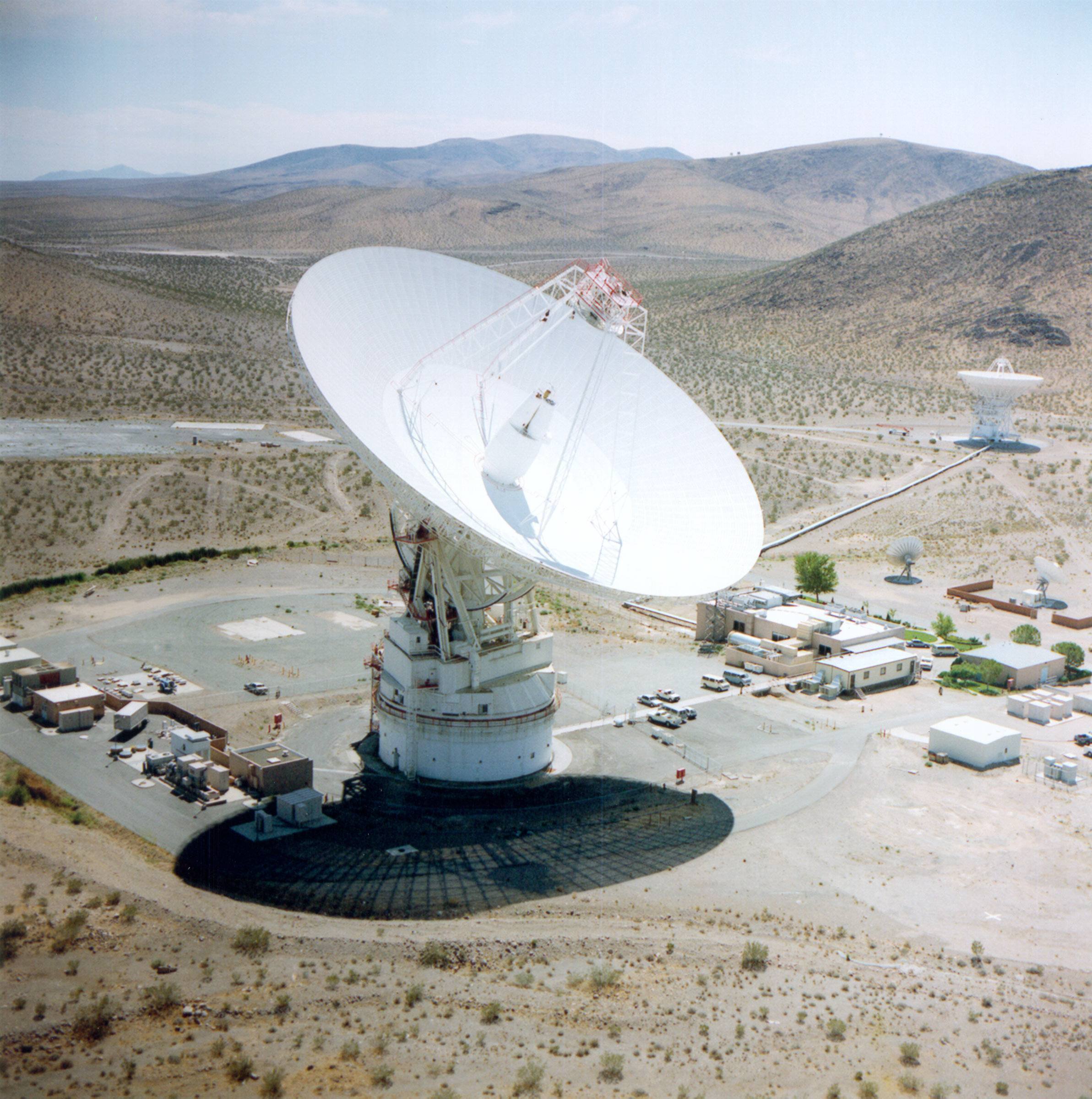

Welcome to the forum, always good to have another vet of the cband days.
See if your wife would go for one of these:
WELL SNAP!! I guess I should have done a forum search more thoroughly before posting such a question. It has been asked before. Now I do feel like a noob.
Welcome to the forum! No noob-consider yourself fortunate or just plain lucky you found what you were searching for along with the other 200 messages that show up in a search.
Turbo, Do you think you could "pin the meter" with that one?:eek:
