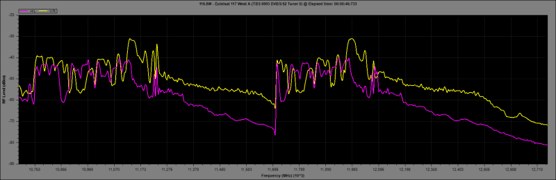

KU Band Transponder gets decent signal but 0 SNR, what can be done to fix it?
I should have included that my readings were from a 90cm dish antenna. A larger dish might yield better results. Here is a scan from 10700-12700MHz:
Lots of low band RF on this bird!

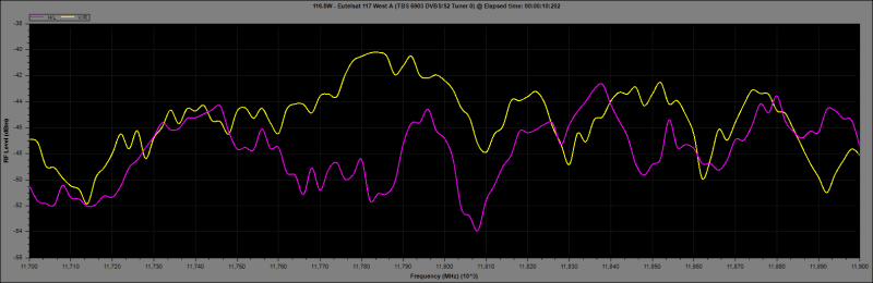

second scan 11700-11900MHz
