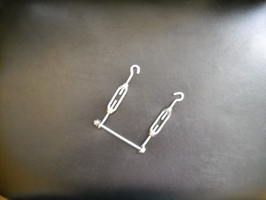

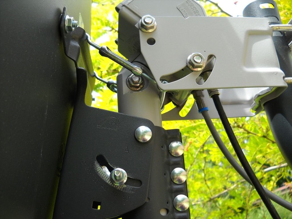

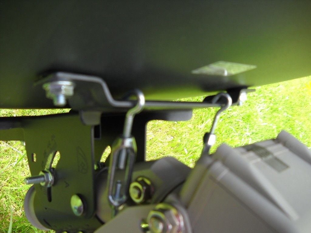

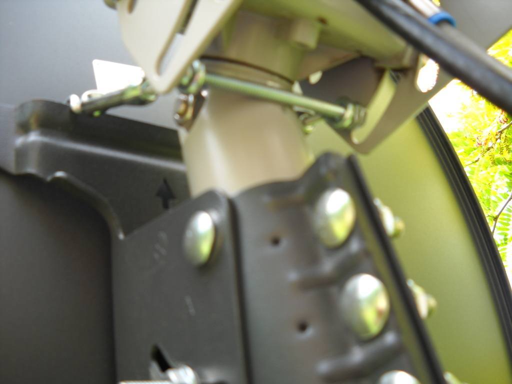

I have Geosat's 90cm Ku band dish and fought with it when setting the elevation. By hand it either was to much or not enough, or needed three hands. I finally came up with this and it works fine for me. Of course your mileage may vary.
It consists of two (2) turnbuckles and one (1) 3 1/2 inch long stove bolt. Pictures they say are worth a thousand words, so here are a few thousand.
