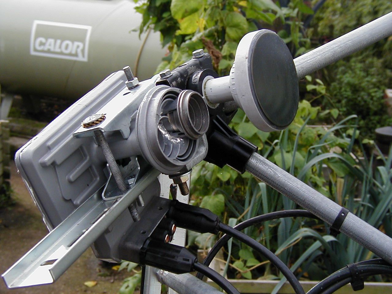

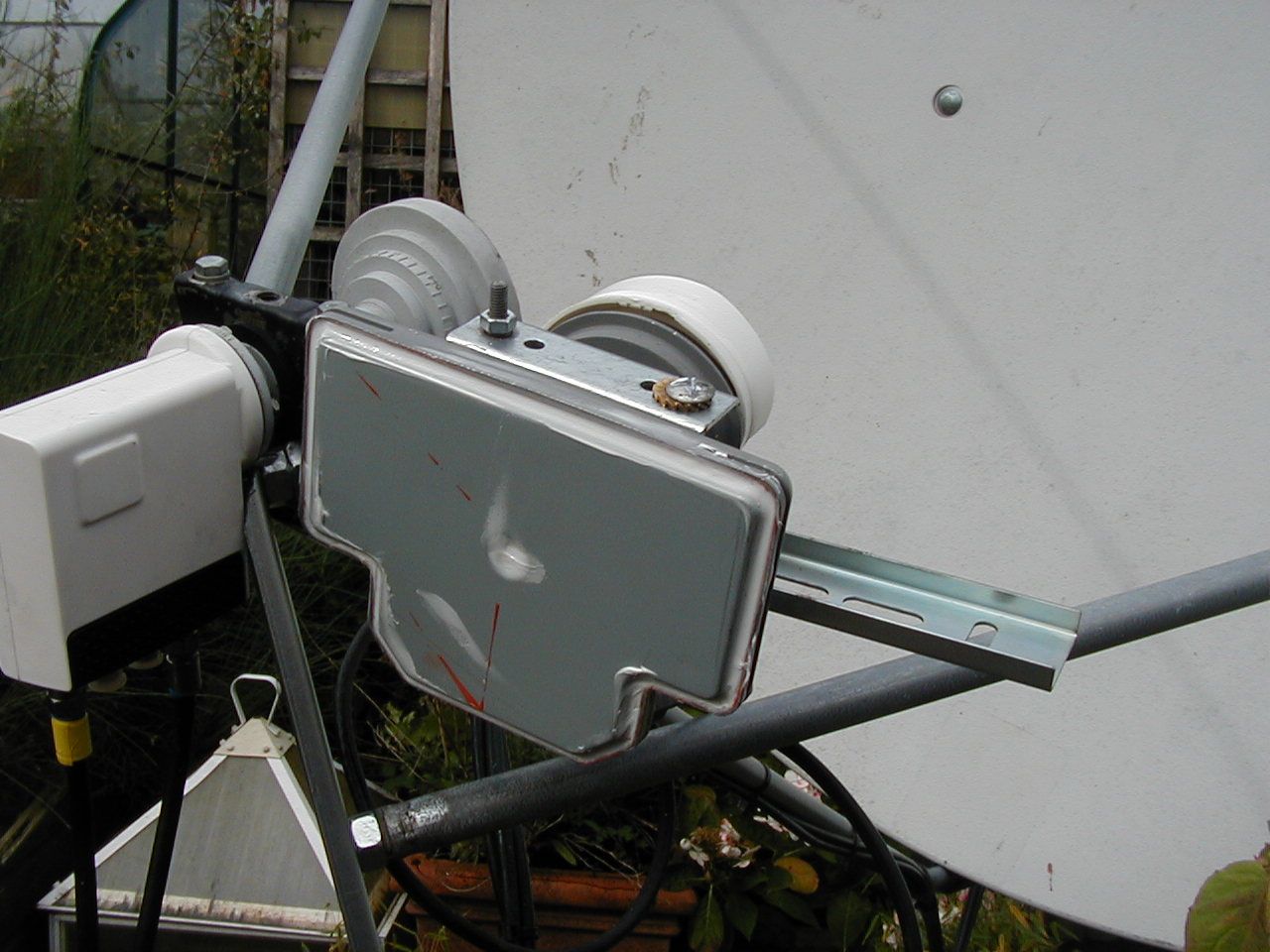

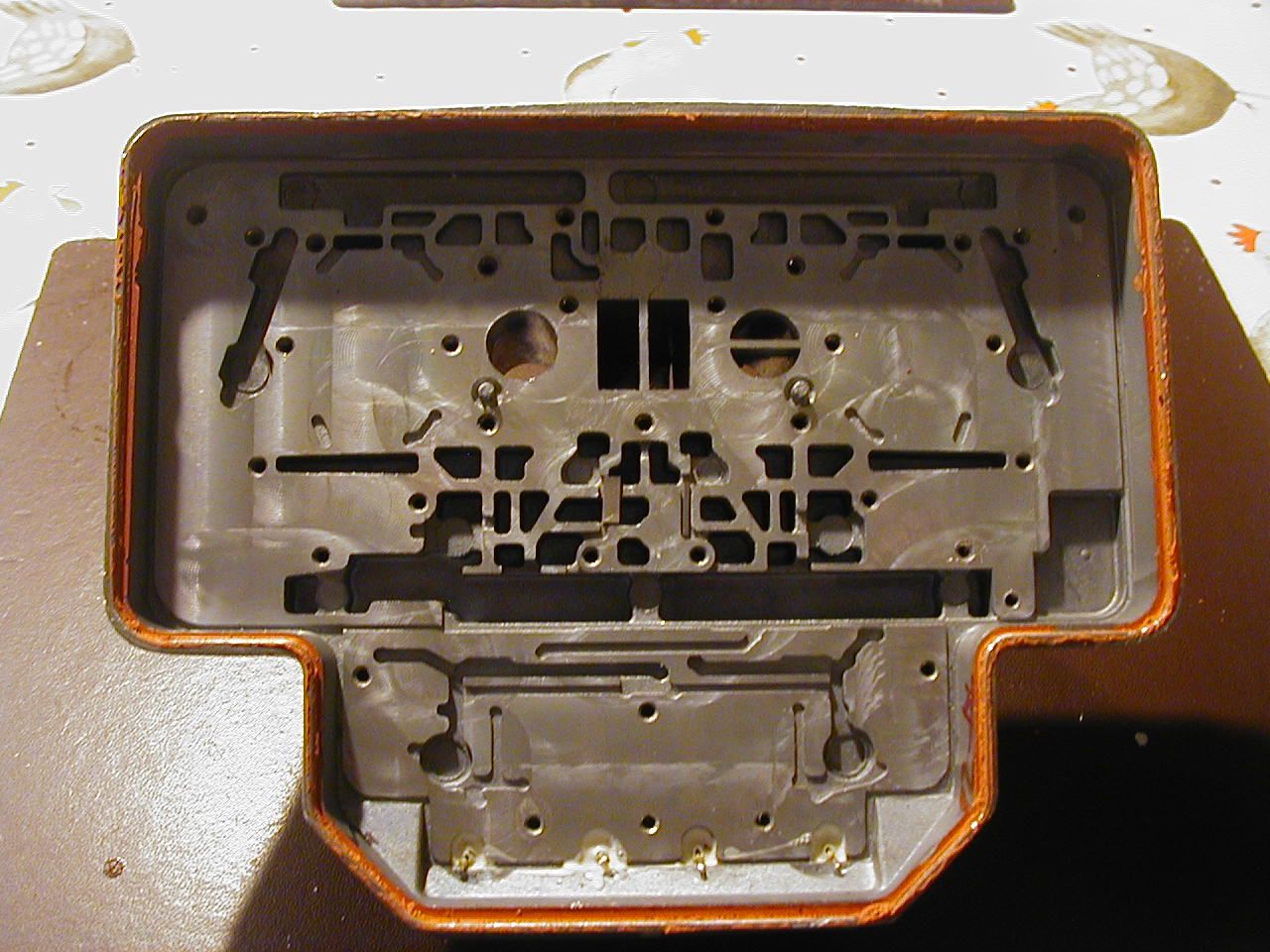

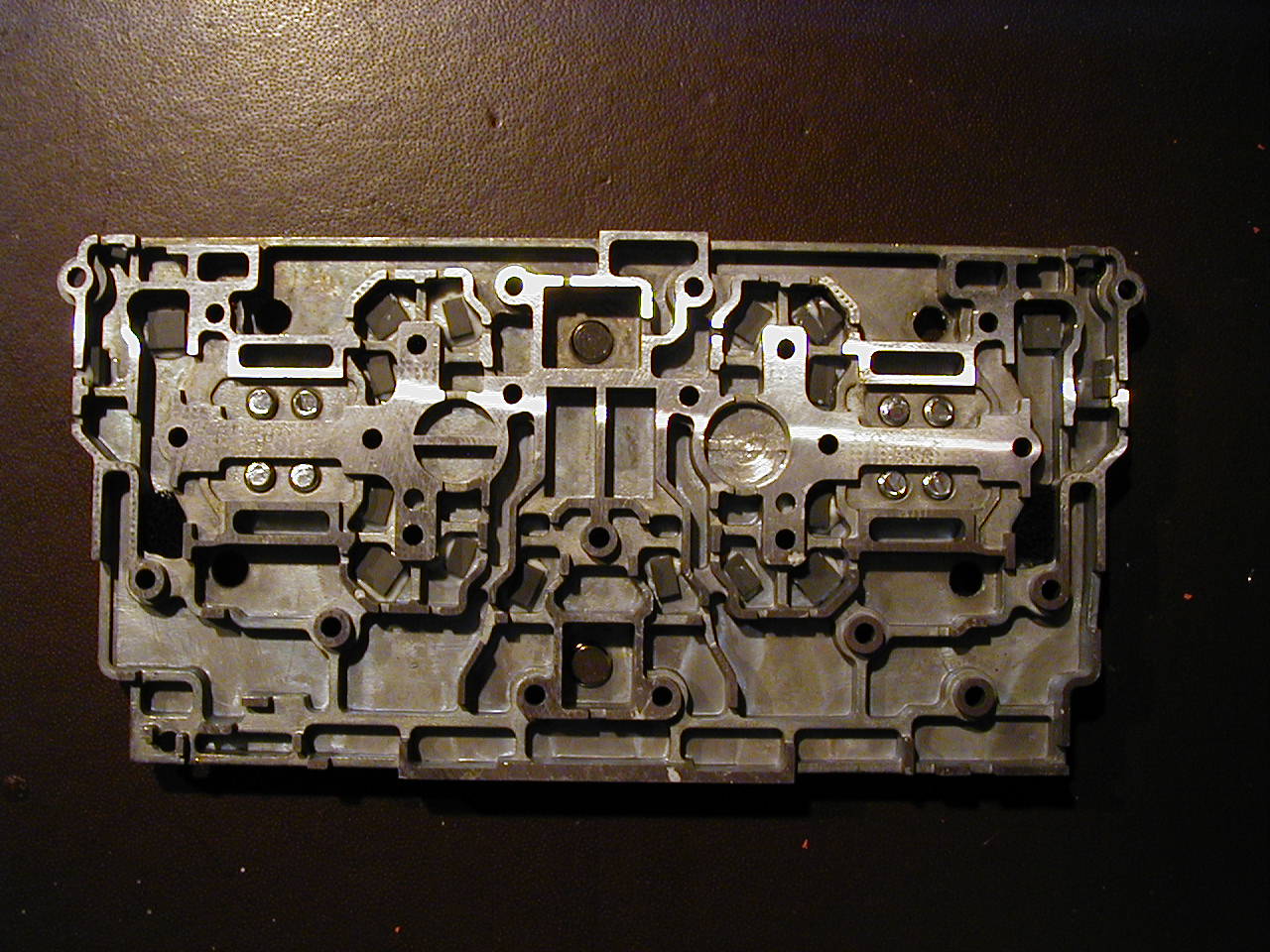

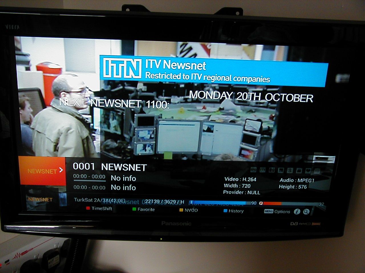

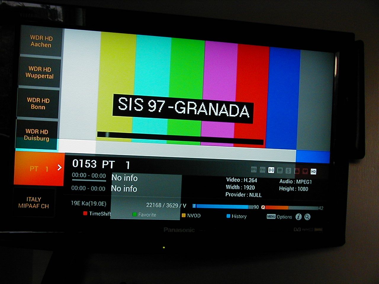

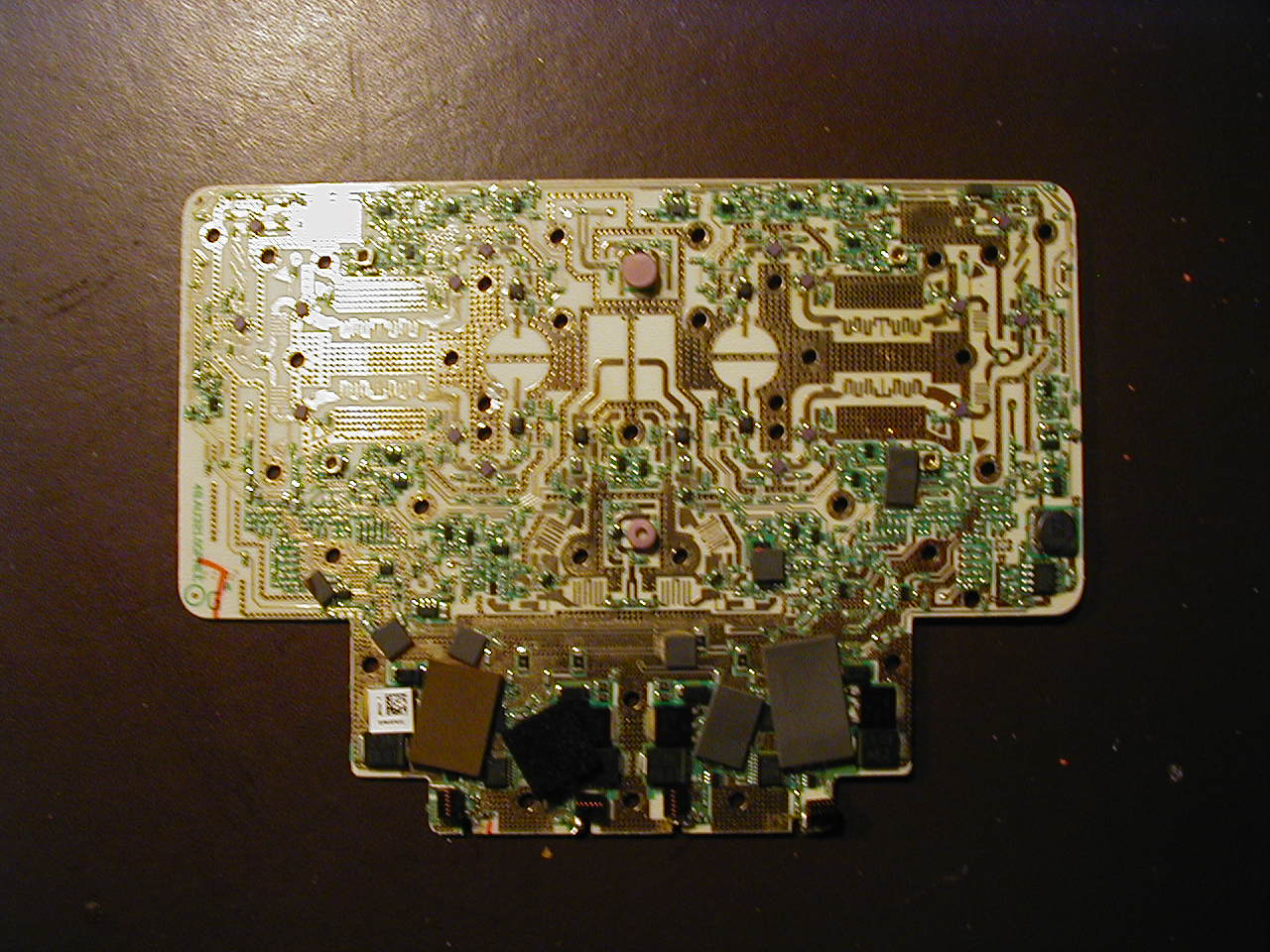

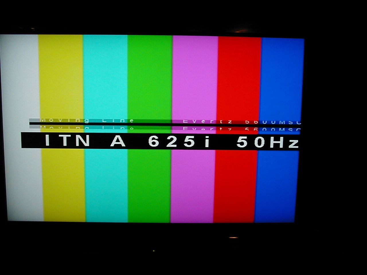

Yes indeed Titanium, the DirecTV LNB's are very useful to me and others over here in the UK for feeds in the lower band of Ka off the Astra satellite. With a bit of conversion of one of the Ka ports to make it more linear friendly, plus the addition of a feedhorn off the Inverto KaSat LNB intended for Ireland, I have had some good results.

If you go onto the Satellites.co.uk forum, their is a section on Ka Band which explains all under 'The DirecTV SL3K4NR1-03' heading.
The forum member Vipersan made this mod happen, so thanks must go to him.
