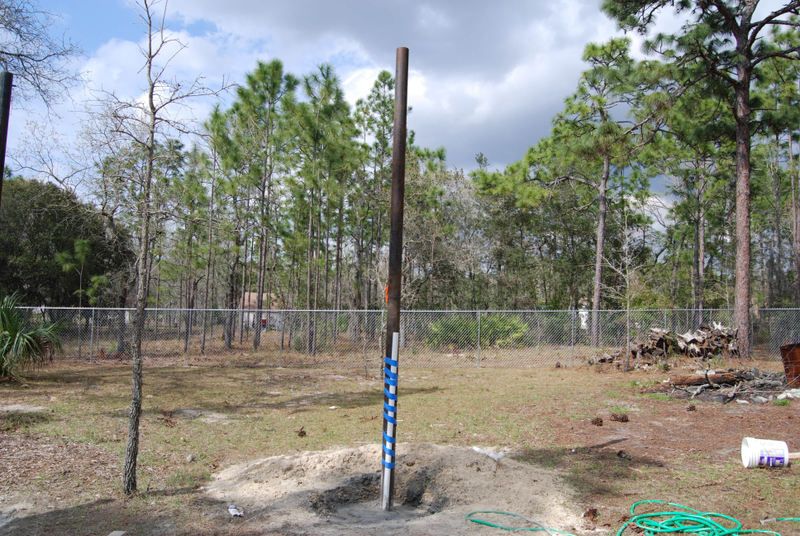

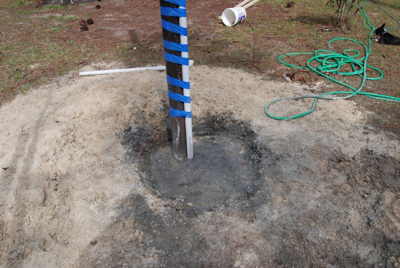

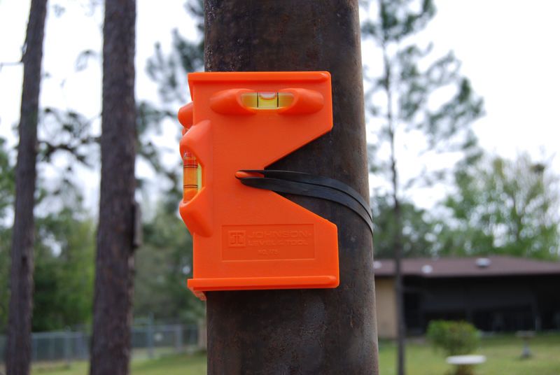

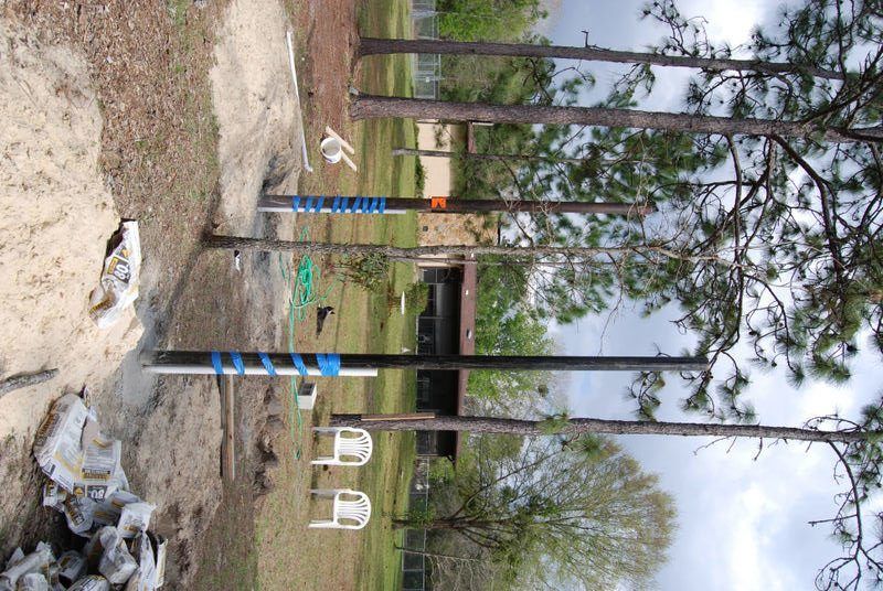

Well things are starting to finally come together! It did seem that for a while it was like taking a step forward then a few steps back. Yesterday we put in both mounting support poles in. The 3” for the 10’ Unimesh and a 4” pole for a larger dish that I’m looking for. Whether that would be the 12” dish from down the street or another becomes known to me. We buried the 3” pole 5’ deep into a 20’ x 20’ inch hole. The 4” was buried nearly 8’ into the ground. The sand in the hole kept giving way collapsing all the dirt into the hole we were digging. We stopped at 7'6' approximately.

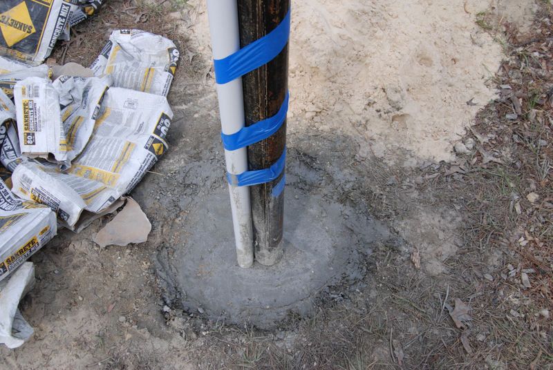

After finishing the work we stood back and took a look at the poles. As deep as I had buried them they were still high off the ground. They are nearly 10’ high or more. One of my friends who were helping me told me that he would come over on this coming weekend and torch some length off the poles. I was thinking at the same time that may be a bad idea as it would hinder the reception of the digital feed. I know it’s supposed to be level all the way around. I was also wondering how I was going to put on the dishes. I remembered the guy that owned the now out of business satellite store and how he used what is called a “Dish Crane”. I tried finding that on the Internet. I did find a site on installing a dish that I thought was interesting. Satellite Dish Install On the page it showed in one of the images a photograph of a tool used to cut pipes. See photo: “sat300”, to look at tool.
I looked all over the place to find such a tool. I was also looking for a dish crane too. No such luck. I stopped by the small dish operator and left a message for him to call me. He’s coming tomorrow to look at the poles and said he could cut them off and put a cap on them. What do you think? Save them the current high size? Or cut them down to a high but not so short size? I want to be able to mow around the area of the dishes. Keep in mind one is a 10’and the other one whether it’s from down the street or from Skyvision will be 12’ footer.

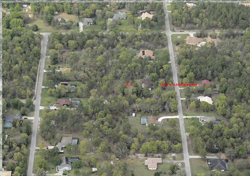

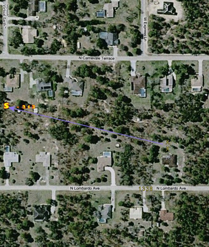

I’m enclosing some photos of the poles. It will be like my Journal of putting up my Satellite Dishes. Starting with poles first. Also I’m putting in some satellite photos of my house. The X X behind the house is the satellite dishes location. With a shot of a clearing of the trees for the signal to go through it. There is a nice spot between the trees in the south 213 degree direction.
I also got a call tonight from the guy who gave me the dish and he told me I could use the Dish crane this weekend. I’m going to take a good look at it, take some picture of it and put them here. It’s an amazing tool!
Thanks everyone.
Tom

What are those funny green things? And all those funny rectangular things around the XX's.... Oh yeah, you must live in a city! Neat pictures, thanks for posting. I plan on getting my poles up soon. I passed building inspection this morning, so I can get working on Sat. TV'ng again.
(There are only 2 trees in our section, And I think we have the only buildings in this section. Our closest neighbor, 1600 feet away, has trees!)
Why those are trees You will find them in most areas. I did live for a time in Wyoming and you didn't trees like these, very scarce mostly seeing Sagebrush.
Those would be homes that people live in. hehehe
No not really.
Thanks and good luck on your build.:D
Oh, you must be in Wyoming too. ;)
Tom.... I would leave the poles the height they are if you can get that dish crane, then that would be great man. better than arm wrestling that monster lol good luck man:hatsoff:

Yes, After giving it some thought I'm going to keep them the same size. They may be tall, however I need the lenght to get above some of these pine trees around here.
I did chop 4 trees down that would have cause a poor signal. So according to my compass, I should be good to go between 213 and 240 on the compass directions.

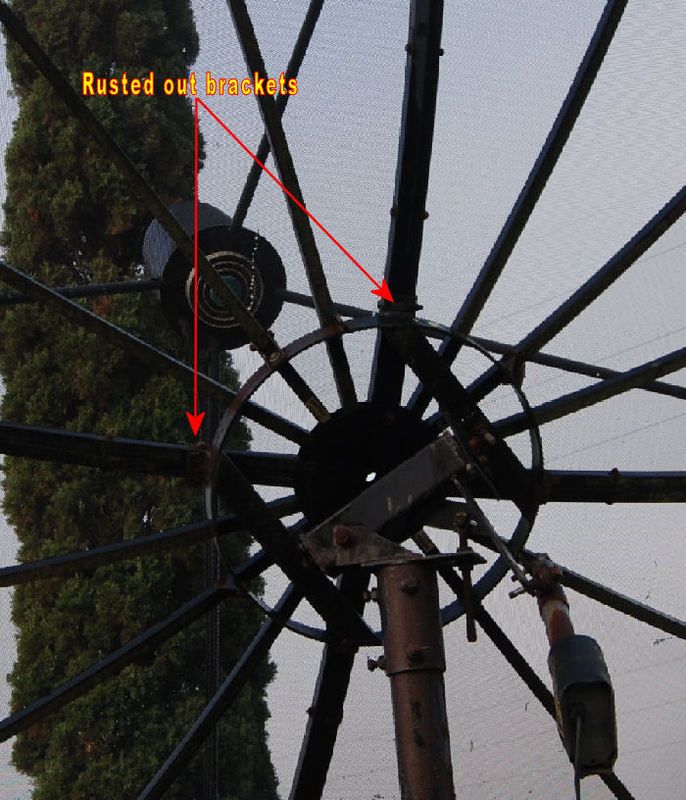

Also took of mount off of my Unimesh as I took a close look at it I noticed that the mounting brackets were rusting out. One side was complety gone and the other side was nearly gone. I'm going to take the mount to a welder and have him fabricate some new ones. Also taking off all of the bolts and replacing with stainless steel. Wow, some of those bolts are really bad!! From the looks the big bolts on the mount are so badly rusted they may be able to replace or free up and be able to put down new grease.

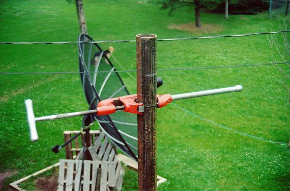

That sounds like an old C-band only lnb. You may want to get c and ku . When you get to the tuning part of the dish, when you tune ku it is very touchy. I fought with my 10 footer to get ku focused in and now it is great.
Leaving the height of your dish is probably a good idea as it gives you some insurance against tree growth.
I carried my 10 footer (sami mesh -pretty lightweight) up a step ladder and put it on the mount. I put the mount on the pole first.
That unimesh may be a lot heavier than mine.
You could get a couple of buddies with step ladders and get it up there (Not OHSA approved I'm sure). Just be careful and not hurt yourself.
I have never lived where the soil is sand. That looks like a real challenge to get enough concrete base to keep everything from moving around.
Did you fill your poles with a soupy mix of cement? this will help to keep your dishes from waving in the wind.

For my 10 footer I had a 3" x 16' pole. I buried that in a hole about 22" around and 5 feet deep. I also put rebarb through the pole to stop iut from turning in the dirt. The other pole was a 4" x 20' foot pole. I buried that one a couple inches shy of 8' deep. The hole was a lot larger around because of the dirt falling back into the hole. Everytime I would get a foot another half a foot would fall in! !sadroll When it got close to my target of 8' I left it at that. There were so many bags of cement that was mixed I lost count. I know that it was over 30 bags of 80lb. bags. both with rebarb in the poles. I doubt if the wind will pick those poles up. I have a friend down the street who is a painter and when the dish is ready after I get back from the welder tomorrow he is going to paint it for me. So it should look brand new. Just as long as its not a meltalic paint I'm told.

The mount is now at the welders and when he gets ready to work on it he says he's going to give me a call. Its missing two brakets that hold onto the dish. He has to fabricate those. I will be taking pictures of it and putting it into this Journal here on this thread.

Thanks I got the heavy duty mount at the welding shop. There were four brakets on the Hoop/mount. Two were still good, One was just about gone and the last one made like a decaying tree it was gone! So that is getting fixed. I told the guy that I'm making a journal of a C-band dish coming back a live again and that I would like to be there to take pictures of him working on it so I could post it on the site. He's going to let me know. Cool! Been taking off all the rusty old bolts that were on the dish and replacing them with stainless steel. Geez some of those bolts looked like they were all chewed out like a Beaver takes to wood! After I got all of thm replaced I'm going to give the dish a good cleaning and degreasing to take off all the mold and scum off of it. Then I have this buddy who owns a painting business and he said he would paint it for me. Was thinking of the colors to paint it. Back to Black like before. Or going with a green to match the color of the pine trees out here. Or going with a color that can be seen by Satellite like a fire (kinda like your car in your avatar Truckracer) engine red, so I can see my dish from space!:D I got a about a week to make up my mind. I've always have been somewhat of a non conformist. They say Big Dishes are obsolete, so I want two to put up! Maybe I wll get three and paint them Red White and Blue! hehehe:rolleyes:
