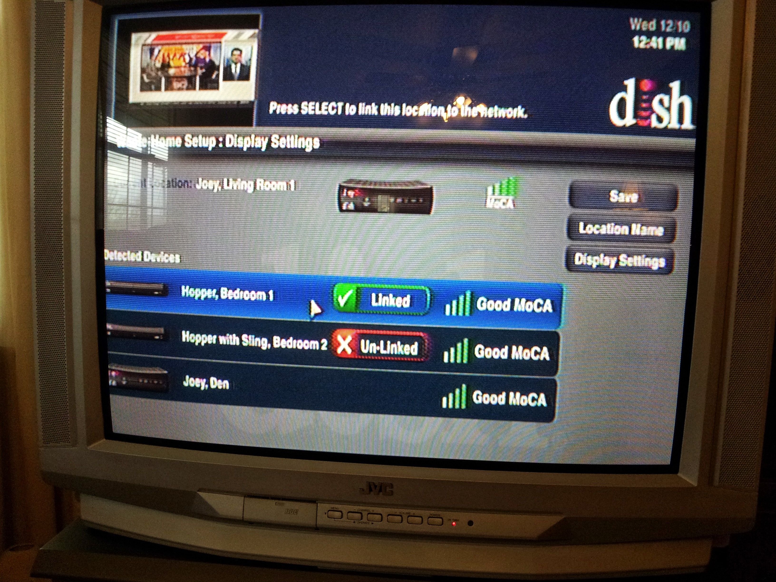

The pic below shows joey moca...

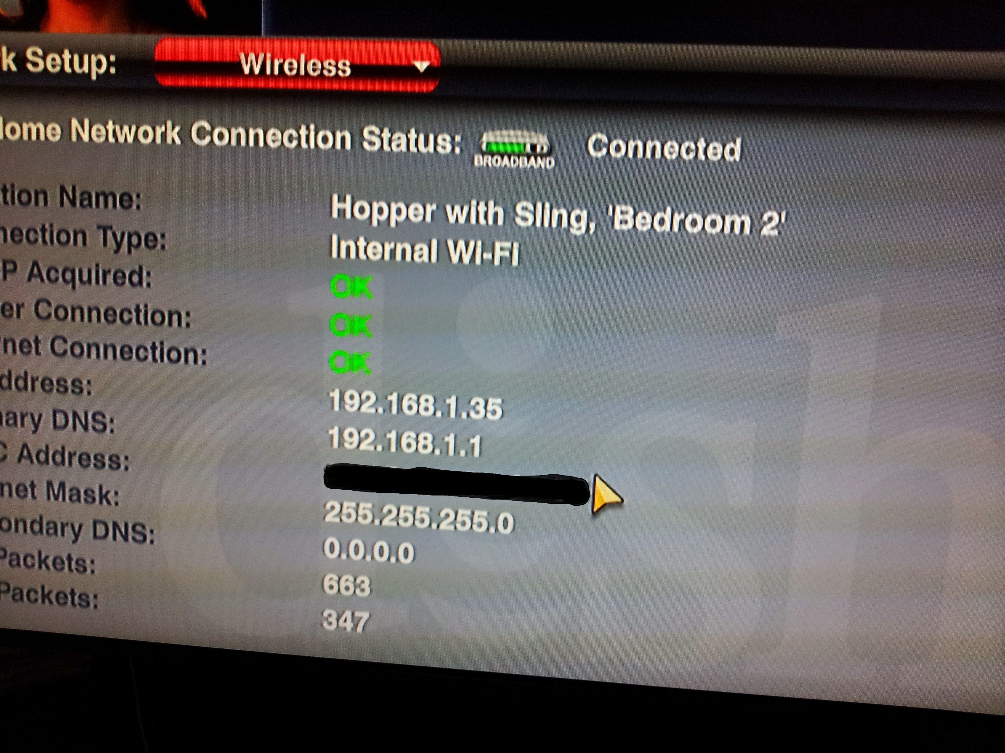

Did notice wifi signal going to hws is only 49. Is that a problem?....also is it causing the hws to reset network settings making it to pull 2 ip's?
How can you tell if it is pulling 2 ip's? The screenshot below shows the status afterwards.
Hit the red button and look at ethernet top and bottom and make sure you don't see green OKs.
WiFi should be fine as long as you keep it above 40.
It shouldnt happen again, so long no one manually sets up a second connection. I'm sure someone hooked up a connection on each hopper or hooked up WiFi then ethernet later on or something. May have been an installer.

Ok I gotcha...even though there is no physical ethernet hooked to the hws...I assume you're saying that is how to see if it is pulling 2 ip's? Ethernet & wifi at the same time.

Correct.
