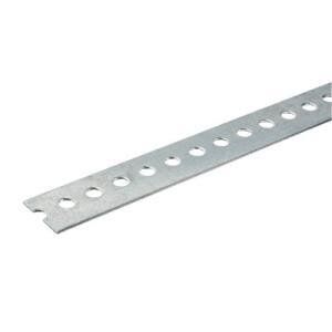

You can go to Home Depot and buy some slotted strap, bend and hope for the best. The proper angle would be hit or miss.

And I dont have a 80cm dish to tell you how far those brackets stick out. If I remember, I think they stuck out about 2 inches in the middle from the dish. You might be able to fabricate something
actually, looking at the diagram again, there is no angle. So it would be a focus point issue. Probably pretty easy for a $5 investment.
.....or wood like the iceberg suggested
