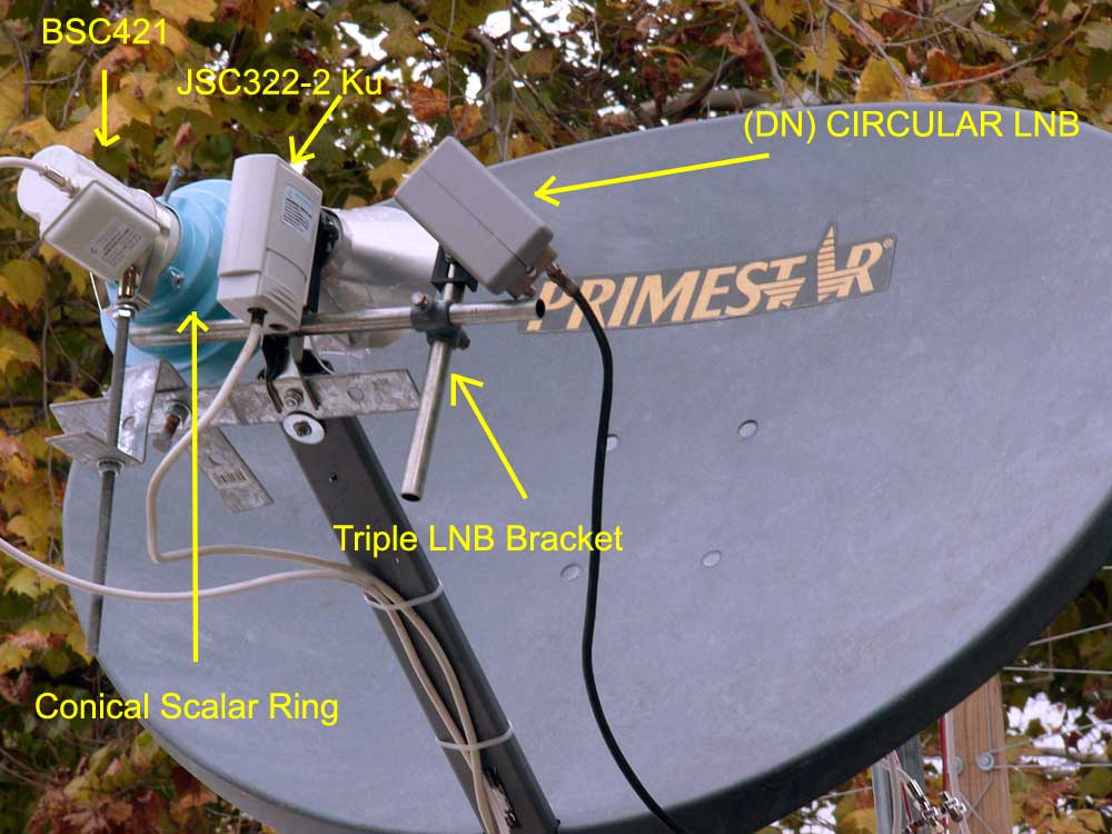

My 741 works great on my 8 footer! When I had my mini bud I put my 241 6º to the side of my linear. A circular lnb 6º on the other side.
The mini is inactive at the moment.
Anole thats what i was wondering with the pc cards if they were just as much of a headache. i am not a fan of anything that is reliant on certain operating system. i was hoping to avoid buying an hdtv and an azbox possibly if an hd sat card would offer some of the things azbox could. if i went azbox and hd which one? there are so many different types i dont know which one is best for true fta. what about the hd receiver sadoun has now for $180 is it as good as azbox? well here is how clueless i am (or a brain that misses things) i never hooked up my diseq switch this whole time! tonight i did and it jumped my qual signals 4-8 percent in heavy rain. i am learning every day. Putney if i try a minibud is there a bracket that has the 6 deg offset or does it need to be homemade?
It's best homemade. The Cband clamp I used is a sprinkler system hanger turned upside down.
Now that I'm remembering my old setup, I believe I settled on a 10º spacing. It made it easier to create new sats in my box. 83º would have to be set up as 93º or 73º depending on what side i was on. I found that USALS worked best for my motor.

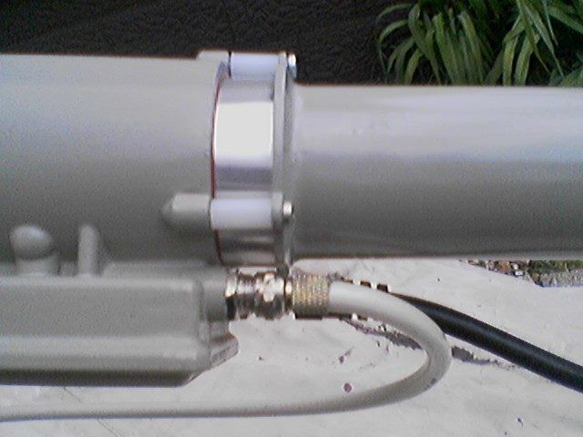

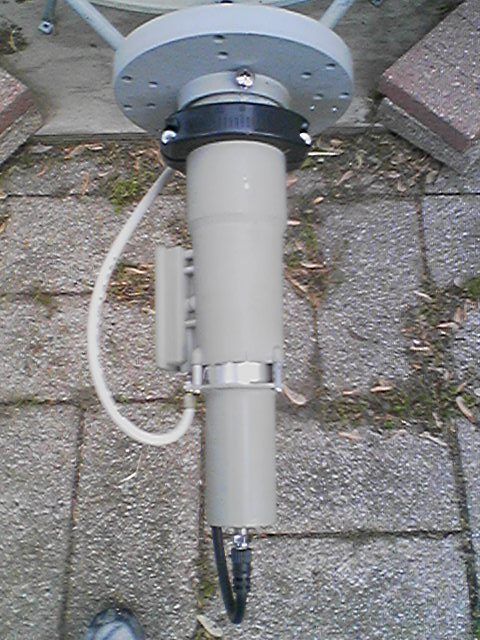

DMX741 / BSC621 Spacer
i doubt i will get much with the dmx on this dish but i love tinkering and will trek to the hardware store to mod the lnb with the spacer.
I "rolled" up some aluminum roof flashing to make a 1/2" spacer. Used super glue and tape to keep it from unwinding.
Both BSC621 and DMX741 now have the same focal length for C and Ku. C band is very good and Ku is good on 1.2 GeoSat Pro dish.

1adam12 i never thought of using homemade metal. i am going to try stovepipe ;aying around to make that offset. it should be fun modifying. did you get the longer screws at the hardware store? i think i might be able to find the same size if possible. what did you use as the spacers for the screws?
Hillman Hardware
If you have an ACE or True Value by you, look in the Hillman Hardware drawers for both items. Poor memory but maybe a M3 22MM long for the screws. They had 1/2" spacers in metal, got the last three. They also had plastic spacers about 1 1/4" LONG so I chucked them in the drill and used hacksaw blade to cut to length.:D
Have fun!
Adam
well here is what happened. it made the 1/2 inch bought the screws and i could get 87-99 at 63-65 percent. nothing cane in despite the settings. so the end of the night i switched back to the spitfire. i made no changes on the dish or motor but now i have nothing locked so i am back to square one. i think i didnt tighten the dish enough when i put the dmx on and it moved the settings. so nothing is locked on any sat with the spitfire. i might just give up on the dmx and do what quapo did and have a c to the side of the ku. but what was cool was locking c at any signal.
