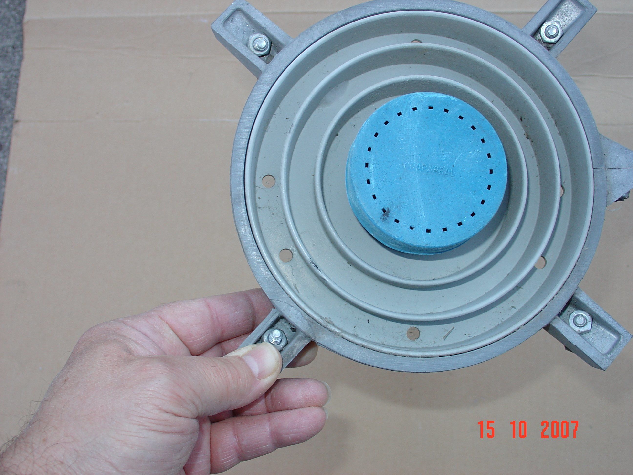

If I remove my Fortec Dish off the roof does anyone know of a way I could use it or modify and mount it to work on my 12 foot mesh dish that I am setting up? On the Fortec Dish the Invacom is mounted on a Arm and Black Ring so it would need to be somehow adapted to my existing 6.5 inch Scaler Ring which now has a Chaparal Feedhorn and Tee-Comm LNB on it. See backside pic of Chaparal Feedhorn and 6.5 inch Scalar Ring. Any replies would be appreciated.

Thanks a lot for the reply gabshere. Finally got the ribbon cable installed and buried from the Dish to the house. Have the Actuator Motor mounted & all wired up on the 12 foot Dish. Re your Offsetting suggestion on my Chaparral FeedHorn and Tee-Comm LNB - do you mean just get an LNB ie a Linear one and Tap and drill holes to attach it to the side of my existing old LNB?
For the BSC-621 LNB at a local dealer I found out it is about 1/3 inch too small to fit my Scalar Ring, maybe I could go to a welding shop and inquire about adding an additional inside 1/3 inch ring and have it attached to my Scalar. Also I was told that the Corotor II FeedHorn is exactly 6.5 inches in diameter so it should fit my existing Scalar unit without any modifications. That link you posted is coming up as an application error - at least from here!!
Sorry about that George - that link you posted re Satellite AV is now working fine - the problem was from my end. I like the price, but how would that KU LNBF be installed?
Thanks George, I also found out today that if I remove the 2 allen keys holding in my Tee-Comm LNB leaving only the plate that fits in my Scalar Ring, then I can replace the Tee-Comm with a BSC-621-2 LNB. May try the BSC just to see how well the Dish works before buying more expensive LNB's.
