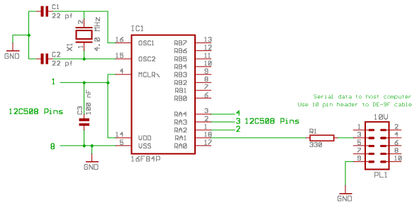

the sw21 is DN's proprietary command switch protocol, see here for more info, including info on making a protocol logger. :)
