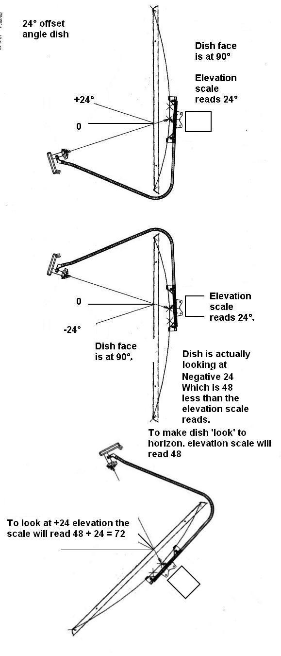

For an understanding of inverted offset dishes:

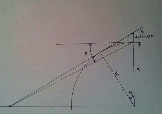

Math contribution for the day...
The altitude you need to get LOS to a satellite that is at an elevation(?) below the horizon:
Radius of earth, R = 3965 mi = 20935200 ft (or use whatever number you feel is accurate for your location)
Altitude = (1/cos? - 1) x R
Distance to Horizon from the altitude:
Distance = R x Tan?
This is for perfect cases, like on the ocean or in the plains.
