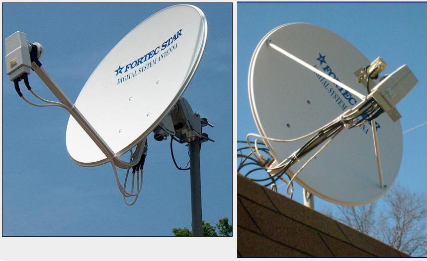

B~man Cons: :down
A bit heavy
Be nice if it had Universal capabilities with the Standard & Circular
Long top to bottom, nice if the connections were out the back well to me at least
AcWxRadar:I robbed the side "struts" off my 1M Winegard DS-3100 dish and retrofitted them to the 76 cm Winegard DS-2076. That kept the weight of the QPH-031 from sagging the LNBF support bracket.
I did the same with mine, took them off my 3ABN dish and retrofitted the "struts" on my 80 CM Fortec Star. See Picture
This LNB would be great for most people with respectable receiving latitudes but not all of us have that perfect receiving spot.
If you are in a lower elevation I would pass on it for it would be overkill for you and the cheaper one Invacom SNH-031 just might be better in the long run.
Sometimes I have read that the really cheep ones out perform this big boy depending on you location!!
It is all what you want to pay for, where you are at and what kind of dish you want to put it on, by far for me, it has been the best one I have used so far.
