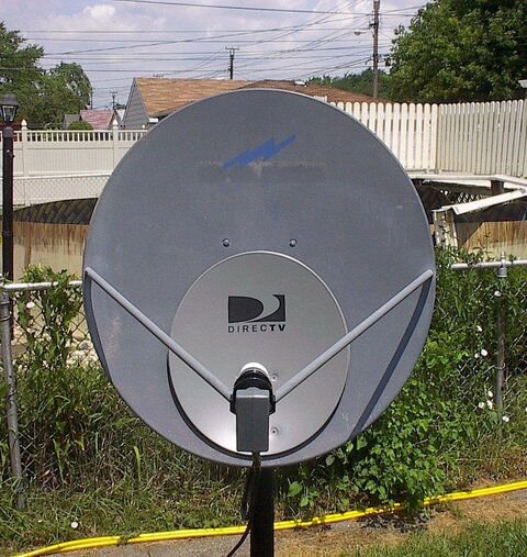

I'm using a 90 cm dish for 101 too, attached is a picture of how much larger my dish is from a stock direct dish for SD. I would think it's large enough but I guess not..
If you are using a dish that large and getting outages that long, something is wrong. I suspect you have a bad or loose connector somewhere, or maybe a faulty lnb that is okay in good weather, but goes out in bad.

I tried 3 different LNBF's and 3 dishes, an 18", Slimline and the Primestar 90cm which is commercial grade. The coax and connections are fine and sealed water tight. I've been installing dishes since 1987. I'm not new to this stuff. I'm telling you it's weather related. It has do do with attenuation of the 12.2-12.7 ghz ku signal and DirecTv using a 6/7 FEC which has a small error correction buffer. A 3/4 FEC would actually improve this but it would make the picture look worse. Direct is stretching the rubberband pretty tight.
The 90 has cut it down to the shortest time but it still does happen. What is the normal outage time during a 2 hour heavy rainstorm for most people whose dish faces into the direction the storms are coming from?
Is the focal point correct ?
With a dish that large you would think the 101 would not be going down unless your in a torrential downpour.
You should put a Slimline up to the other one and see how much of a difference there is, your still gaining quite a bit with the one your using VS the SL though.

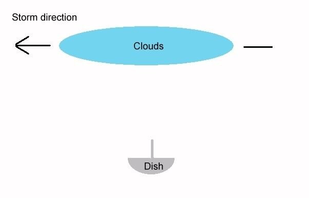

I have the Slimline up and the 90cm Primestar. There is about 5 quality points difference in clear skys. The 90 holds in there better in the rain (it better). I think in Chicago the problem may be at the angle the storms roll through. Most clouds move through at a 90 degree angle to where I'm pointing. Which means that I look right through the large area of the moisture ridden clouds. (see diagram) My Azimuth is 202 degrees and Elevation is 40 degrees.
