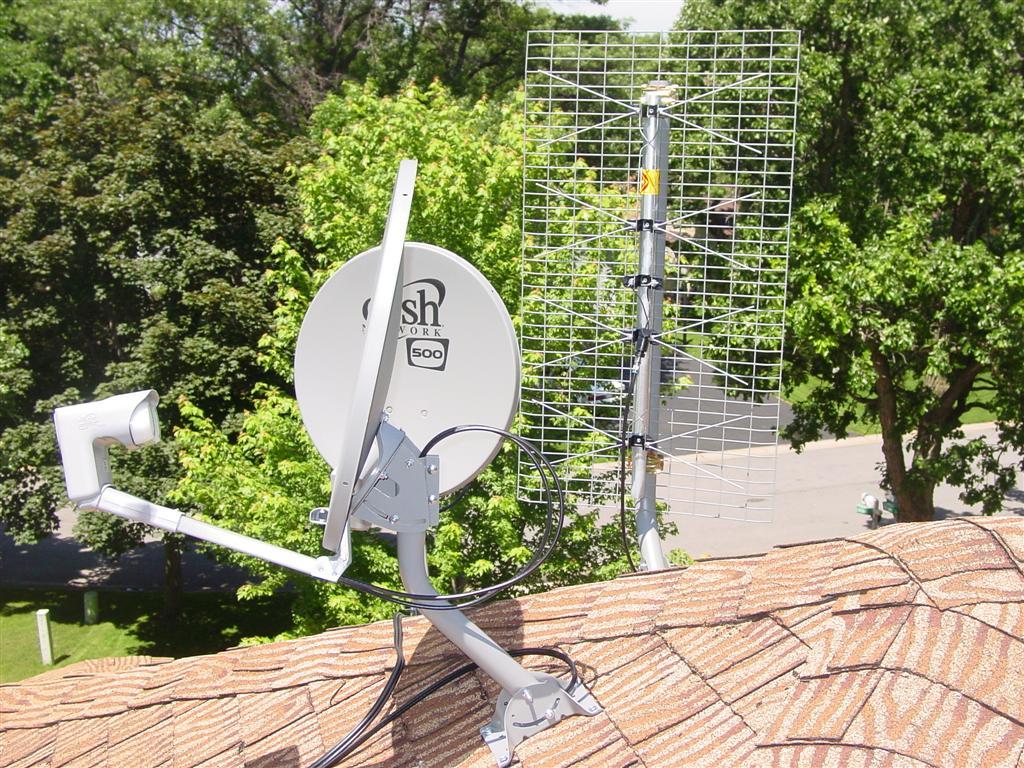

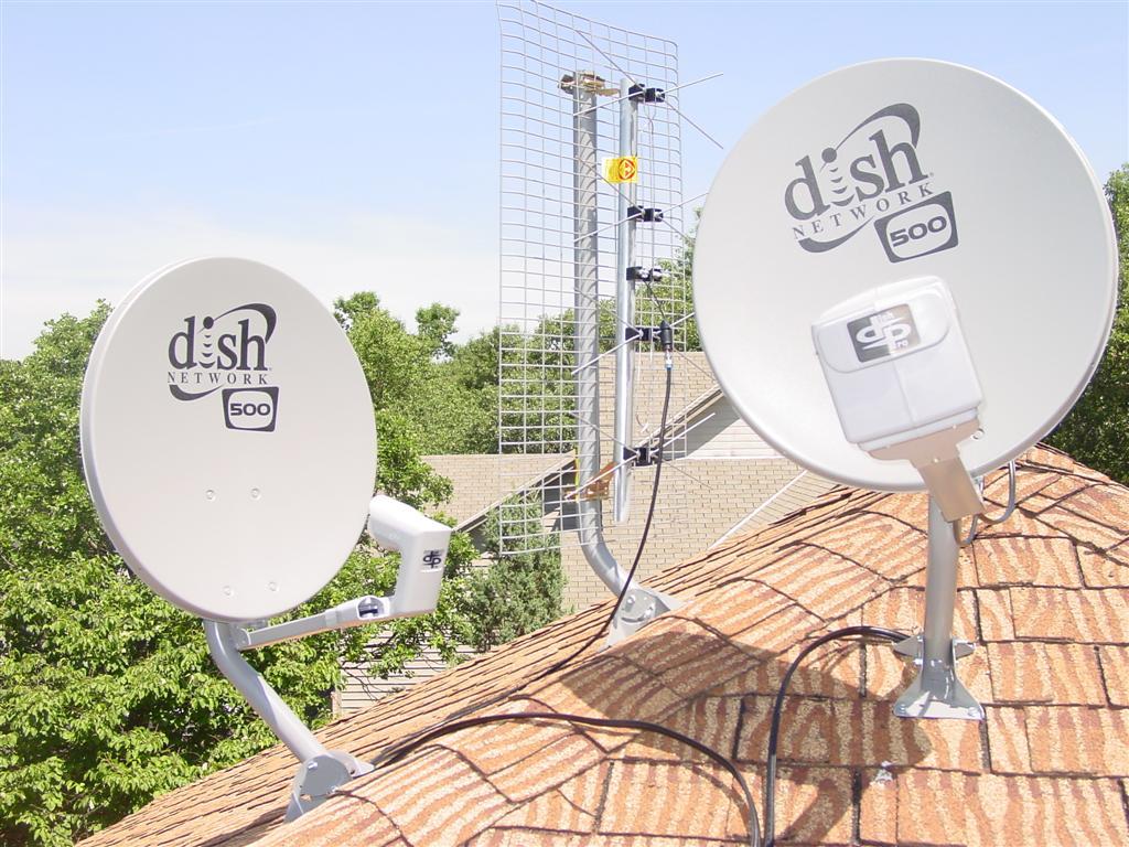

I also think they found it funny to mount the dishs in the most noticeable and ugly place possible from the street. They put up a OTA antenna also (for Local HD) and it is in the middle of the dishs. I actually don't get one of the digital stations well, even though I did just holding the antenna in my living room. My friend thinks it may be a multipath issue or something like that due to the antenna being mounted between both the dishs. I will try to attach a few pics, hopefully this will work.

Also, you have a DPTwin and a DP34 switch? Right? This means the 119 signal is exclusively on the cable from the 119 side of the lnbf to the switch could be a problem, as could the switch. check out connectors, see if water got in there, see if the stingers are corroded and or burned. Make sure that cable isn't kinked or stapled through also.

I'm not sure about the exact equipment, other then the DP34 switch. I have the dish 500 for 110 + 119 and then the dish500 single lnb for 61.5. There is 4 lines /2 cables running down from the roof though (the OTA HD antenna has a feed that gets diplexed into the lines from the switch output)
Is there a picture to give an idea of what angle the satellites actually hit the dishs at? The 61.5 dish looks like its aimed right at a bunch of trees and it gets almost perfect reception. The 110/119 dish looks to be in the clear, but maybe the satellite comes from some weird angle...
The other thing I would complain about and demand to be fixed is the Dishes install. There are supposed to be 6 lags in each mast. 2 in the center holes and 4 on the corners. Also from what I can see in the picture there is no sealent on the masts either. If you can get on the roof and check that they are sealed or it will leak.

It sounds like your connectors are not tight and water is leaking into the 34 switch. Also, I'd make them seal up the lag bolts on the mounts. Even a small leak could develop into a big problem and if not caught right away, Dish would reject any damage claim due to Time.
