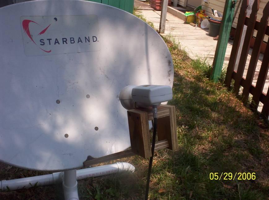

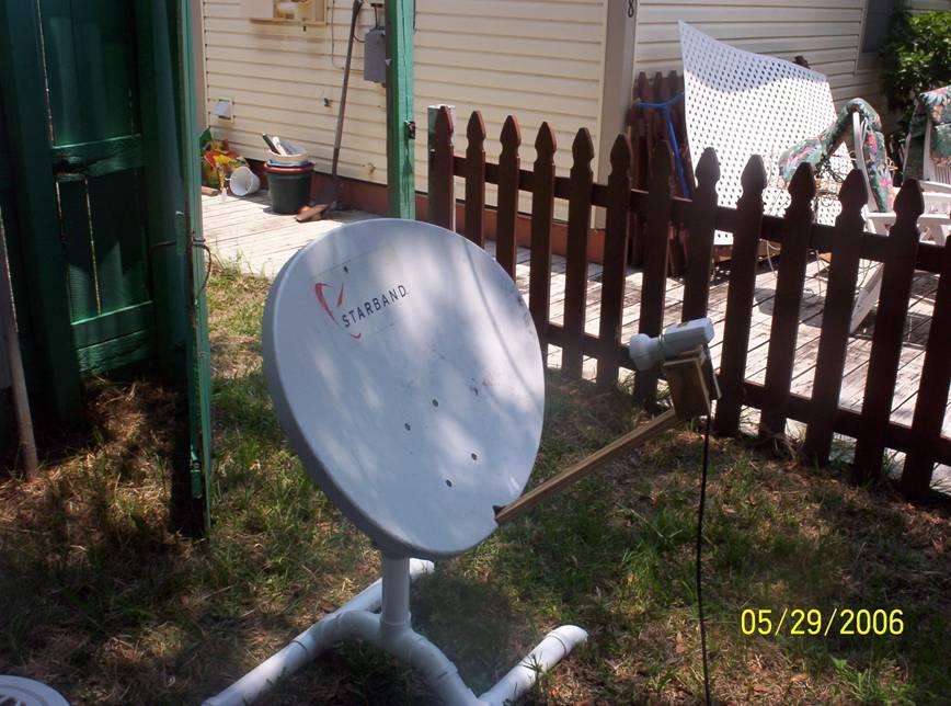

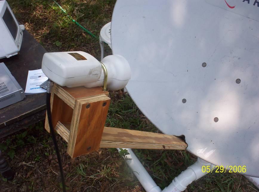

Attached are photos of Larry's setup. I gave him the LNB arm length that I measured on my Star Band dish. Maybe someone can spot what is wrong. I never operated a PanSat 3500 receiver before so I can't help him out too much as far as the settings.

helluva mount for it :) (and a helluva LNB holder) :D
Looks like a Universal LNB so it has to be set to "Universal 1" in the setup
Right off I see there is no way to set skew. Could make all the difference.
if you're trying to get SBS6, you will have to skew the LNB

I think he is on 61 degrees and has his L.O. set incorrectly at 10600 instead of 10750, or some variation since it seems to be off by that much.
Chuck
chuck the LNB looks like a Invacom Universal, so it would be set for Universal (or standard with LO 10600 22k on)
If it's got the original Starband mount on the back the entire dish will turn to skew it. Loosen four bolts on the back and it'll turn. It's not a very smooth movement but it can be set to the aproximate skew and then fine tuned on the lnb. That's how they're set when they're used for Starband internet.
Those frequencies look strange to me. Is the LO set right for the LNB? With all the 20 SRs I'd think this is a DBS sat but then it shouldn't go above 12500. The freq above 12750 is even out of the KU3 band and into the telemetry KU4 band.
Yep it is a universal but some of the freqs are dupes with the L.O. incorrectly set. It sounds strange but it also looks like multiple scans with the L.O. set at a different number each time. If he is getting a strong circular signal from nearby 61.5 degrees and constantly changing the L.O. to another number, then it could account for the high freqs at SR 20000.
