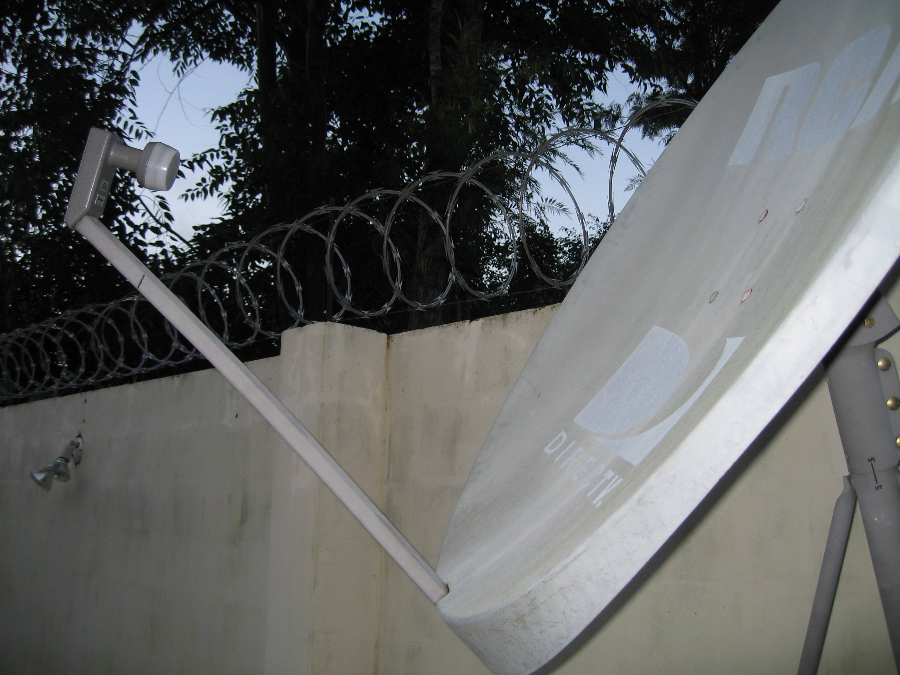

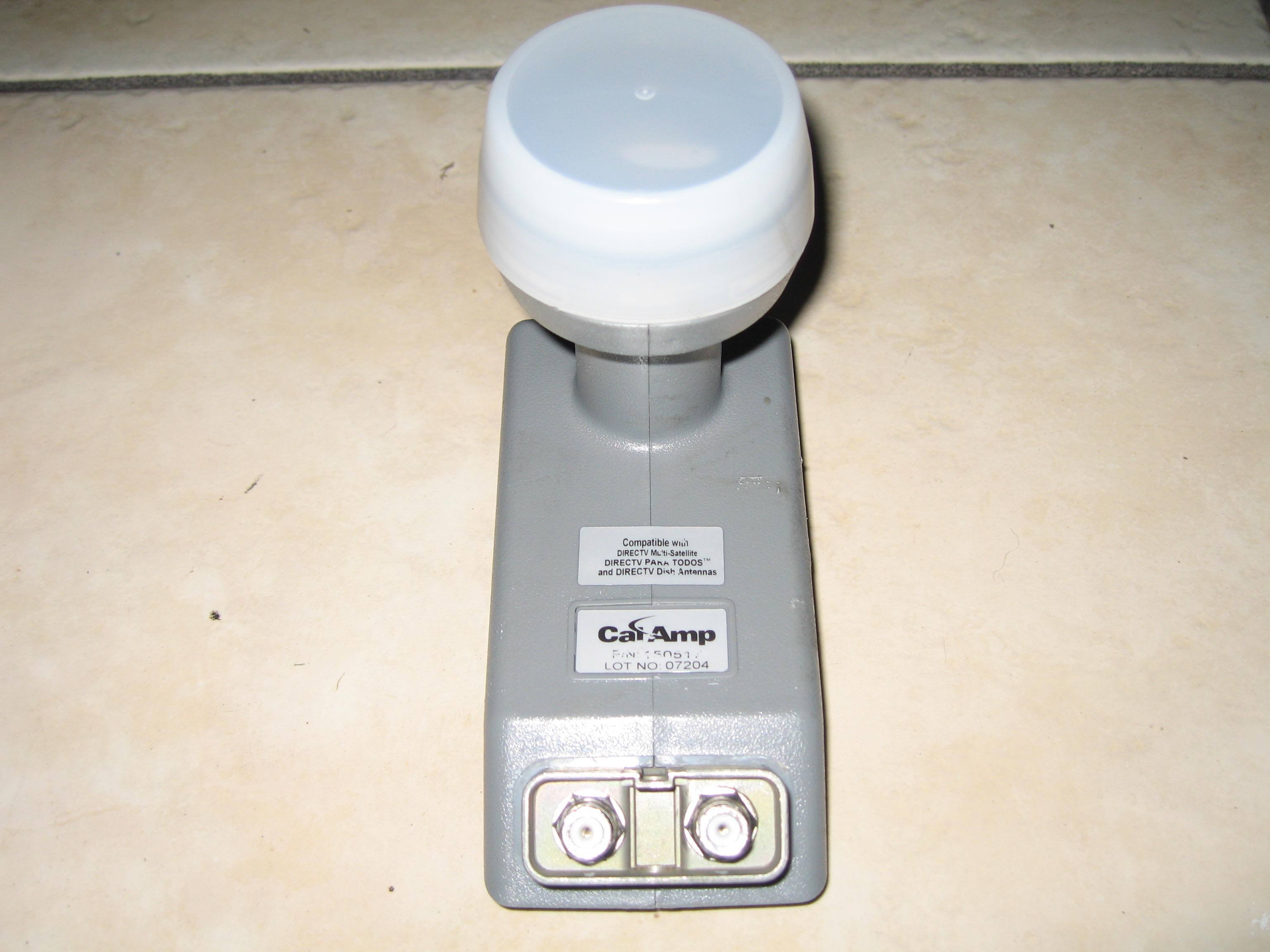

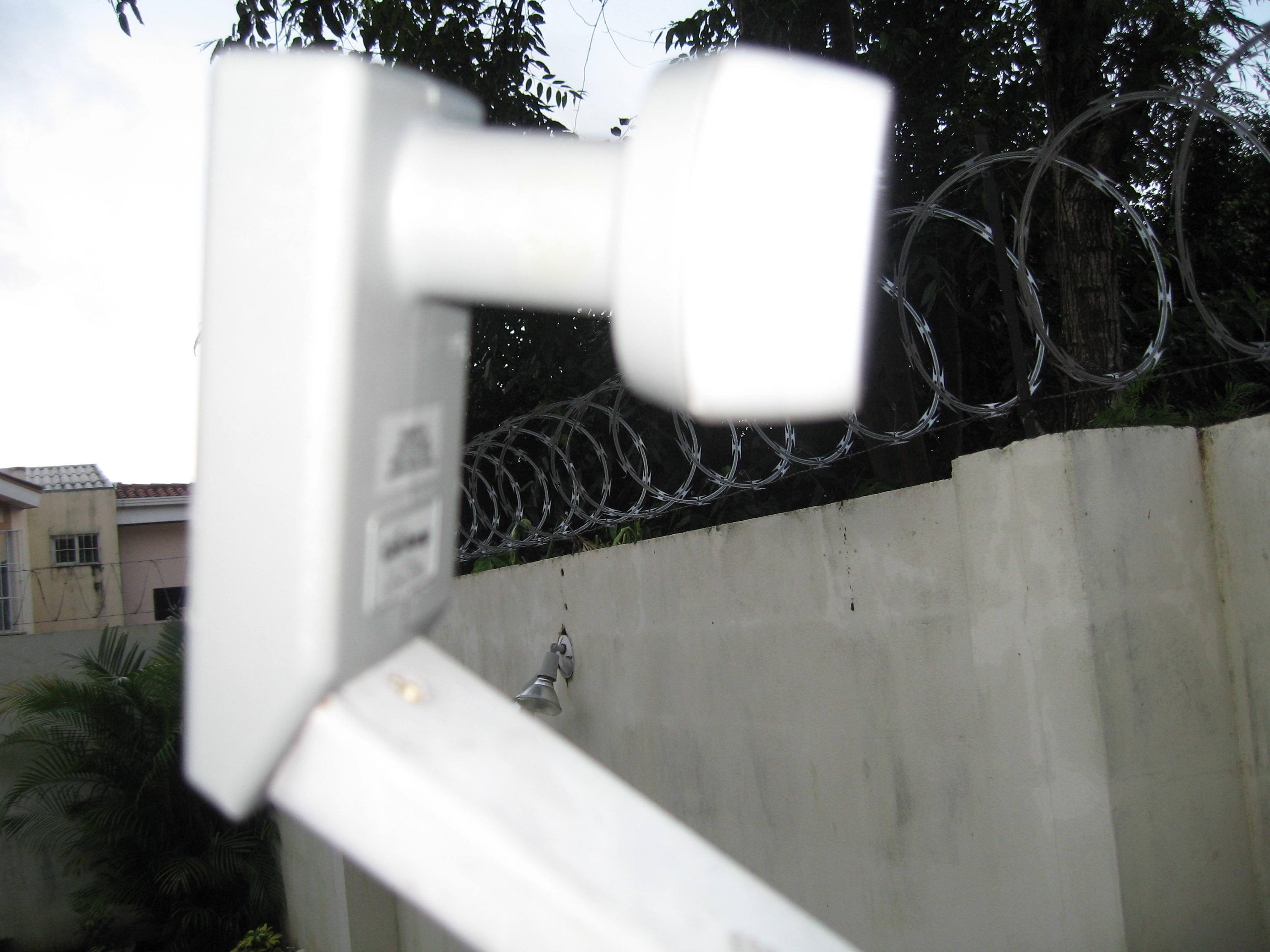

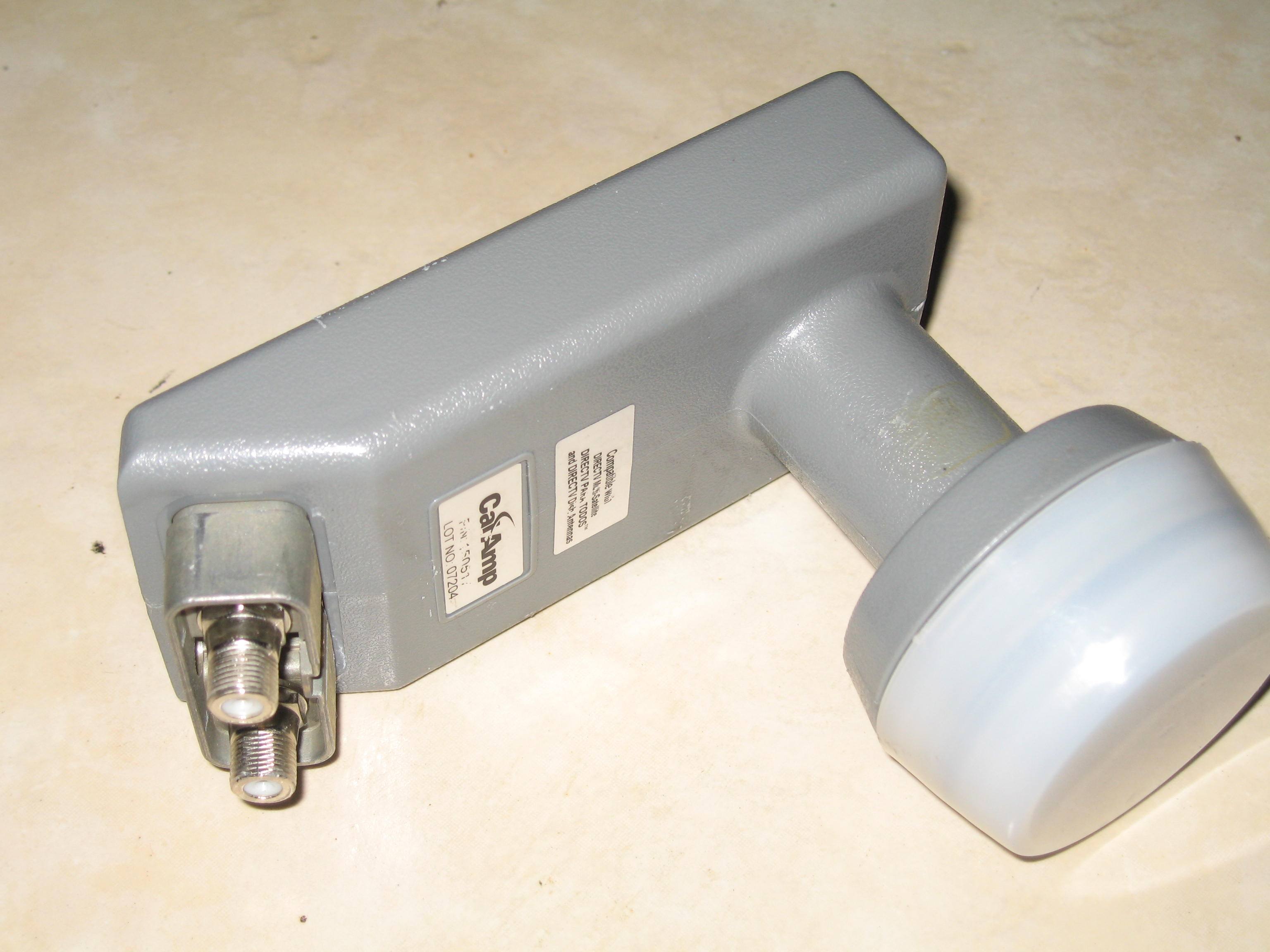

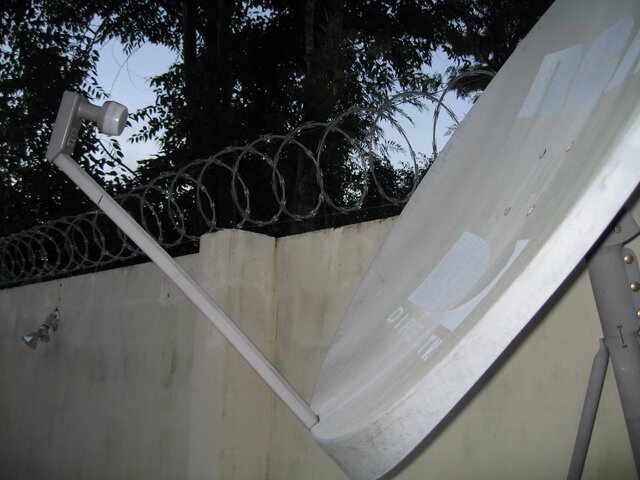

Can anybody tell me how to mounted an INVACOM to the dish like a picture or step by step instructions i have one of those but fail to make it work.
the dish that i have is dtv dish (4ft) with single lnb mount. using at this time cal amp lnb on 119 works ok...! Please need some help!

You would have to modify the support mount, so the feedhorn on the QPH031 is in the same spot (pointing in the same direction and the same angle and be at the same distance from the dish) as the DTV lnbf. Not an easy task, but do-able? You would be better off to get at least a 30" dish for the QPH031 lnbf. Good Luck..!
Thanks guys i tryed to do that but with zero luck. The dish size is 4' 1/2. any other suggestion on what i can do to make it work?
Thanks for your time!
It will works, I'm assure you - signal level and quality will be in high numbers.
You'll need custom holder for Invacom LNBF what will hold it in same position ( throat and cylindrical part) as your original DTV LNBF.
You can't use missey's idea - your dish's focal point and a line to center of your dish is higher.
Thanks for all your time i will try that and will get back and i will report back!
I would temporary use duck tape and wood bricks just for hold the LNBF in correct position for few days while tuning it and checking signal improvement.
Then replace to metal parts later for normal using the dish.
