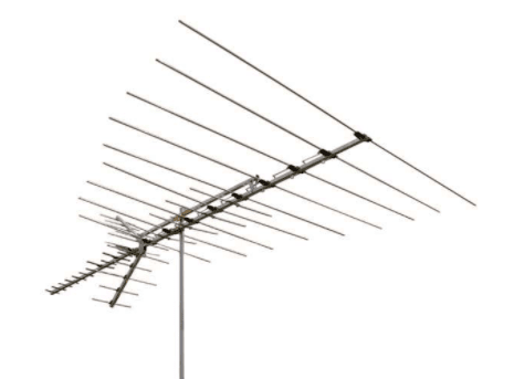

You did not mention what antenna you are using, you need one with good gain on VHF high band since of course WTLV is on VHF high. I would guess your attic antenna is UHF only.
907, I'm not sure of the model number. It looks a lot like the one in the attachment. I'm not at the place now, but can check in a few weeks.
