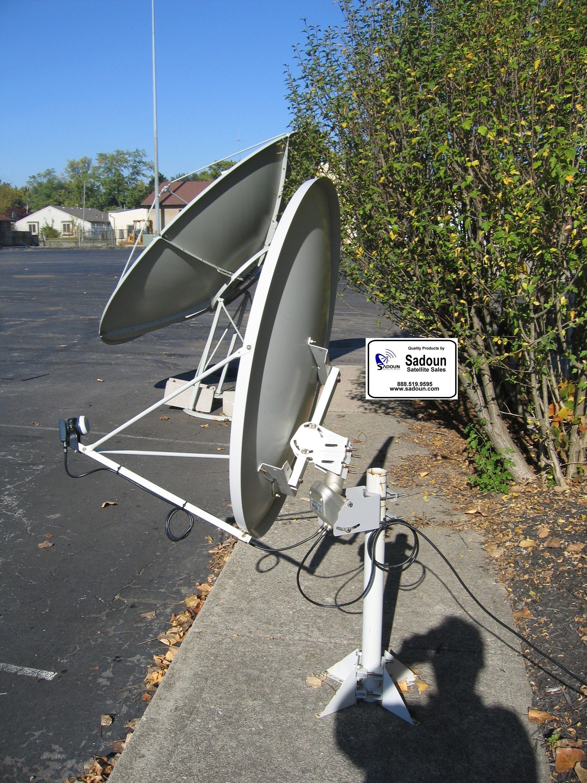

fortec 39" dish & sw-21 switch
buy yourself the fortec 100cm dish at sadoun and the sw-21 switch to combine 91/82 into your IRD. where do live exactly, are you in north dakota? 91W is left LNB while 82W is right LNB. i hope this helps. :angel:
