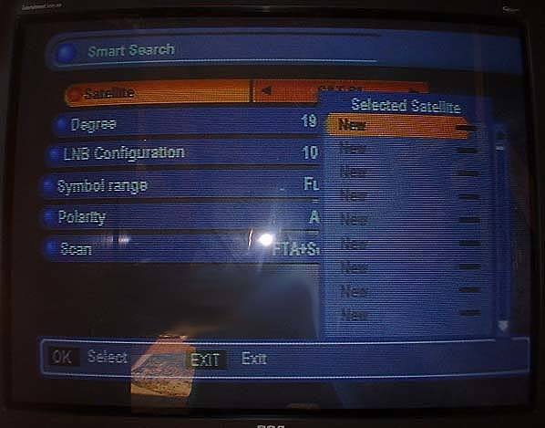

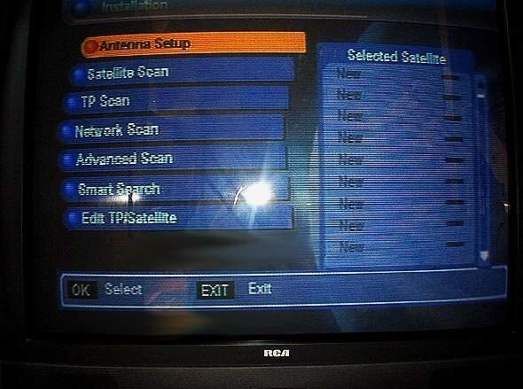

Picture 1, this is what I see after I put in my password. As you can see it shows "new" satellites on the right as selected satellites.

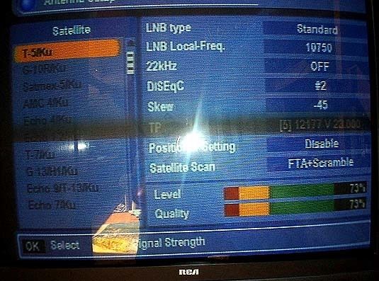

Picture 2, this is what I get when I go to antenna setup. I can scroll through the listed satellites on the left but it will not let me select one. Even the two that I am watching are not selected.
Picture 3, This is the smart search screen. When I select satellite, this list comes up. If I scroll through this list, it shows a lot of "new" along with the regular satellites and some of the regluar sats are listed more than once.

In picture 2, you have to select a satellite and set it up
Pick a satellite and press "OK". This will move you to the right side of the screen and check mark the satellite. Until you do that, nothing else will work :D
Depending on where your dish is (lets say T5), select that, set the parameters and exit out. Then do a smart scan :D

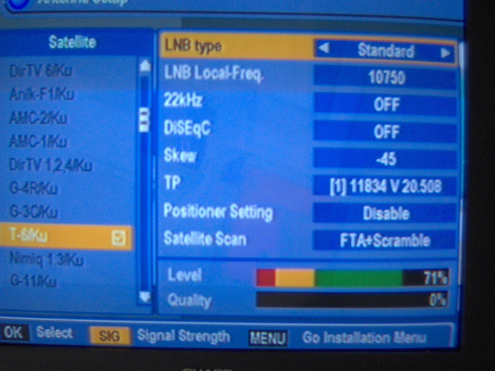

like this (this is on my 3500, but its the same jist)

Thats the problem, it won't select. I've used it in the past with no problem, but now it won't work. I set up G10 and T-5 with it. I can scroll up and down the list but no matter what I try, it will not let me select a satellite.
what happens when you select a satellite and hit "OK"
have you tried a hard reboot (turn the unit off via the switch on back)
last resort might be a factory reset

When I hit ok it doesn't do anything. it acts as if I didn't hit anything.
I've tried the hard reboot, no change.
I've done the factory reset, all that did was delete my channels.
What I can't figure out is where did all the "NEW" s come from on my list. There are probably 50 of them :confused:
Under selected satellites in picture 1, it used to just show G10 and T-5, now it only shows "NEW" :confused: :confused:
In the first picture, new satellite would change to whatever satellite you selected (if you could)
