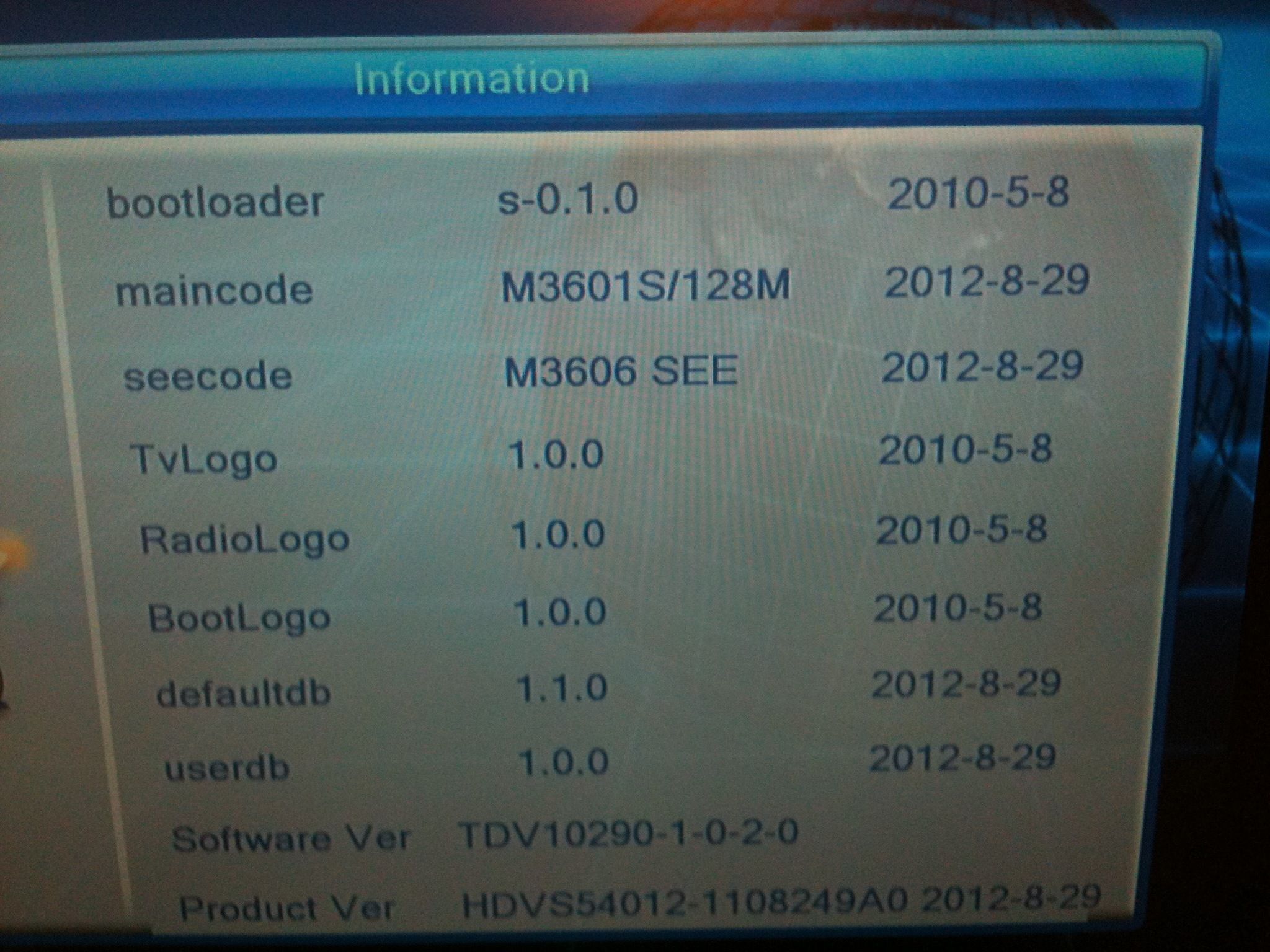

After a few months (about 5 months I think) of stellar service I have to say that I have discovered one very annoying (although minor) thing the µHD does..
I have a disk plugged into it and I have it connected to two dishes, my 10' C-band and a motorized KU dish.
For some reason the KU dish is a bit twitchy. When the wind blows the dish whips about a little and I lose signal.
If the dish has been blown and doesn't have a signal locked when it's time to start a recording, well, nothing happens.
It can't record because there's no signal. And this is where it messes up. When the scheduled, recurring event can not take place, the
µHD erases that event from it's scheduled tasks.
I have it record Harveytoons twice a day at 2pm and 10:30p, every day, 7 days a week. I also have it record Wolfman Mac and Offbeat Cinema every saturday and Laurel and Hardy every Sunday morning.
Lately we've had some wicked winds so several times a week I have to go back and recreate the scheduled events and it's quite annoying.
I took a picture of the event schedule and saved it on my tablet so when I have to fix it I can pull that photo up and reenter things.
It would be nice if you guys could fix the firmware so that it will stop erasing schedules on failed events. It would be awesome too to have an option to save recording schedules to USB and restore too of course.
I don't usually check it every day so sometimes it may go a week before I find it's messed up again and have to fix it.
That's really my only (minor) complaint about the thing. Everything else about it is just awesome! And this thing, it's not the end of the world, I mange to deal with it.
Now watch, someone will tell me there is some simple thing I can click to lock the schedules in place so they won't erase on event failure.. :eek:
Thanks! :)
Thanks! :)
That erasing issue was fixed in the (I think) 3rd to the latest firmware, and I believe once a feature is introduced, all newer firmwares should also have it. Single use timers could erase, but re-occurring ones should NOT.
Yeah, here is the firmware where that was fixed: http://www.satelliteguys.us/threads...e-(OTA-SSU)-12-20-2012?highlight=New+firmware
What version or date of firmware are you running?
Oooooooooooohhhhhh!!!!!!!!!! Ok.... This is good to know.
I am not sure what the tuner is running at the moment so I took a picture of it with my iPhone (I'm lazy today).
Seems like when I first got the thing I upgraded the firmware via satellite but there was something changed about it that I didn't like so I reverted it back to the firmware that was originally on it.
Since then I haven't touched it.

Dee_Ann, That is original factory firmware.
If it's not broke and you like it... Don't change it.
If you would like the fixes and upgrades added since last August, you are due for an upgrade! :D
Here is a link to the USB file and upgrade notes: http://www.satelliteguys.us/threads...-USB-and-Satellite-Update-(OTA-SSU)-2-27-2013
Honestly, I do not remember what it was that I didn't like about the upgrade that was available at that time. But because there is a fix for the particular problem (and ONLY problem) I have found with the tuner, I'm going to take y'alls advice and upgrade it. :)
What ever trivial issue I had before was, trivial.
I'll give it a whirl later tonight and then it will probably take a week or so before we have winds strong enough to mess with the dish and mess up recordings.
Losing a recording here and there, eh.. Not the end of the world. Not having to reenter the schedules every time the wind blows, priceless.. :D
