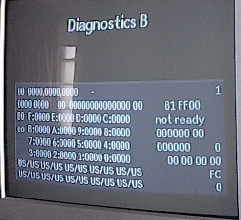

I'm not sure if it will download maps but even if it does the EMM is wiped out and cannot be set so it just searches for signal. The one that is toast here I am going to experiment with and see what happens if we try some loading of the info from other receivers with good EMM's down the road.

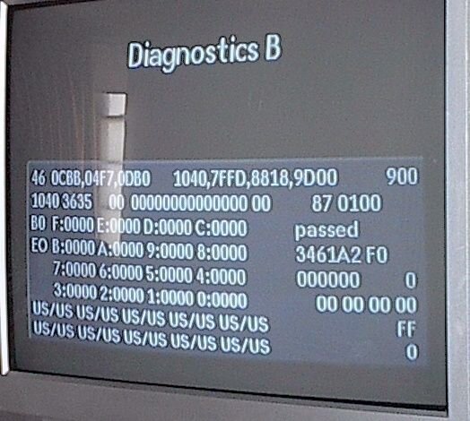

I don't know if I should say this in an open area but what the hell... This is what I know. The XC chip contains your personal working key and UID which allows you to be subbed. When the 4DTV is powered up first time at the assembly line the XC chip loads this once in a ram area backed up by a battery. When the battery dies so does that info. The XC chip spits any numbers it wants after the battery dies every time you power up. The number is no good and since there is no EMM it don't work. So unless you could force an EMM into it and get a lock on DC2 again not even Zk will work.
Good 920 vs dead 920
See pictures attached. Looking at diagnostics B there is no EMM provider no monthly working key and a bunch of zero registers. first picture is Dead 920 second is Good 920.
Since you cant hit the box because the UID is no good it can't load those registers and make the box work.

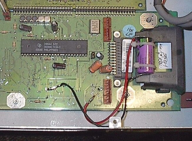

I just finished swapping another test 920's battery. I took more pictures so I have a bunch to post with details on my site. The unit survived the operation UID intact :). took all of maybe 20 minutes. Once you do it it's like riding a bicycle. Heres a picture of the finished battery installed.
BTW the original battery had a 1995 date on it, and still showed 3.6v amazing.
