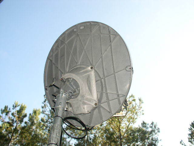

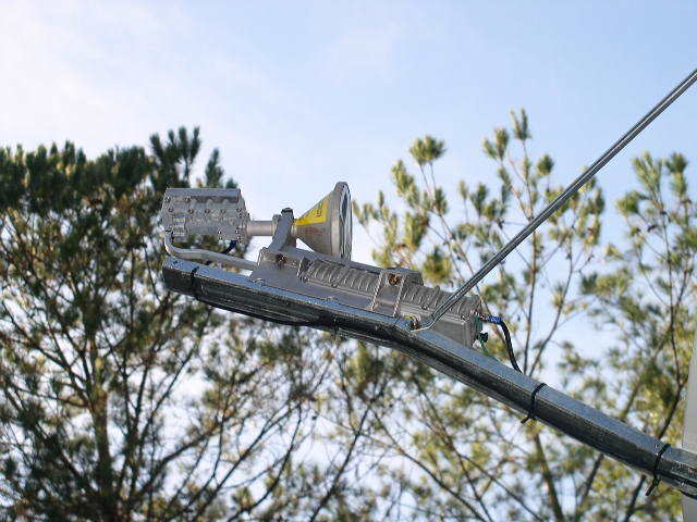

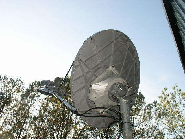

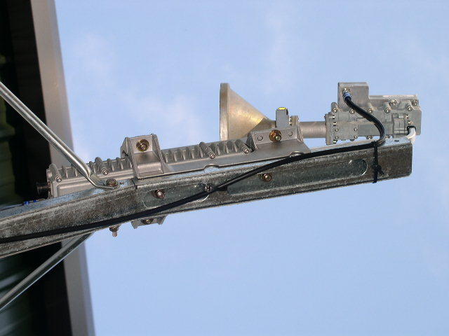

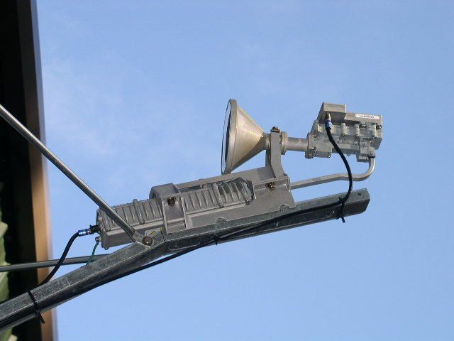

:) are you doing the install for profit? that would make a major deference. i don't think hn cares were or whom you sell or install. as long as your cert with them for basic installs. other than basic building codes. the placement of the dish should be totally out of reach in the center of the roof. you know kids! as far as wires although not necessary i would run conduit just to keep it safe. and i would go over board on grounding the dish wires and modem with a surge strip. typically a .98m dish with 2watt trans mounted on a non-penetration stand. but if your going for a massive network you may be up in the 1.5m-3m dish range with totally differant equipment. hope Tate can give more advise I'm going to get the phone number for my local bus dist and see what they can offer.
Its going to be a Commercial Job but not an Enterprise Job. It will have just a basic 7000 modem which is now the HN7000s, If you have not taken the test on this you need so @ http://elearning.hughesnet.com/Login/index.aspx
A commercial job is just like a residential job only in a commercial establishment or in a home office. A Enterprise job is one that requires the additional training for and will be business like Walmart, Cheveron, etc. The Dish will be a .98 with a 2 watt antenna. A credit card will still be required to make the order and most of the time in a situation like this someone in the administration office will put the account in their name and the establishment will reimburse them for the equipment. Since this is a school and assumed a government facility....you got me on how the account should be set up. After the equipment is installed they can receive a paper bill.
As for the insurance/license check with the establishment to see what they require. We put a system in at the Winchester plant were all the .22 bullets are made and they required us to put their name on our liability insurance and we charged them for it. We also had weird rules like we could not put a ladder against the building and we had to check every tool in and out. I am sure a school will not be that extreme.
As for all the computer hookups you will need a switch.
http://www.linksys.com/servlet/Sate...899770&pagename=Linksys/Common/VisitorWrapper
Don't use a hub.
check some of this stuff out.
The .98 dish will require a Vertical Shim Kit also.
