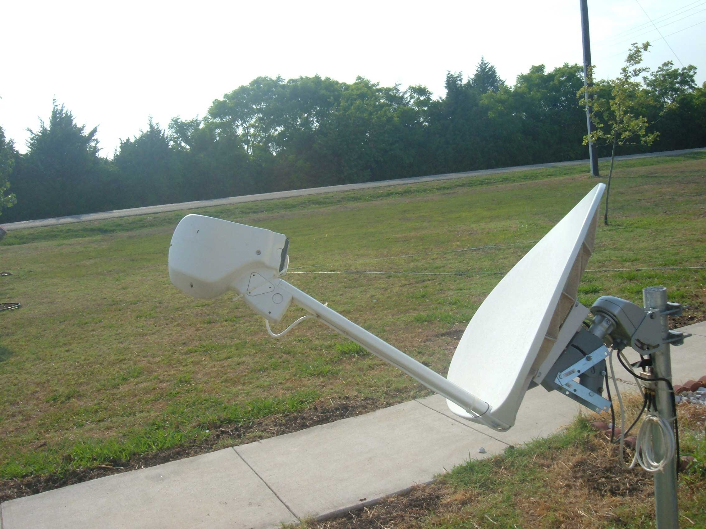

The Original Dish
This is a photo of the original dish. Notice the big white box at the end of the feedarm. That is called the LNB shroud. The Feedhorn and the LNB itself are concealed within that box.
It is easily removed with a few screws.

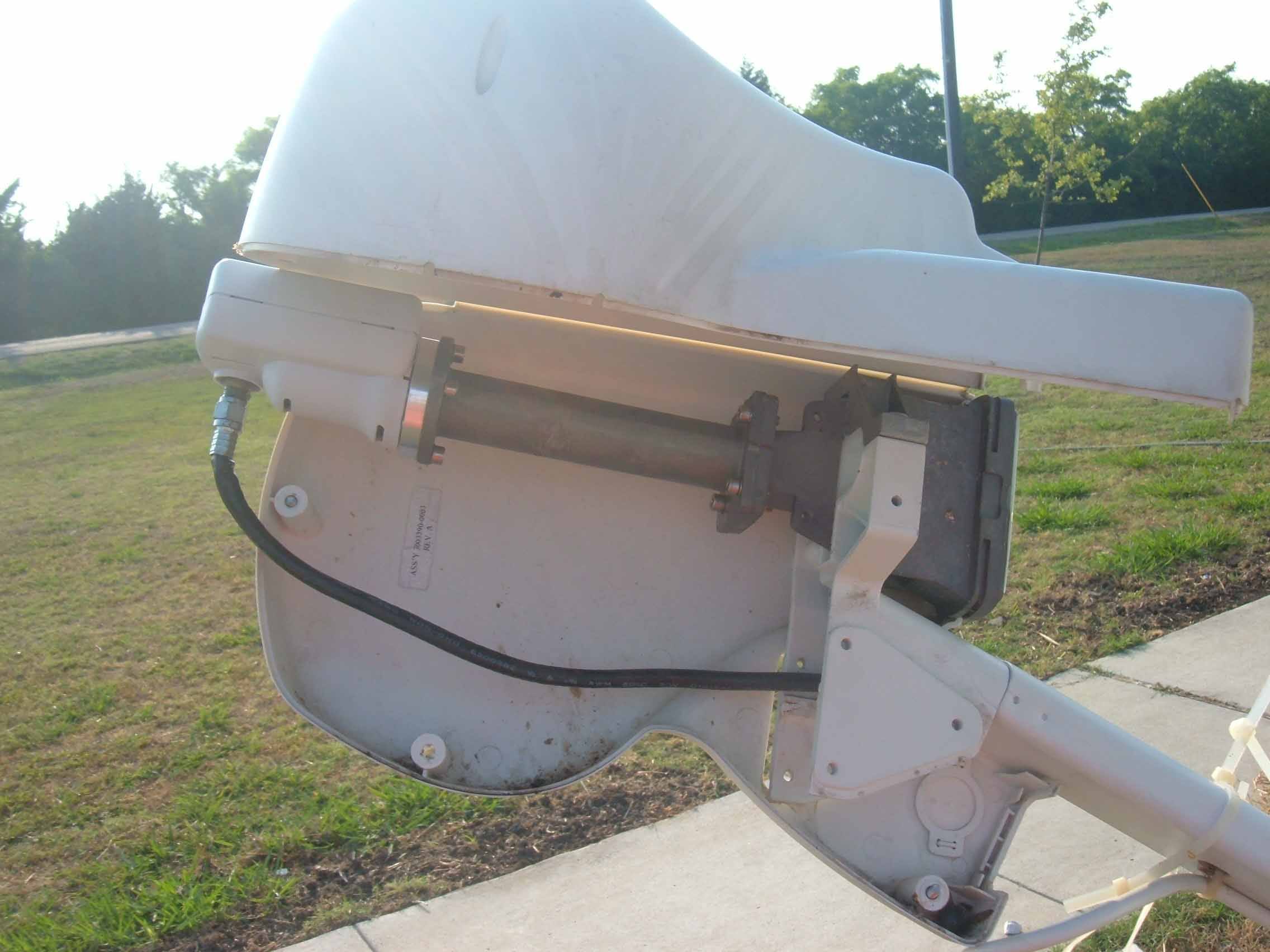

Dish with Shroud Removed
This is the dish with the LNB Shroud removed.
The white piece at the very end is the LNB. It is connected with 4 machine screws to the Feedhorn, the long, narrow, grey metal tube.
The LNB and Feedhorn are securely mounted to the dish with 2 machine screws.

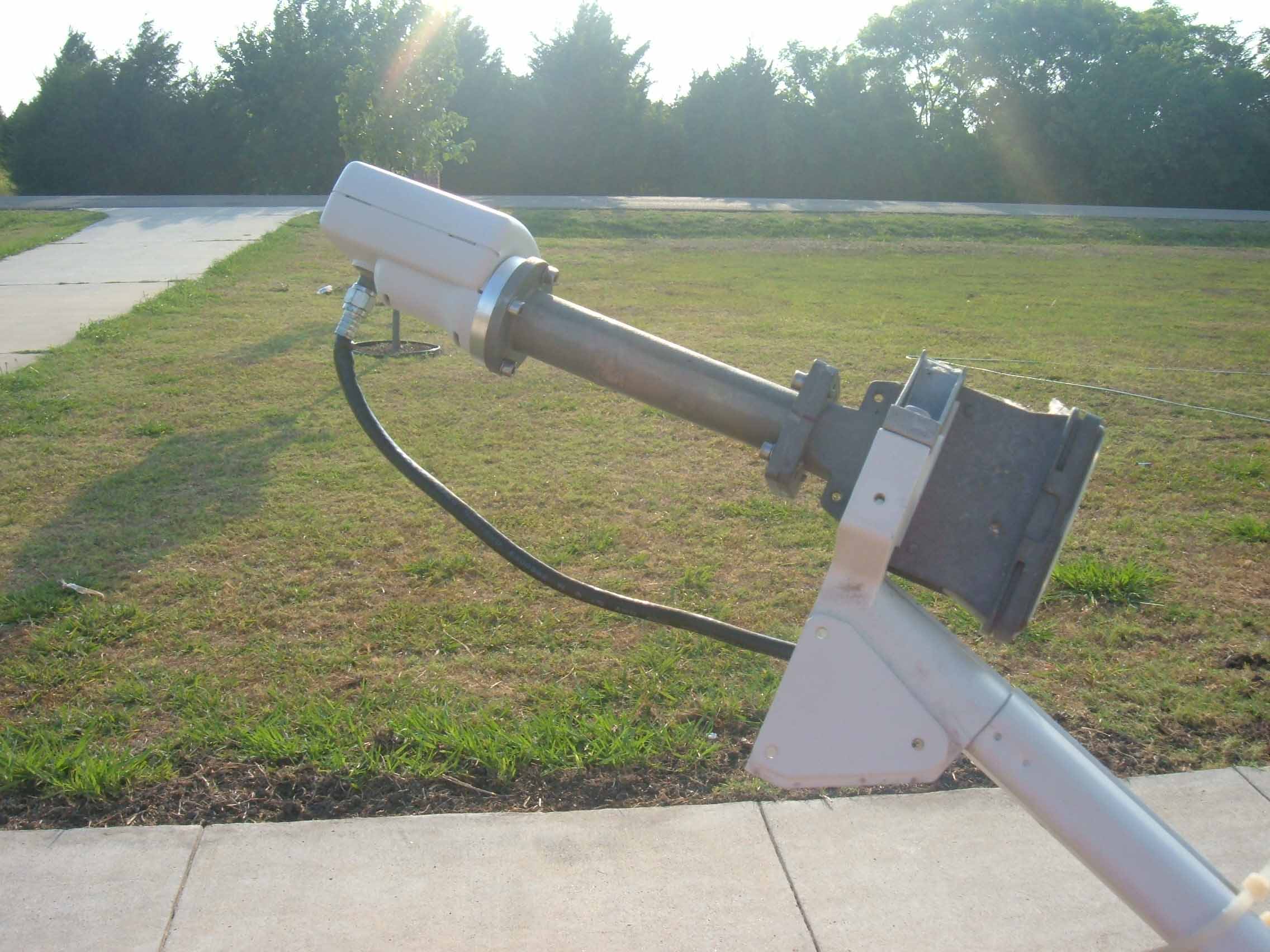

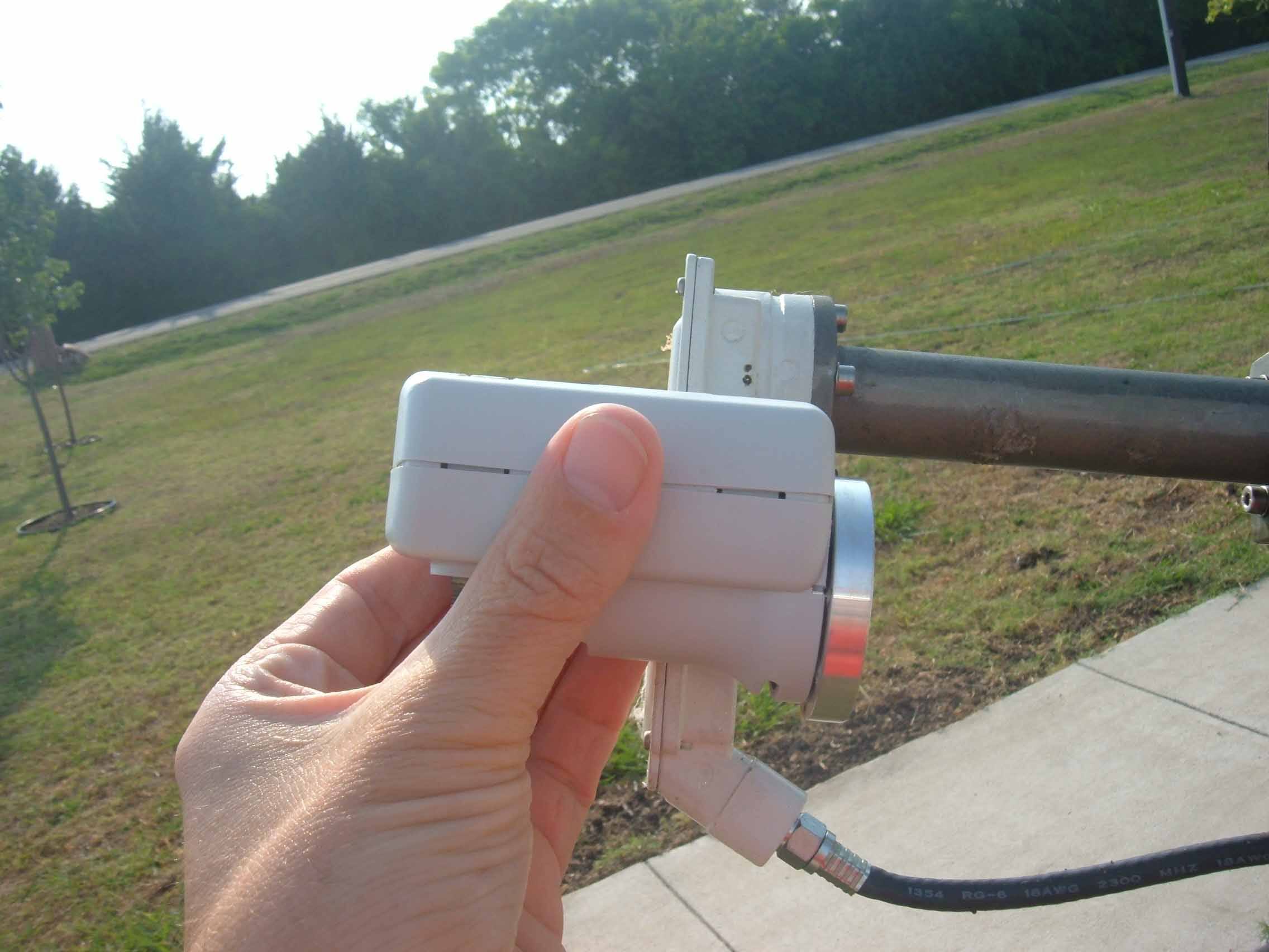

Close Up view of LNB
This is a close up view of the LNB mounted to the feedhorn.
You can clearly see the machine screws that mount the LNB to the feedhorn

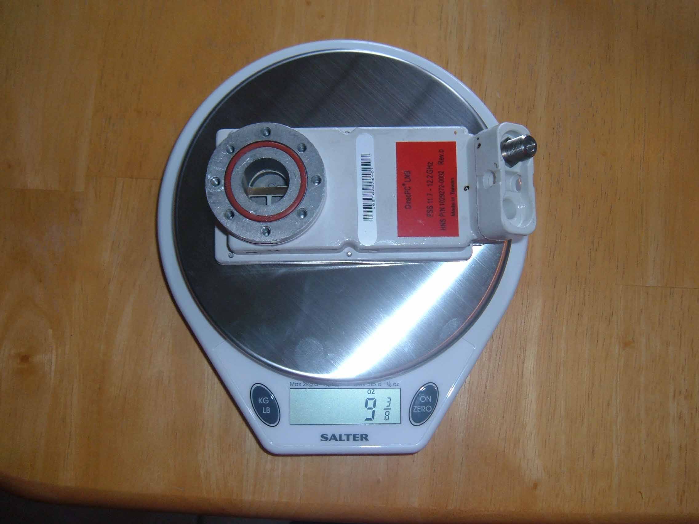

Picture of Removed LNB
This is a picture of the removed LNB sitting on a scale, so you can see the weight.
Of note are the 8 mounting holes. This is typical, if not standard, for a C-120 connector. If you look at the picture before, you will see the DWAY Feedhorn only uses 4 of the 8 holes for mounting.
Also noticed the rubber o-ring. Also typical of C-120 flange connections, and seals water from entering the LNB.

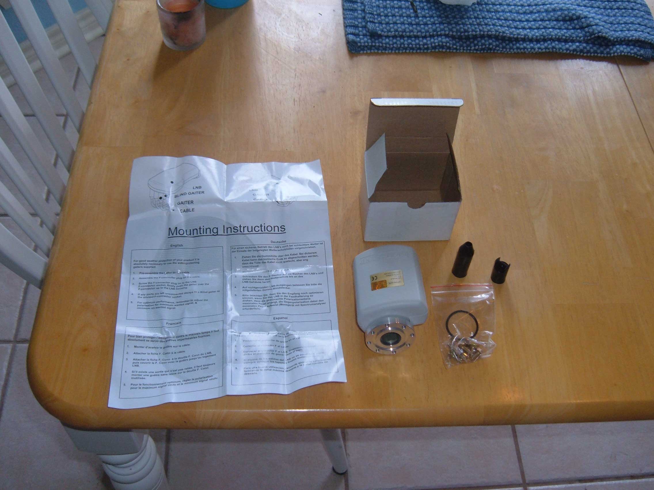

Snf-041
This picture shows the contents of the box of the replacement LNB, and invacom SNF-041.
Has a detailed instruction sheet, the LNB, weather-proof connectors, 8 brass screws, and the rubber o-ring.

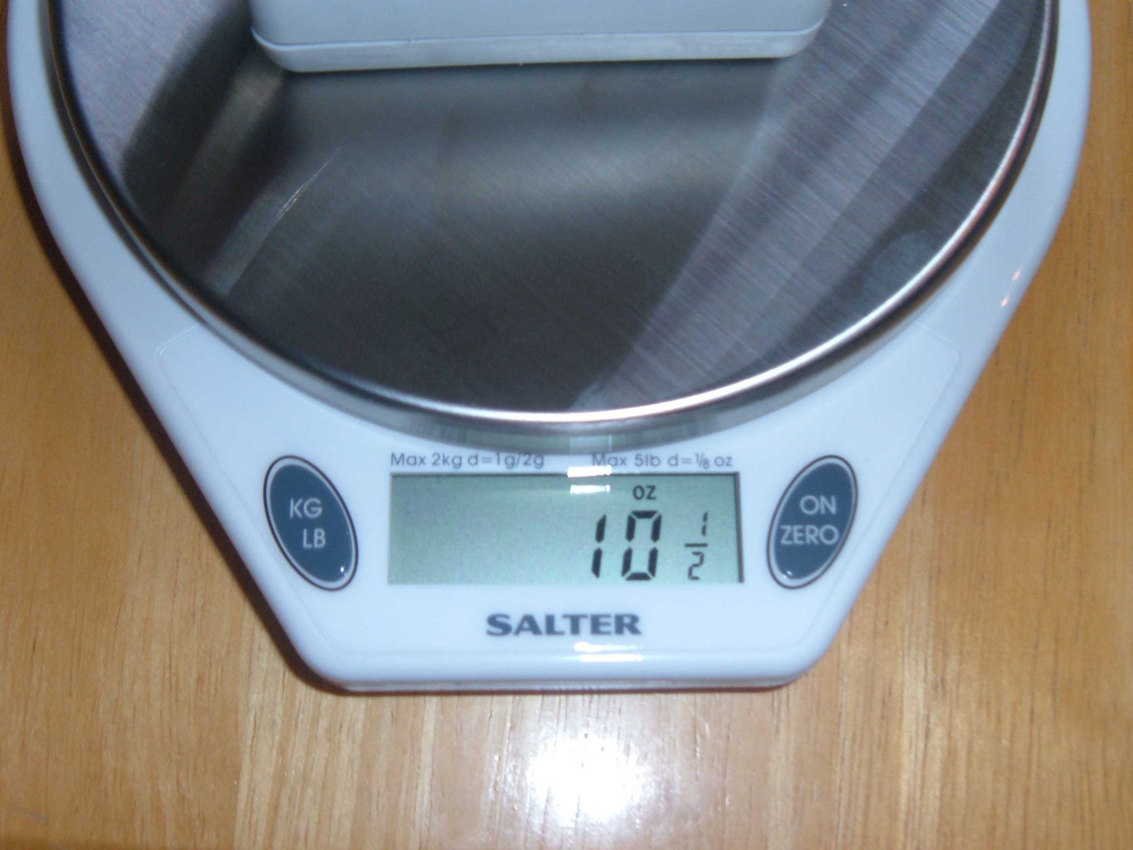

Weight Comparison
This picture shows the weight of the SNF-041. Notice it is about 10% heavier than the old direcway LNB.

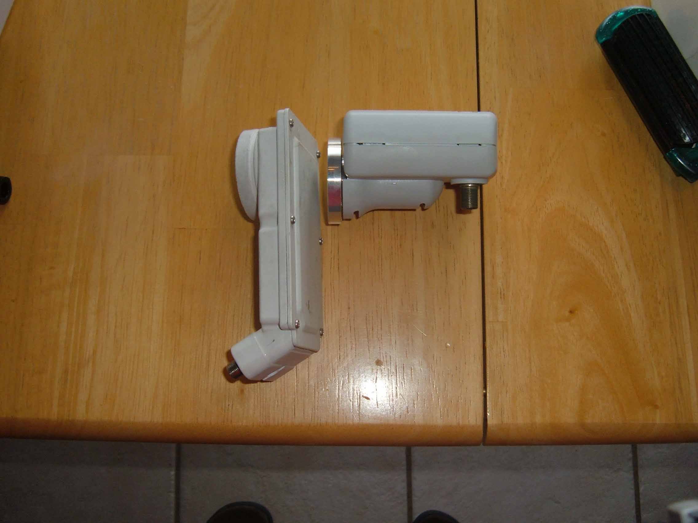

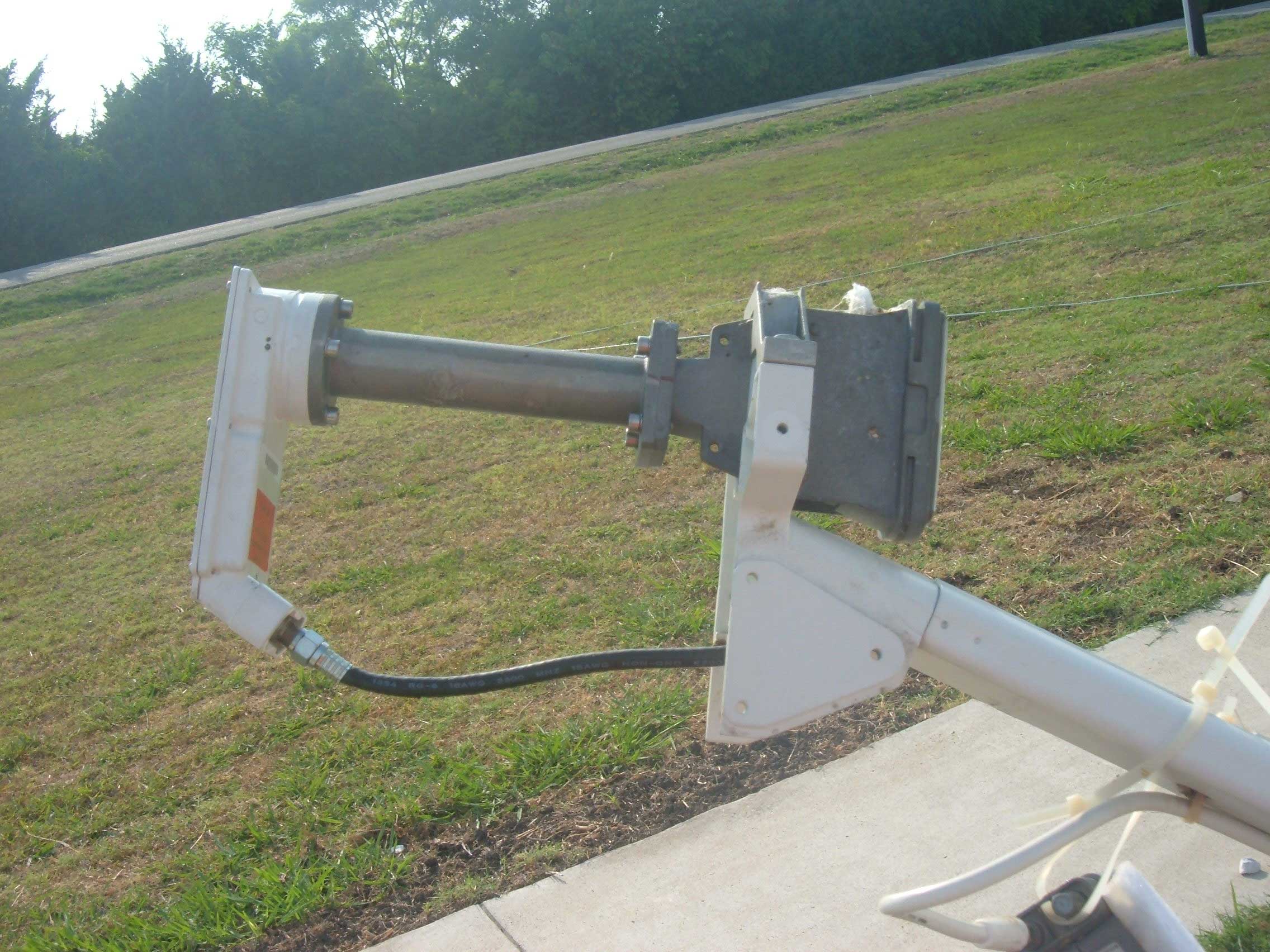

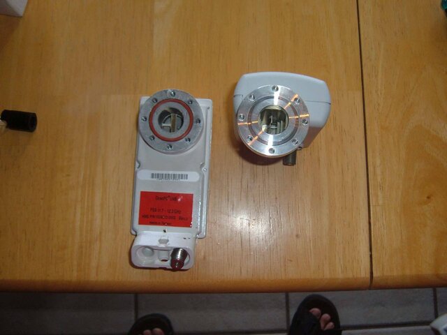

LNB Comparison Pictures
The direcway and invacom LNB are very differently shaped.
Here are a few comparison pictures.

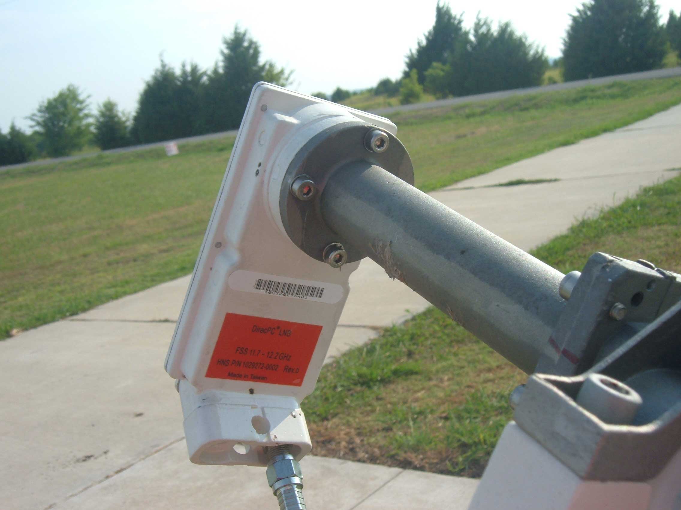

Installing the LNB
Installing the LNB is very, very simple. It was simply a matter of removing the 4 machine screws that held on the old one, and bolting on the new LNB (making sure to install the rubber o-ring).
Note: I elected not to use the screws that came with the LNB, and used the 4 machine screws from the original setup. They were stainless steel and very high quality compared to the ones that came with the SNF-041.
Picture is of the Dish with the SNF-041 installed.
Replacing the Shround
Well... that's a complicated issue.
Because of the difference in size the LNB shround does not fit.
See pic.
My original plan was to cut a notch in the shroud to fit around the end of the SNF-041.
However, that would still leave the connector exposed, as it is at the very end.
So, in the end, I decided to seal all connections, and leave it shroudless.
