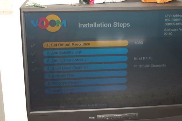

What about component (Y, Pb, Pa) cable? Do they shut this function down also? There’re a lot lines across the TV screen when I used this connection.
Thanks.
Component output should continue to work just fine...mine does on my older component only Mits. Make sure the output on the VOOM receiver matches what your HD set can accept. For example, my Mits accepts 1080i and if the VOOM receiver is set to 720p (or native passthrough and the channels is broadcasting at 720p) then it won't work.
Thanks for your times and the image.
I had a older Sony 27” set (tube). Have to play a little more.
Thanks again.
I have a 35-inch Sanyo in my bedroom that takes only 480 interlaced, so I have to force it to that mode to watch anything. As for my HD screen, I have a Mitsubishi that doesn't take 720P so I have to force it to 1080i.
