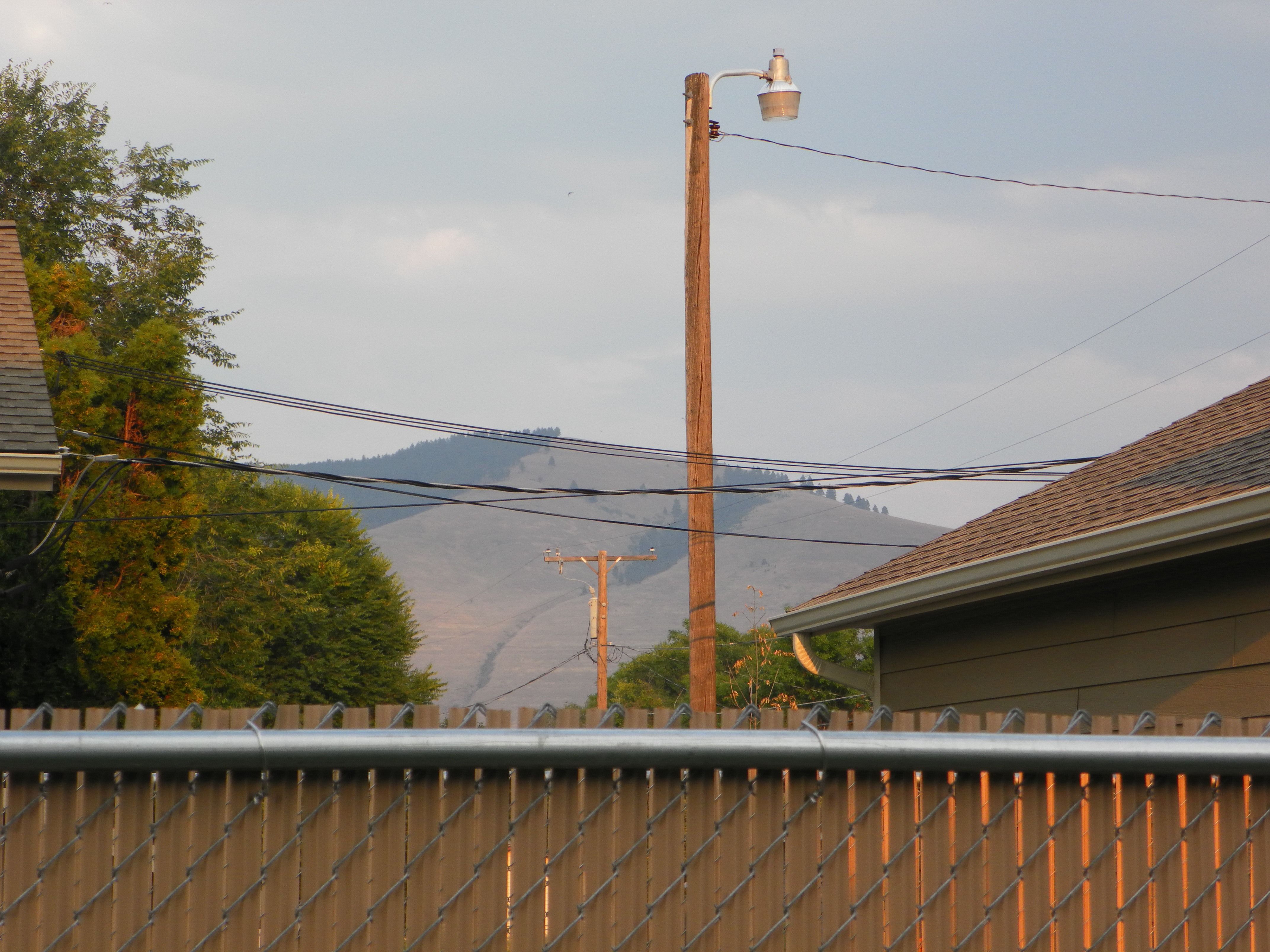

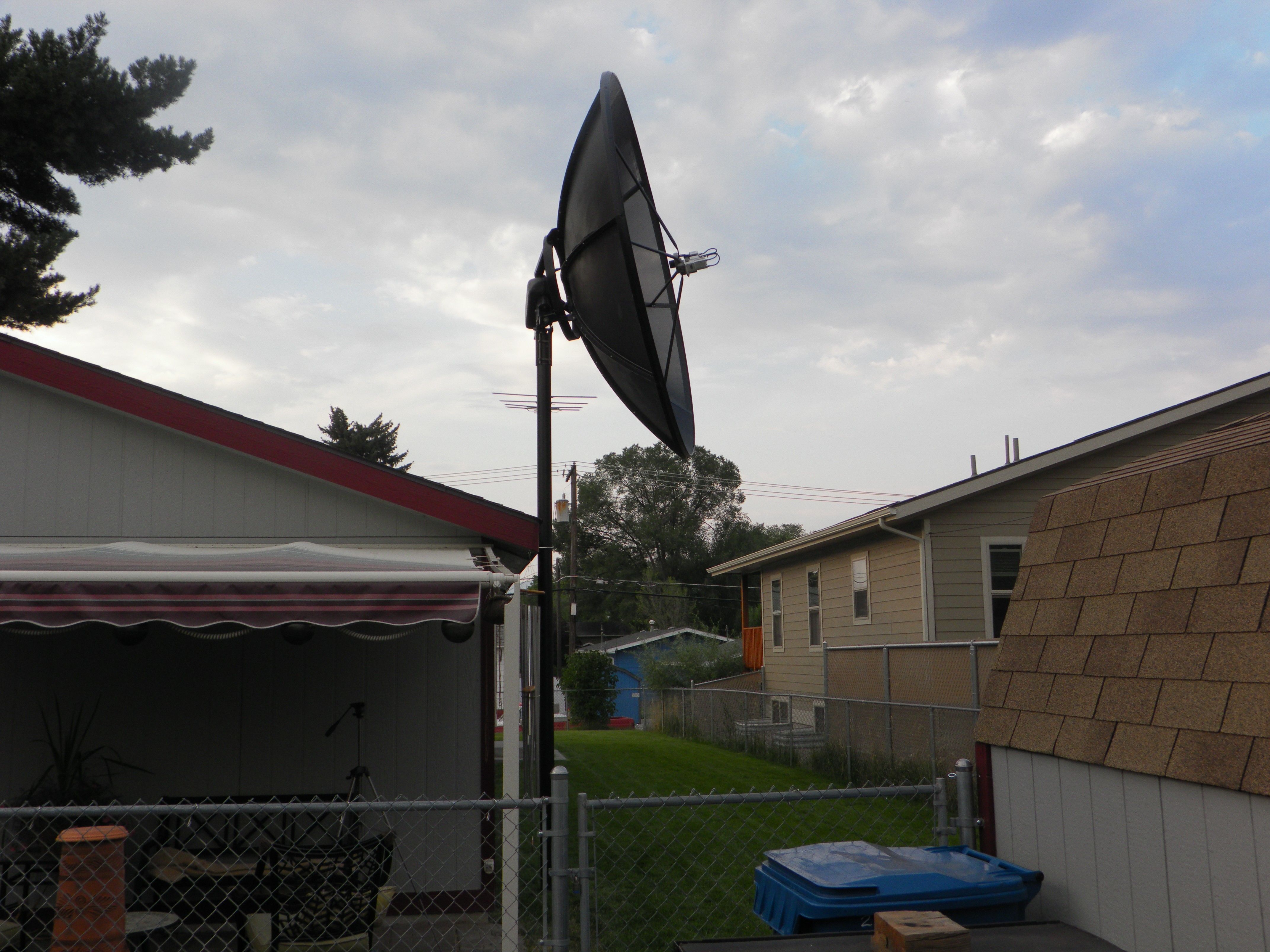

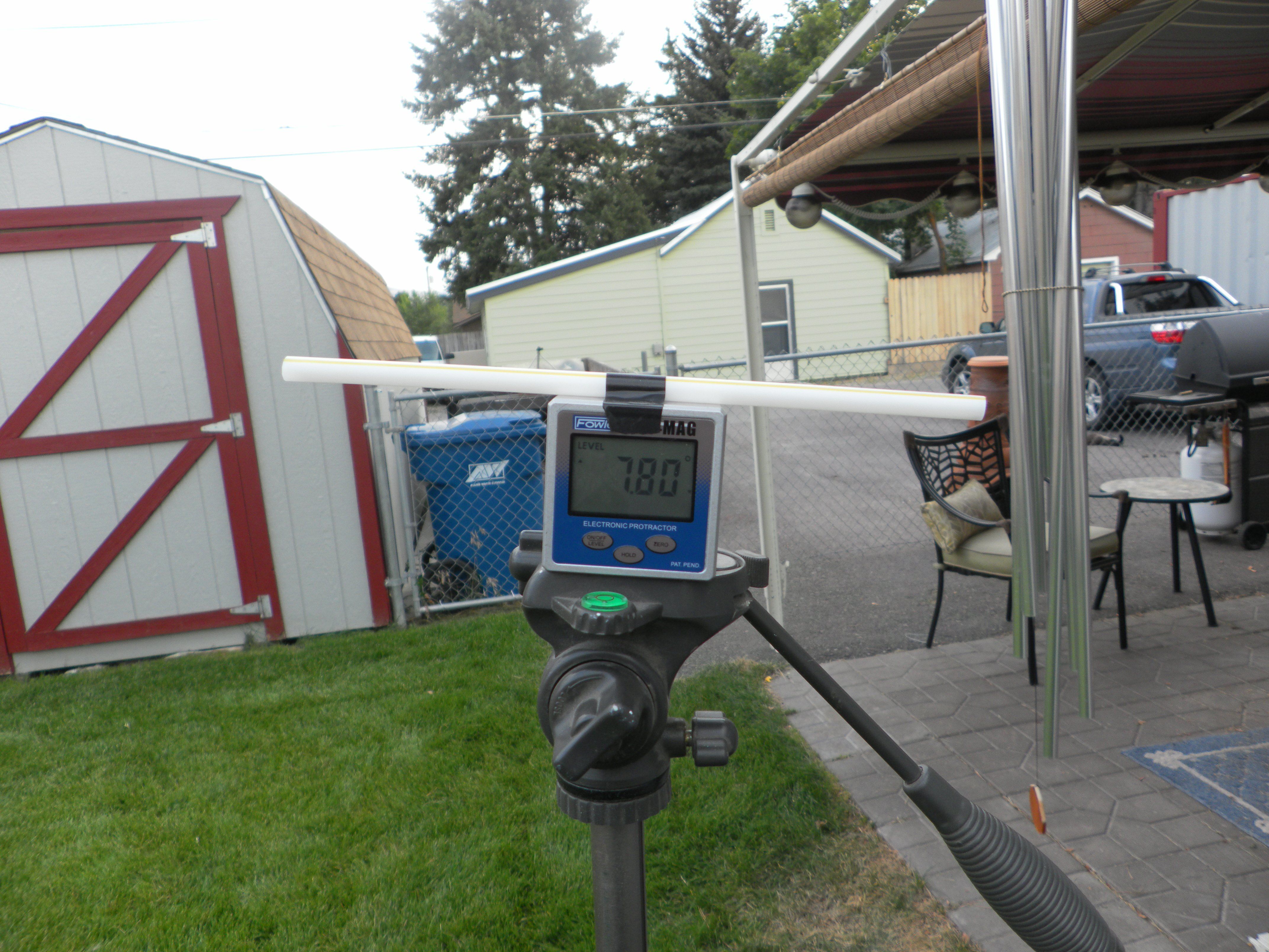

4° wow. I should be able to pick up 50W then. I went and taped a straw to my angle finder and sighted the top of the mountain. From the ground I get 7.8° to the mountain top.
I think it's right between the light pole and the rooftop on the right, just above the hilltop. It's close.

- - 50.0W is still 8.5° in elevation - - From the ground I get 7.8° to the mountain top
With that mountain at 7.8°, 50W at 8.5, your 'effective' elevation is only, no, less than 1°
Going to the roof isn't, unfortunately, going to get signal from 30W.
(Need HAAT for the mountain and distance to to calculate receiving antenna height, but it's going to be HIGH)
