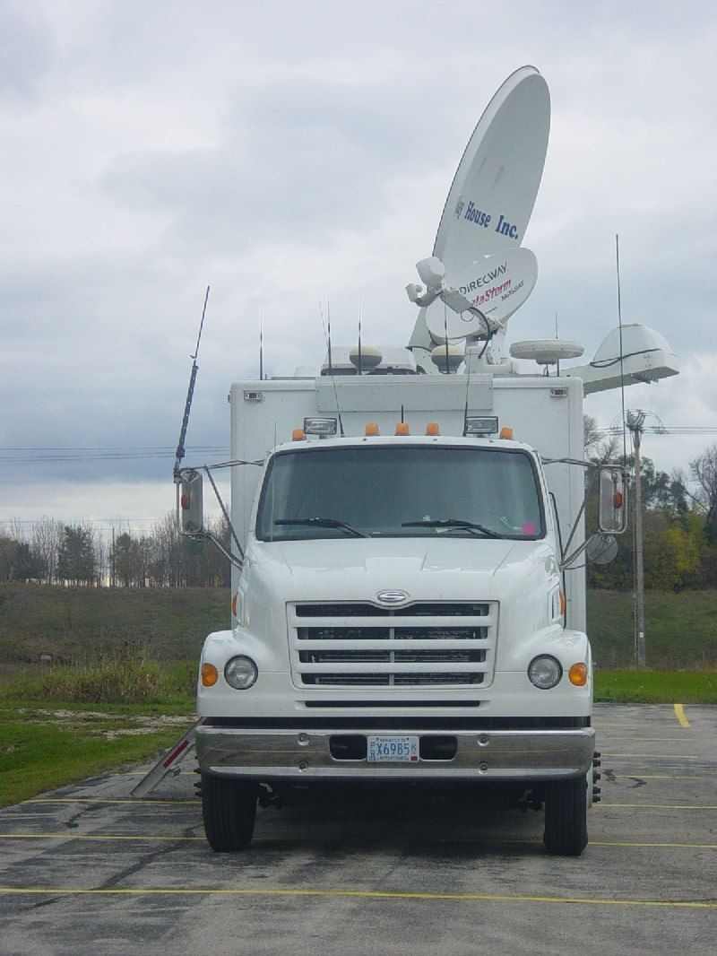

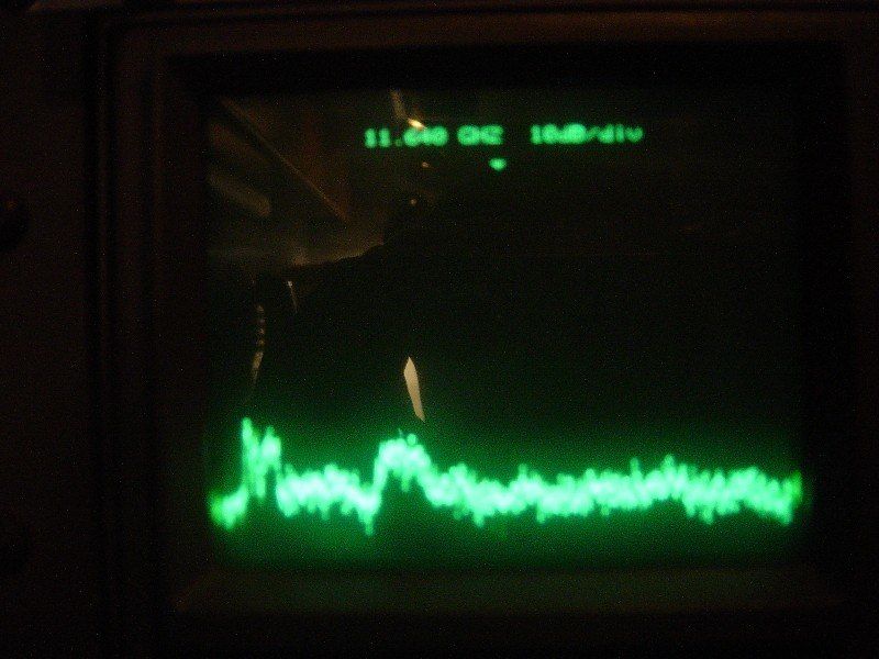

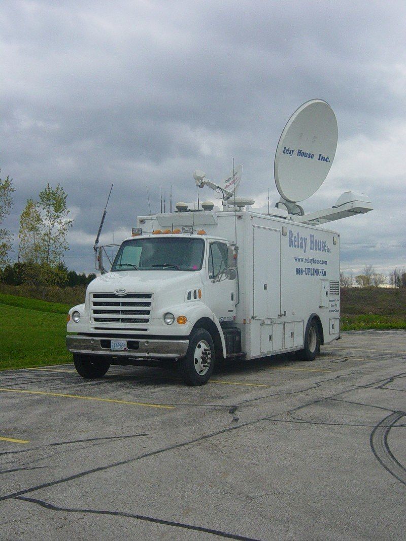

I have hit NSS7 from just north of Chicago. I will post a pic when I get home.
I decided to throw up the dish for a challenge. :)
I am in Port Washington, WI (Just north of Milwaukee)
You get to bring that baby home with you at night?
I'll have to put you on the guest list for my next party. :)
