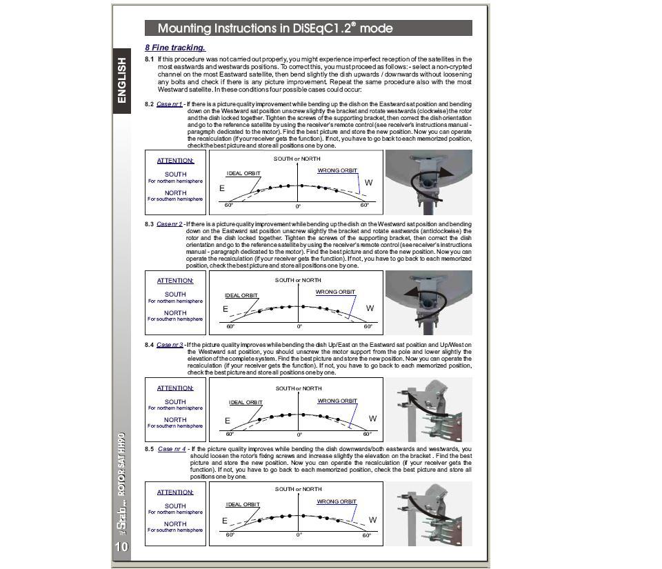

I recently removed my Dish and Motor to fix a seized nut on my HH 120 Stab Motor stainless steel U Bolt. Now that I have reassembled everything I am receiving all Midrange and West Satellites okay, but I find when driving over to a Far East Sat: 74.0W for ONN, if I temporarily grasp the Top of the Dish and Push it Down, I can improve Q signal level from 10 to 25% to up as high as 50%!!
I've been reading an excellent 16 page paper from this great site called: "Adjusting the Polar Mount for Prime Focus Antenna" and I believe it says that if you are out on the far East Sats and you push down, then you are instructed to move the East to West travel of the Motor - AWAY from the TOP of the ARC! But this does NOT seem to help much. In fact it seemed to throw off my True South Satellite settings for 97.0W. Does this mean I have to adjust for ELEVATION on the far East Sats?? Or is this excellent Paper only for 10 Foot Dishes C Band Dishes and maybe does not apply for 1 meter Fortec Star Ku Band Dishes??
Also does all of these rearrangements mean I have to rescan in Each and Every Satellite again as stated in the article? Any replies would be greatly appreciated.
This should help.

Thanks for the info jerryt. So does this mean that I have to delete, then store each Satellite again while going thru this process??
