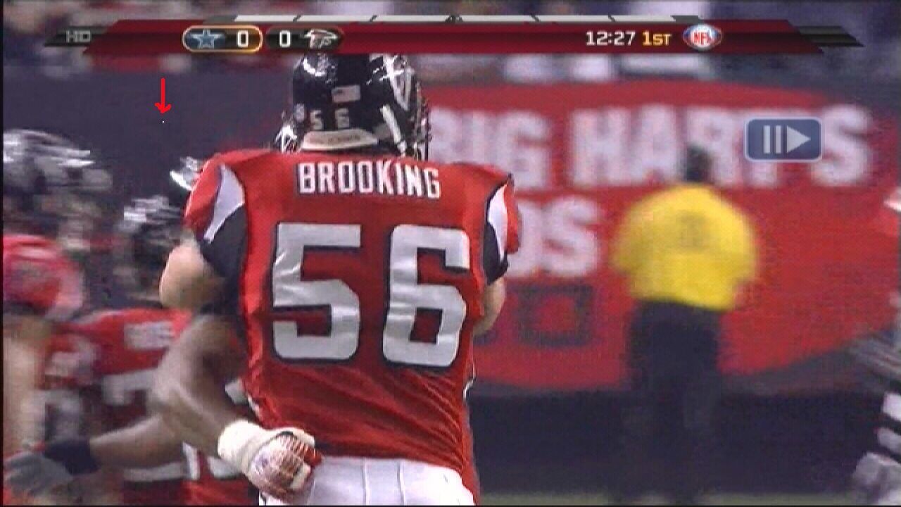

I've noticed that on the NFL Network games, they have a field level camera that has a hot pixel on it, in the top left quadrant. You only see if they switch to that camera, usually between plays. Here's a screen grab. How cheap are these guys? Of course what would you expect from a "network" that can't spare a few extra bucks for the halftime show to have HD cameras?

I worked on the game last night as a video op for the pre and post game.Got home at 3:30 am.We started setting up for the game on Thursday morning.lots of work went into that production.Also,alot of money.They treated us well with plenty of catered meals and snacks.They are going through growing pains just like every new network does.I worked Fox games as the main video op. in their early years and went through the same issues. The game truck last night was a Game Creek truck.I believe some of the cameras were rentals.(they had 23,I think)Stuck pixels happen.You can count on at least one camera on every truck to have a camera with some stuck pixels.You can't blame NFL Network for that.My truck for the pre and post game show(a NEP digital SD truck) had a camera with several stuck pixels.It has been my expiereance that it happens more on Sony cameras then others.

They are not "HD suppliers".They are remote television production companies.To name a few: NMT,NEP, MTVG,GameCreek,Crosscreek,F&F,Jefferson Pilot (now Lincoln Finacial Sports),Turner Broadcasting,etc,etc.Some trucks are HD,some SD Digital,some SD.

First of all,I'm not a camera operator.I'm a video engineer.Second,we are talking about a stuck pixil in one camera.I've seen stuck pixels on CBS,FOX,NBC, etc,etc.. Like I said,the NFL Network is what it is right now.They are going through growing pains.As far as quality,I don't know if you are referring to video quality or the quality of the production as a whole.As for the video quality,it was first rate leaving the truck.After that,whatever compression is used by satilite or cable providers is not our problem.That has a direct effect on the video quality you see on your set.(micro blocking,pixilation) As for the production quality,ie, the talent,graphics,the overall look,that's not my concern.That's the producer and directors and the guys above thems job. Hope this clears up some things for you.
HD cameras can have stuck pixels just like any CCD non-hd camera. And there is always someway for service (maintenance) to re-map these to cover them up. Nothing the operators or on-site tech's can handle, but something that should be back at the shop. It should not go on week after week. This is usually remapped as, even on a cheap ENG camera, the CCD assembly costs almost as much as the camera, minus the lens.
You are mostly correct.With the Sony's, if I run it through 5 or 6 black balances,sometimes that will fix a stuck pixil.If that doesn't work,I'll show it to the EIC so he's aware of it.That's all I can do.So many of these trucks rarely see the shop.They are that busy.And yes,sending it back to the manufacturer or replaceing the optical block or ccd is big bucks.
