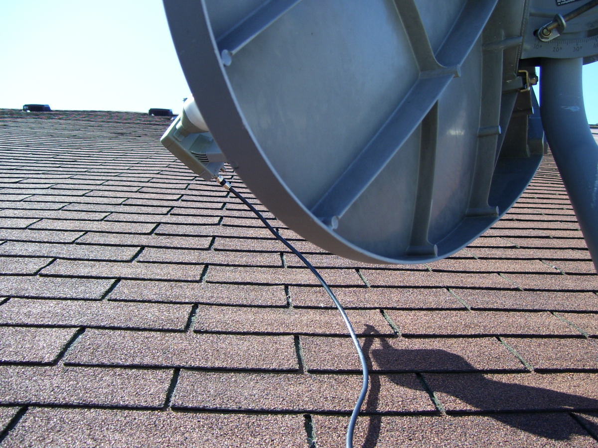

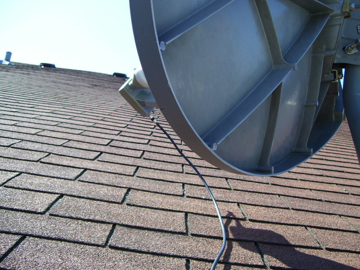

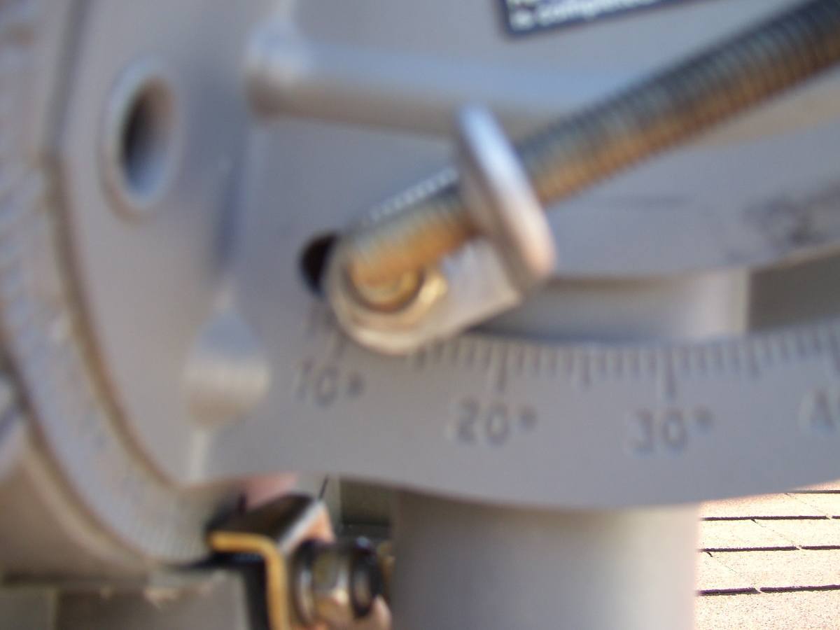

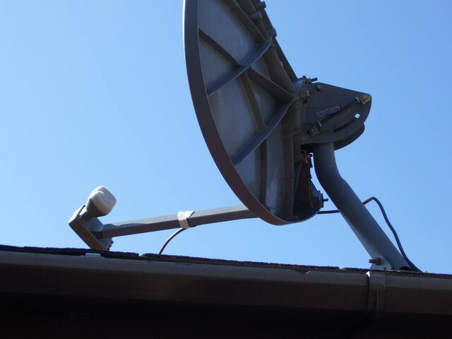

works fine father west than you. I'm in Minneapolis
very low elevation here (8 or so)

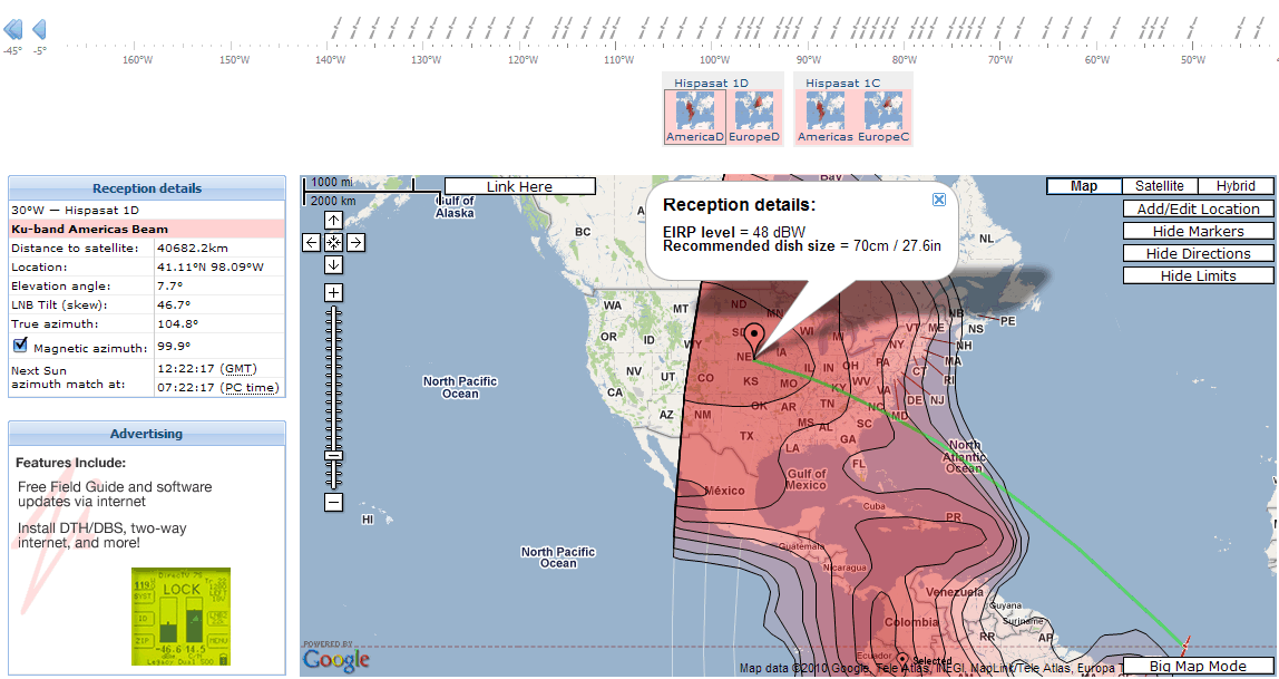

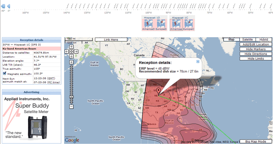

Hispasat 30.0°W is a fairly decent strength satellite for me here in the Omaha, Nebraska USA area. If I used a fixed point dish, my elevation angle would be 8.84°, so it is low, but not bad. I thought you might like some readings for comparison.
I am able to receive the following TPs with the AZBox Premium (using a 1.2M dish and an Invacom QPH-031 LNBF) with signal quality shown:
11884 V 27500 64%
11909 V 7200 61% <- DVB-S2/8PSK
11930 V 2220 37%
11940 V 7500 66%
12052 V 27500 66%
12132 H 27500 69%
12139 V 3030 39%
12142 V 3255 40%
12146 V 4200 54%
12156 V 2222 64%
12159 V 2348 48%
12162 V 3030 31% <- Barely holding on.
12169 V 5240 36%
12172 H 27500 67%
12173 V 2222 43%

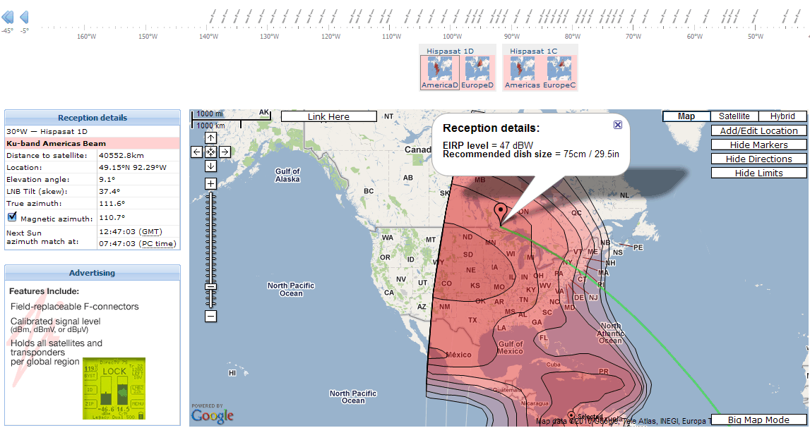

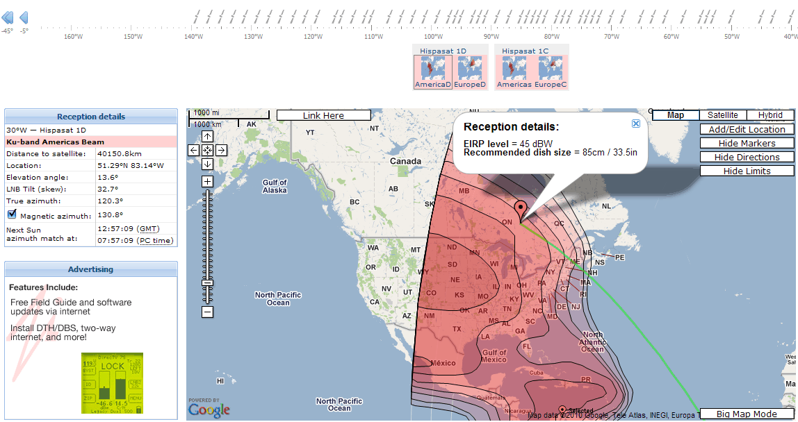

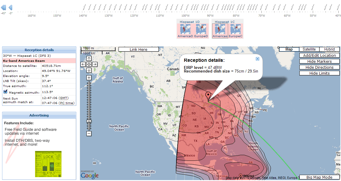

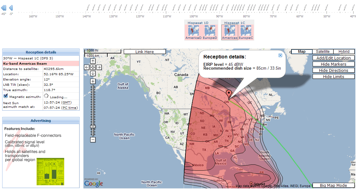

I attached some of the SatBeams footprints for Hispasat Ku. 1C and 1D are almost identical, but I included both.
