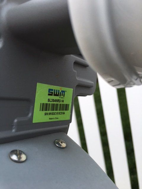

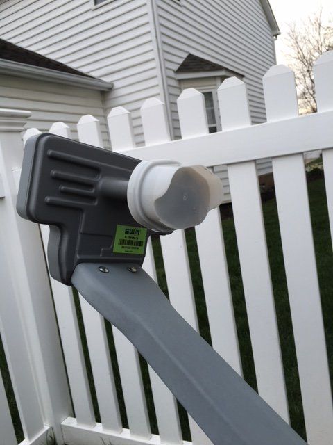

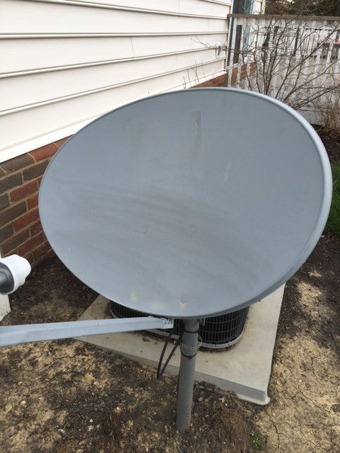

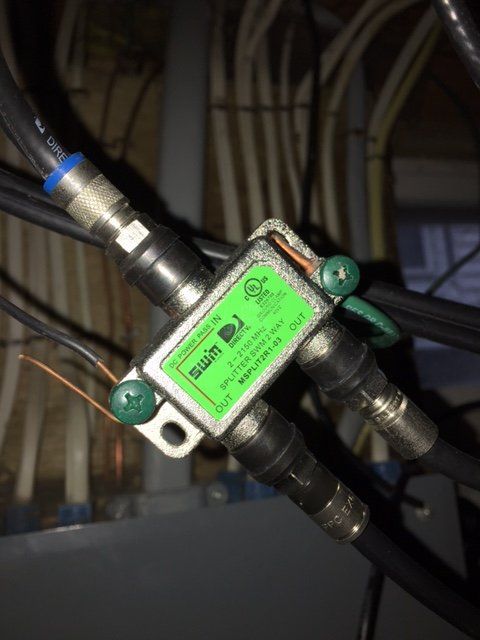

I had ATT Uverse cable and internet which was ran through the brains of the operation, the Residential Gateway. I am sure you guys are familiar with it. In OCT '15 as my promotions dropped off, and ATT acquired Directv, the reps offered me a good deal to leave Uverse cable and go with satellite. I still kept ATT internet(18megs). I was fine changing as we had Directv 8 or so years ago. The tech came out in Oct. He was a young kid, originally with Directv, and was pissed at the world that ATT recently stripped all the Direct logos off his truck and recently started wrapping it in the ATT stuff. He was new with the company and I could tell he didn't know much and was just mad at the transition and was on his way out. Anyways, I still had the dish in the backyard but it was crooked because over the years it had settled. It still had the four(i think) coax lines running from the dish if that tells you anything, i think a 5 LNB..He changed that out to a SL-3(pic attached) and now I think I have only 1 line running into the house. He was very angry he had to fix the dish. Guess he was having a rough day. That was all the "updates" to the outside equipment from what I remember. Once inside we went to living room where our main 60'' LCD is(the one that is going to be upgrade to a 4K). The Uverse RG and Uverse receiver were in that room with the Residential gateway hooked up to the coax line coming out of the wall(its RG6 i think). He unhooked the RG and the kid went to set up the HR44 receiver and said that I couldn't have the RG there, something about not enough coax lines or something like that. I didn't know any better. The HR44 is hooked via HDMI into my Denon AVR(which is also getting upgraded to a 4k AVR)and then another HDMI(ran through the wall into the back of the TV hung on the wall). Then he took the ATT RG down in the basement where he set up more Directv equipment(see pics) I realize the pics have a lot of wires going on but thats what happens when a few companies have laid their footprint in our home..lol But i tried to take pics of the wires that I know are ran into some directv equipment. I am sure you techies will know what is what...Obviously whatever he did in the basement, he ran some of directs equipment into the ATT RG. Lastly he installed 3 other wireless genies(C41) in other rooms of the house. Thursday I am having the ATT internet cancelled(it sucks) and having cable broadband (60 megs) installed.

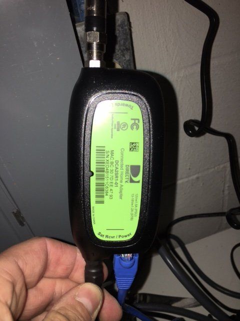

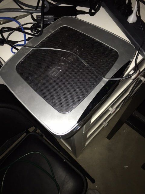

1.) Why did he have to move my internet down in the basement. Is there anyway to get the internet back upstairs in the main living room by the TV/AV equipment. My understanding is I may need an ethernet port or something for the C61 client to be connected to new TV when I get it.(prob new Vizio P65). Could he not split that RG6 line that is in the living room..(sorry if thats a bad idea but just wondering).

4.) When the cable guy comes to install the internet on Thurs, is there anyway i can get the modem(ASIA 6141) and router (APPLE time capsule) back upstairs into the living room.?

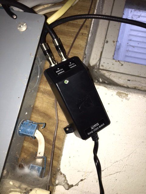

1) not sure how the modem you had at the time works, but since you're switching to cable the guy did you a favor. with D* you cannot have more than once service on the coax at once (this is not absolute, but the exceptions are too hard to explain ATM). if your services were being fed from the coax and you only have one coax line to the back of your living room TV, then you cant have both up at the living room TV. since your switching to cable, you can ask the cable installer if its possible to put it back up there, but he will have to run a new line and drill a hole (that hole will likely be through the floor). unless you're having bad wifi issues, it wouldn't worry about it too much.

3) since your dish is on the ground, and you don't mind buying the LNB on your own at a later date, proceeding at this stage would not be a terrible thing. i don't know how much people are paying for the LNB, but otherwise installation is pretty simple if you just have the genie and clients.
