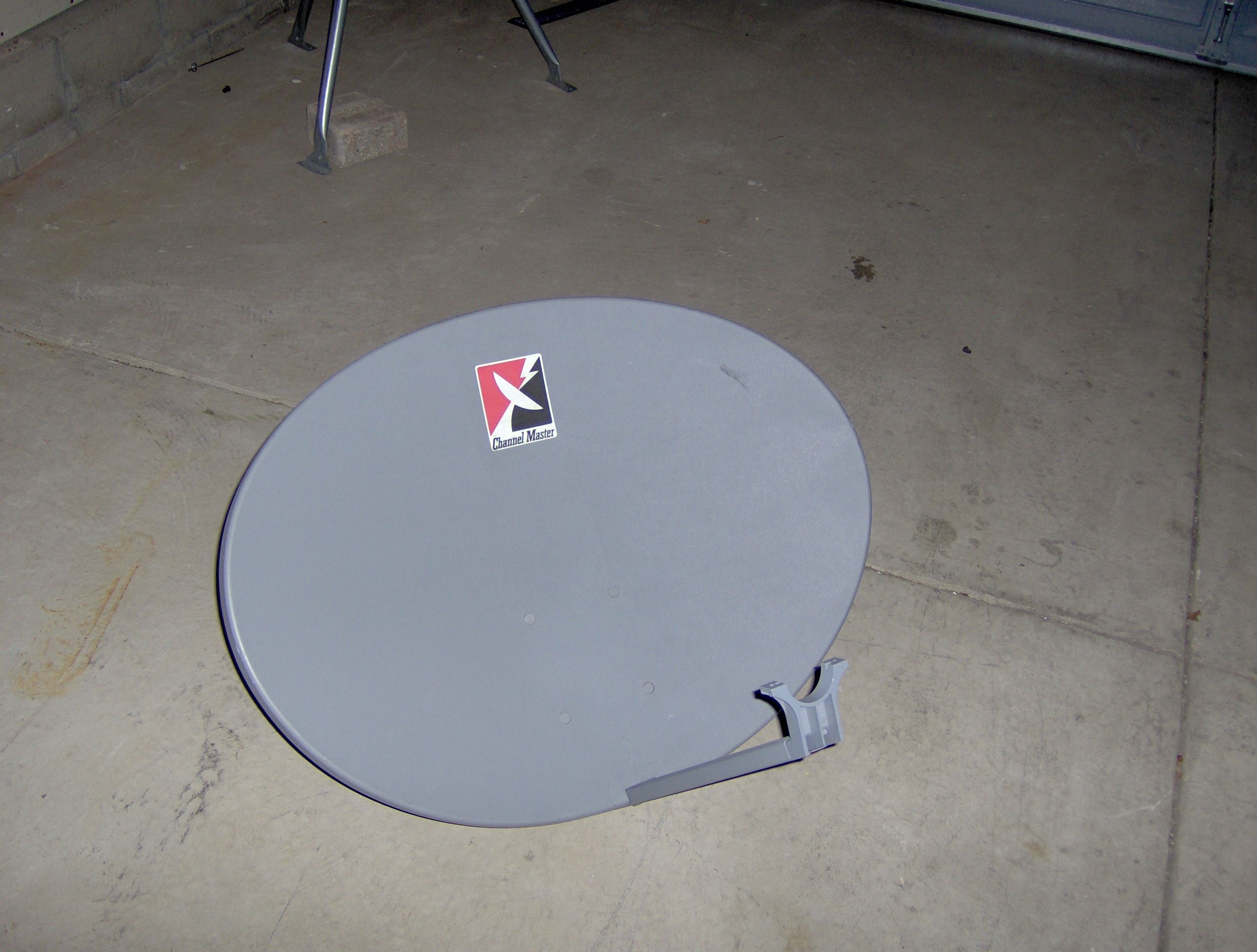

I have a Channel master 76cm eliptical dish that I have laying around that I'd like to find a good use for. Measurements are about 26 in height and 36 in width. Lnb arm is about 16 in in length. I already have a Fortec 80cm dish with a sm3d12 motor in use. Would this dish be better than the fortec I have (would require a new motor)? Only thing I can think of is for a secondary sat (stationary) on a select sat (may be able to get two at one set location ??) but that won't matter until I get a new DVB card.
What about for a location that my motor can't hit (23W<motor<143W) would it be good to hit telstar 12 (15W) or would hit need to be larger?
What about the microbud project? Would it work for C-Band?

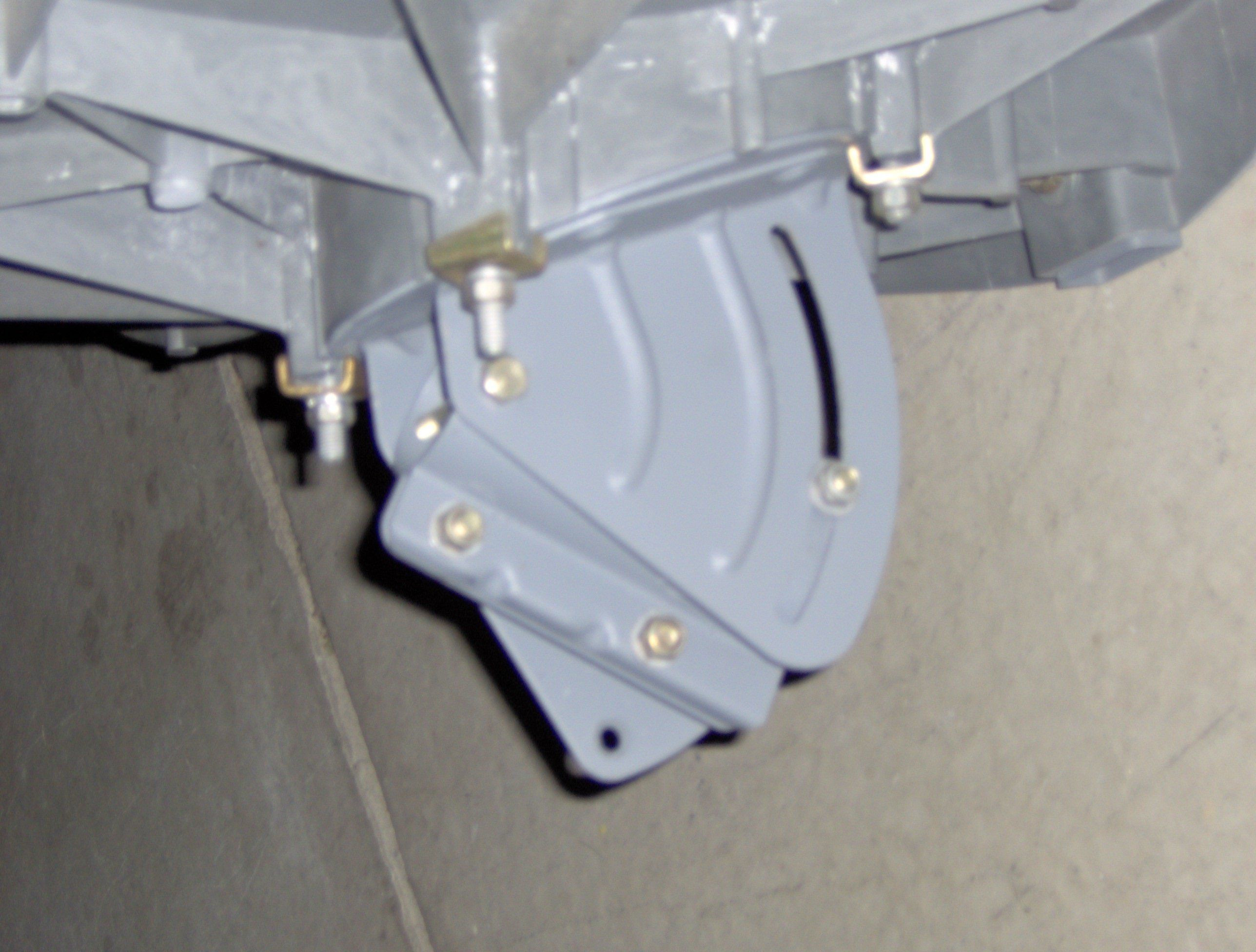

I've uploaded some pics. If anyone has any ideas, please respond.
Thanks!!

looks just like a Primestar dish :)
You could pretty much do anything you desribed above :)

This dish looks like the GLOBECAST dish we carry with a Channel Master logo. CM actually manufactures the Globecast dish.
It is a good dish and should work fine for KU band signal. Not big enough for C-band or microBUD.
but will I see a difference in signal strength between the two?
A big question since the motor I have now fits the fortec and not the channelmaster. So I guess I am trying to figure out if its worth the hassle
Not really. With oval dishes, what matters is the height of the dish. In your case, this dish is only 26".
I think the Globecast Dish we carry is a little bigger.
