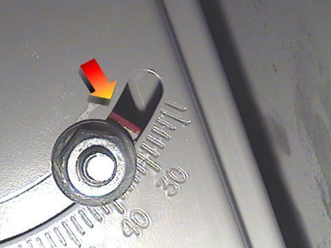

Make sure you have the Dish angle set correctly. There should be little red line on the side of the bolt *TOWARD* the dish to set the dish angle)
(SEE ATTACHMENT PIC Below on my Winegard) Mine is set to 26.

Here is a pic of the SG2100 elevation setting. I couldn't find a pic of the PM900 elevation scale.
Mine is set to 54.
Yours should be 35.4 roughly.
