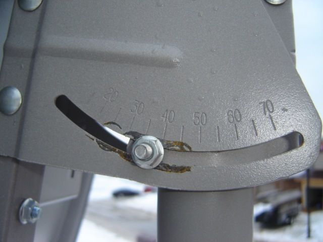

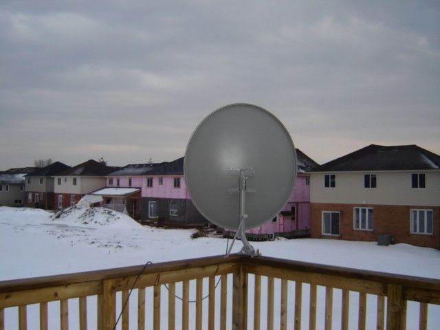

I don't think so I will try attach picture second picture shows elevation for G25 which should be 38 looks like the screw is a marker :rolleyes:

From the back, the dish looks fine, and am not too surprised that the elevation was off (mine was off the other way, had to add 4 degrees to get the correct elevation).

Can you post a photo of the front and side views of your dish and LNB, might be something we can see from that.
