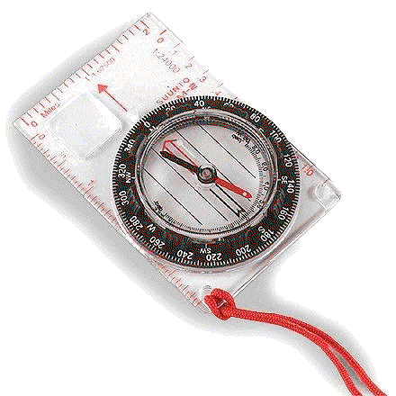

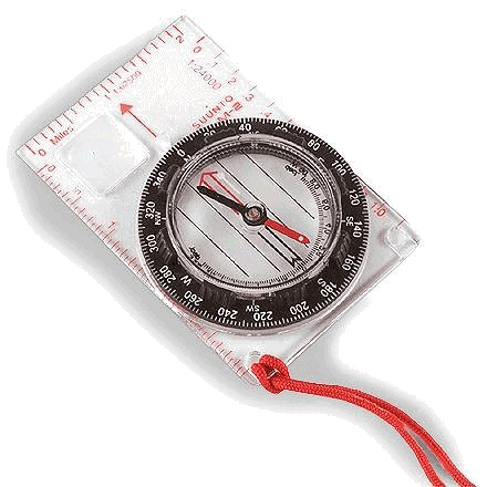

You will need a HEADING compass similar to these two.

still haven't figured it out.
is there a significant difference between a heading compass and a normal compass? because we found a normal compass but couldn't find a heading compass. And we've set the azimuth with the normal compass and there still no signal coming in.
